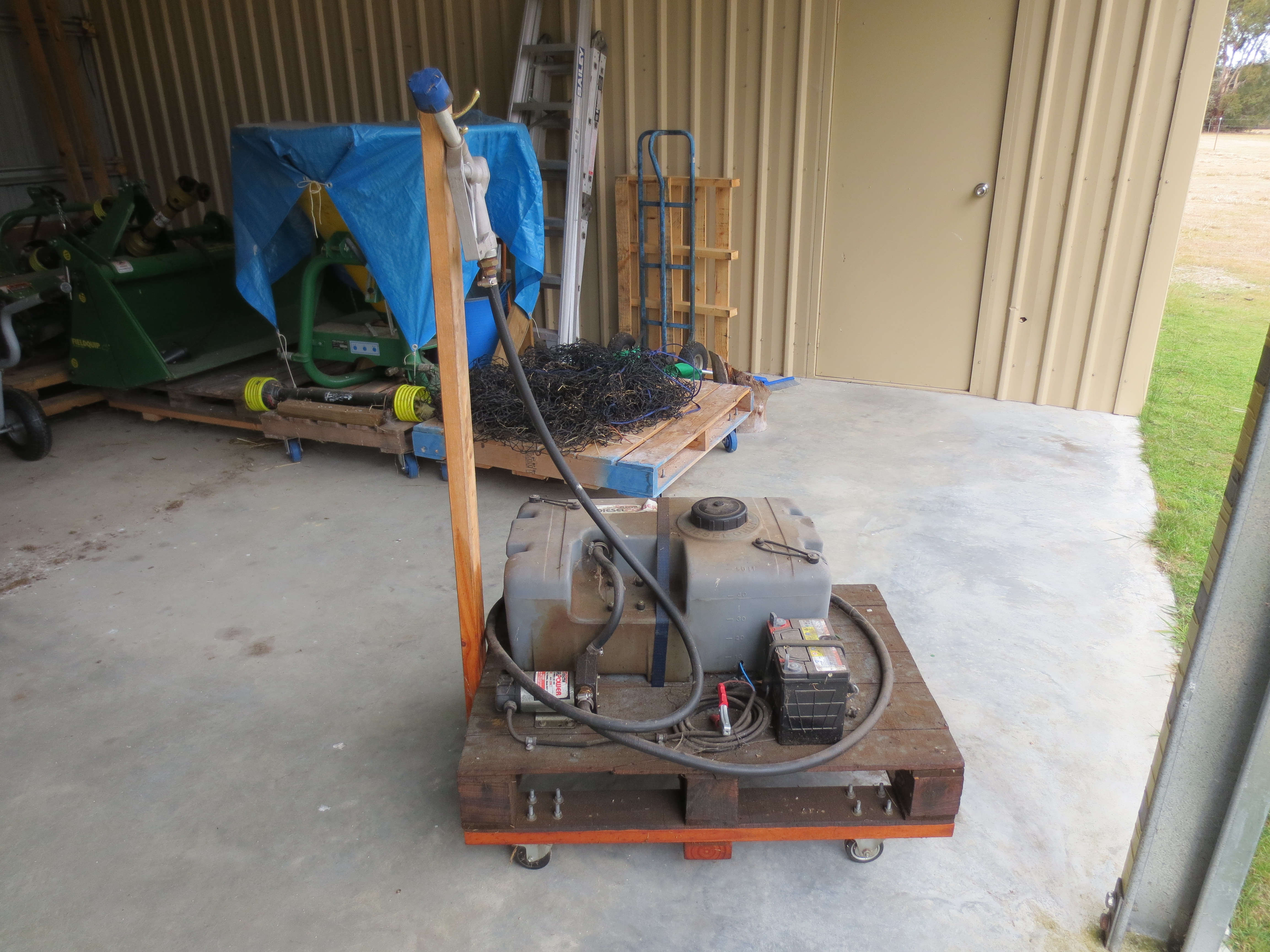

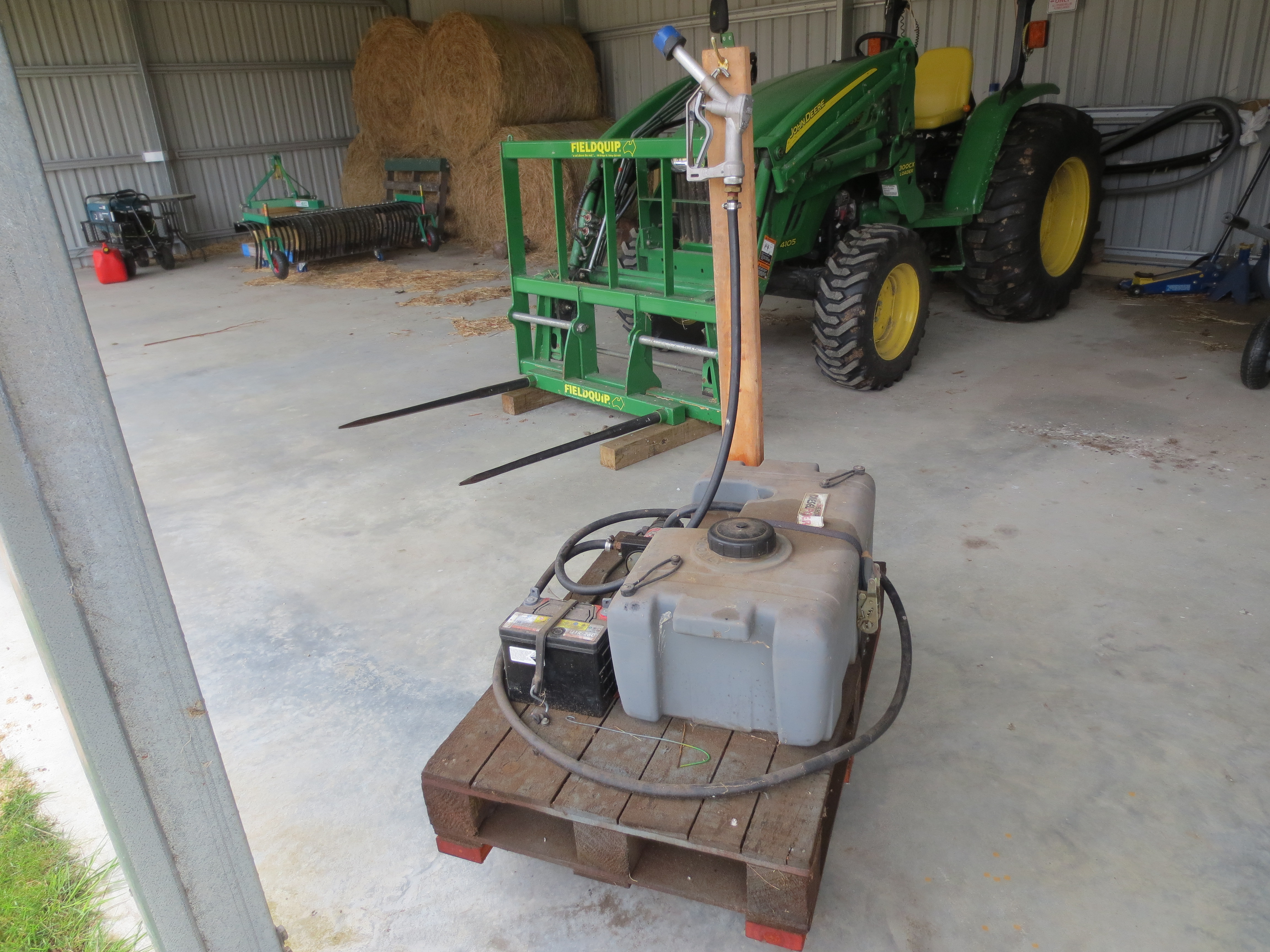

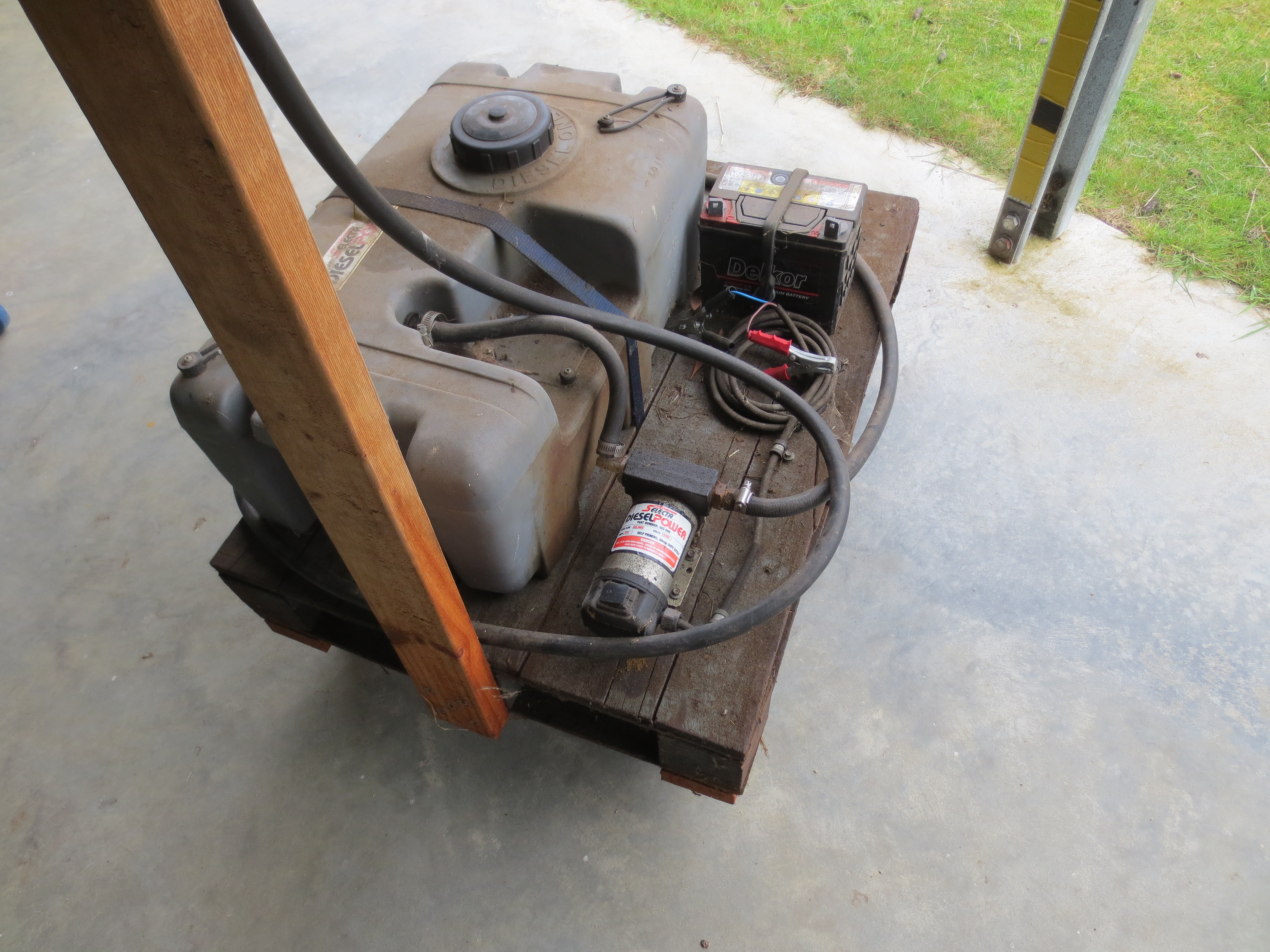

This is my setup, but it's inside a shed so weather protection (housing) isn't required.

Nice. Any idea how many gallons your pumping between charging your battery?
Sorry, no. With just the 4105 to fill, and infrequently at that, I just check an 'indicator' (red/green) window that's incorporated into the top of the battery.
That's also why I went with a 50 litre tank so that diesel isn't sitting around for too long. I do add "Fuel Doctor" (Aussie product) to eliminate any biological growth that may occur.

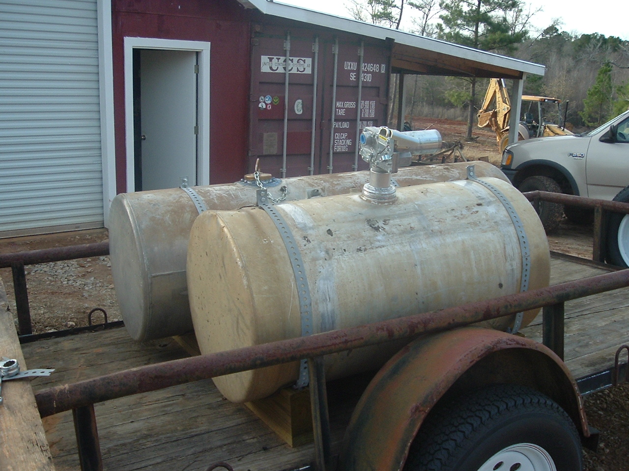

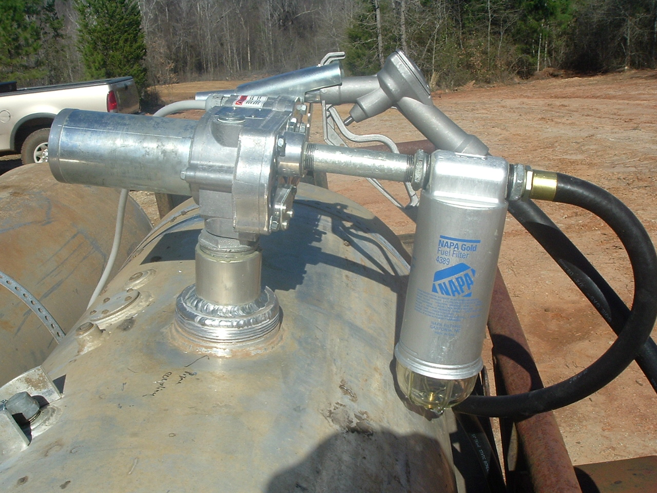

Can you buy off road red diesel there? I save more then .50 cents a gallon buying the red stuff.

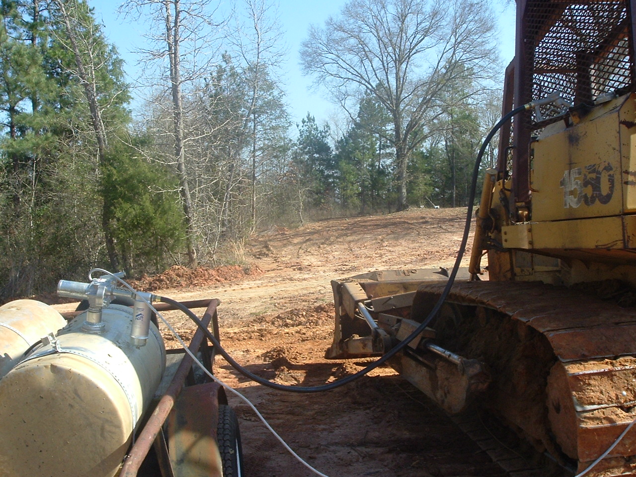

A lot of the time I'll just fill up two 5 gallon yellow diesel cans for my little tractor, but when I'm doing a bigger project and really burning a lot of fuel, I use my fuel trailer with two 100 gallon tanks that I can get 180 gallons into. I put cigarette lighter connections on all my tractors and power the transfer pump from the battery of what I'm fueling up. This way the battery is always charged.
I like that I can move it around my place with my truck or the Mule. Usually it's parked behind my Sea Container, but when I was digging my big pond, I parked it in the middle of the hole so I could fuel up faster.
