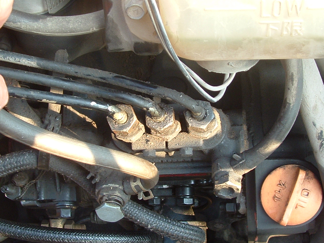

After running my F20D for several hours, I had difficulty starting it again. If I waited till the next morning it would start right up. I changed the fuel filter and it started and died after 5-10 seconds, so I thought I had air in the lines. This morning, I tried clearing the injector lines by loosening the injectors one at a time while cranking the motor to push the air out. First injector seemed to push the air out o.k., but when I opened the second I could not get any fuel to spurt out while cranking the motor. I don't actually remove the injector but rather loosen the nut that holds it in place. Should I completely remove the line while cranking and can the injectors get clogged?
/ Fuel problem

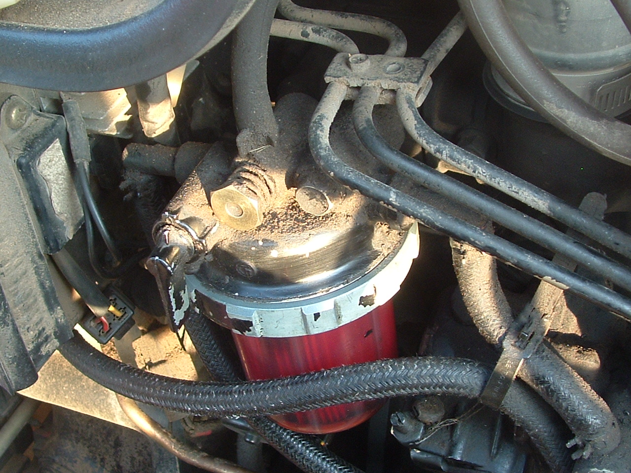

I've attached a couple of pics showing my fuel filter and injectors. The spring loaded "button" above the fuel filter is an air relief, I believe. You may also notice another air relief just below and to the left of the injectors. I'm not sure whether or not the motor has to be running to use these or not. I first open the injector line on the left one, and sequentially open the others as the motor is being cranked trying to expel any air in the system. I can get fuel to come out of the first one but when I open the second or third ones I see no evidence of fuel even after cranking for some time.

/ Fuel problem #4
Dirty fuel tank ?
Some times it takes 10 minutes for the shaking sediment to clog the lines.
I would start at the tank, drain the fuel tank and blow out the lines.
Put fresh fuel in tank, then bleed it at the push buttons that you showed in the pictures.
If that doesn't cure it, move on to plan B

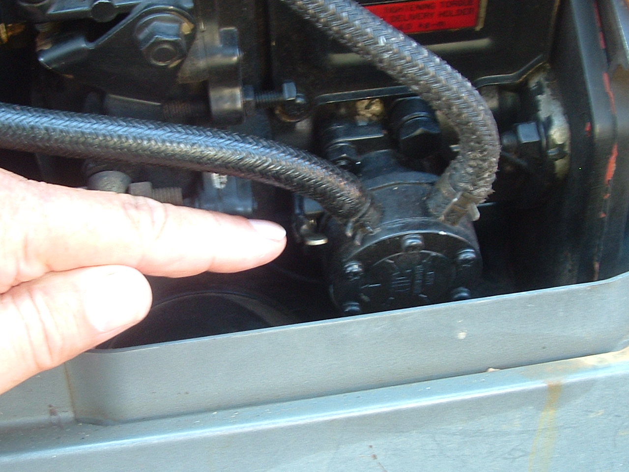

/ Fuel problem
What is this little lever used for? It appears to be some sort of "primer" or pump in the fuel system. When I depress the bleeder button, should I pump this lever?

/ Fuel problem #8
A tall one is a cool drink of H20 :D
Yes that lever is a primer pump.
/ Fuel problem #9
Yes, it manually operates your lift pump.
If the bleeder button is 'down stream' from your lift pump, then yes.
Use the 2 to bleed air from lines between tank and injector pump.
Once your positive no air, crack loose your injector line nuts AT the injectors, not at the pump. Crank engine till fuel arrives at loose nut(s).
I'm a little concerned about the amount of dirt around your filter housing. When you reinstalled your filter, are you positive the gasket and mating surfaces were clean ?
A slight leak at that gasket can suck in air and could cause a loss of prime.

TA-DAAAAAAAAAA!!!!!:D:D:D:D:D:D:D Thanks Ernie et al.
Followed Ernie's instructions and ol Betsey started up this morning. I pulled all of the fuel lines loose and blew them out, changed filter and O ring, emptied the tank and blew it out and then refilled with clean diesel. When I re-connected the lines I did it from the tank to the primer, to the filter where I used the primer thingy to push fuel up to the filter prior to connecting the fuel hose. Once I had fuel there, I connected to the filter..pushed the 1st bleeder button while priming, on down to the second bleeder button and in to the injectors. After I was sure I had no air at that point I loosened each injector nut, one by one, till I could see fuel coming out as I cranked the motor. I could tell by the time I had the air out of the second one that it was going to start. Anyone need about 4 gallons of dirty diesel fuel?
