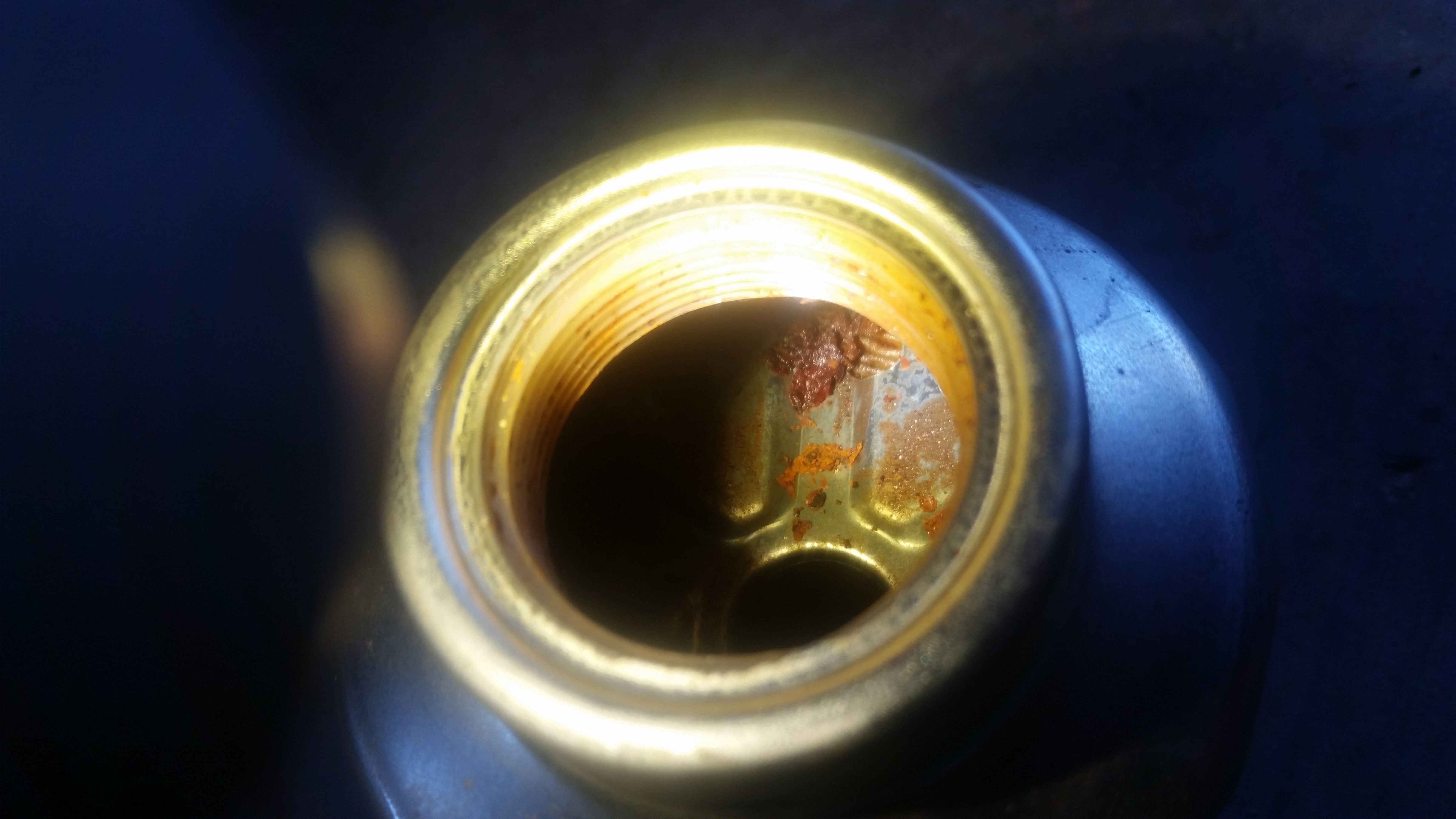

I *might* have found the problem. Last night I found a schematic online for the Zexel pump. It showed a screen at the inlet line. Pulled it this morning. It was pretty well clogged: almost to the point of not being able to see light through it. I blew it out with air (hold tighter next time so I don't lose it across the barn floor!). Reinstalled it, tightened things up, purged the air, and started it up again. Way higher RPM! No surging or "missing". I'll have to go mow a field or something to see if this truly fixed it or not. Keeping my fingers crossed.
Here's a pic inside the bottom of the old fuel filter I took off. Pretty ugly.
Now, as to the red fuel line: that's how it came from the factory. I don't know. If it has deteriorated inside, maybe that's why that small screen was clogged instead of that stuff being caught by the filter? I'll get a new piece today.

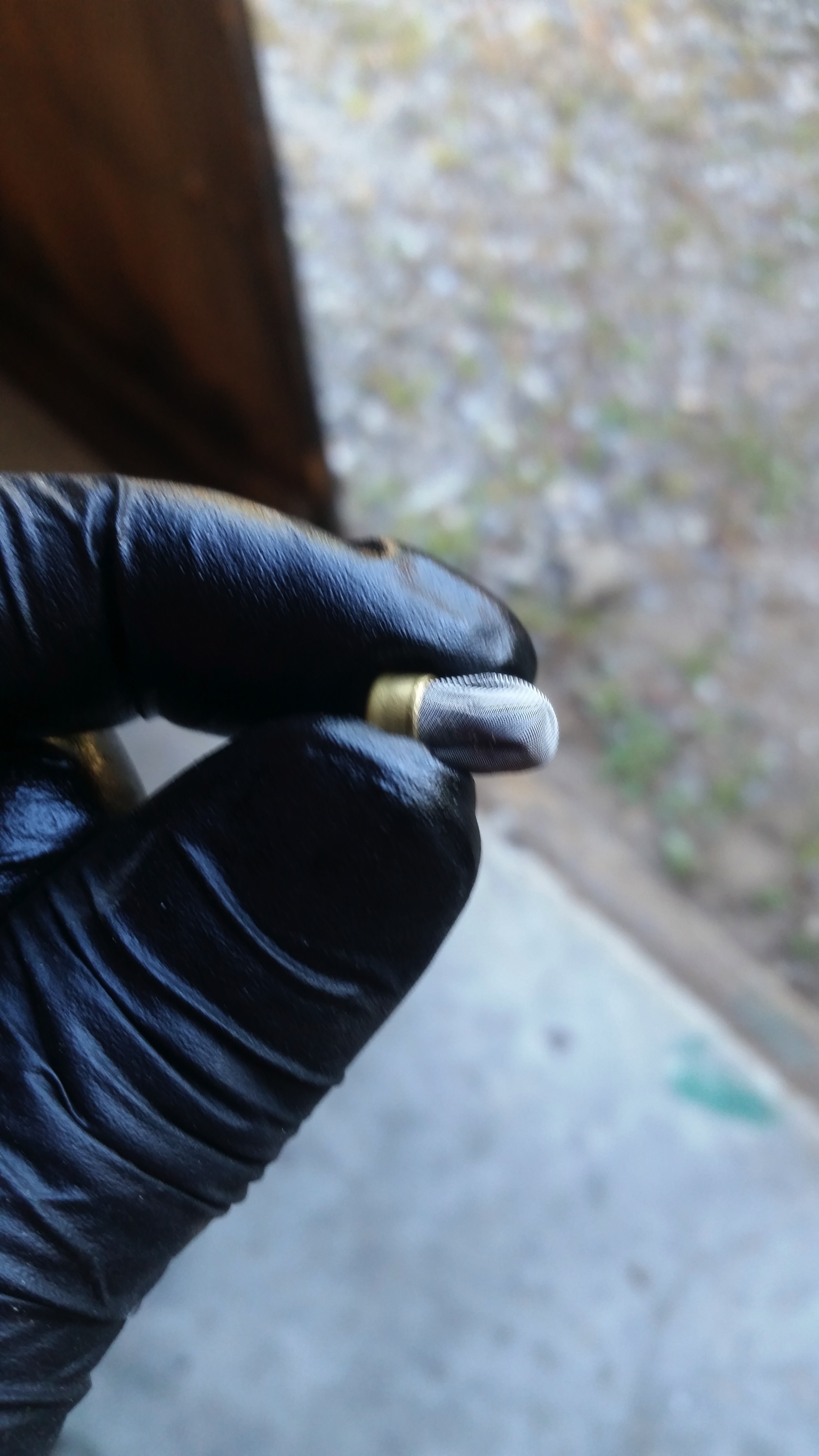

The spring and the filter screen were down in the injector pump housing:
It was a little tricky to get them out. I used a tweezers for the spring and then a wood screw for the filter. Put the screw down inside the filter and pressed it to the side and pulled it out. I'm sure there is a better tool for the job, but it worked.
The filter screen itself is tiny! The size of an eraser head on the end of a pencil. Mine was dirty.
Now it is clean!!
As soon as I got it repaired (it took about 30 minutes start to finish) I disced 5 acres of damp soil and it worked great for the hour and a half that it took me.
