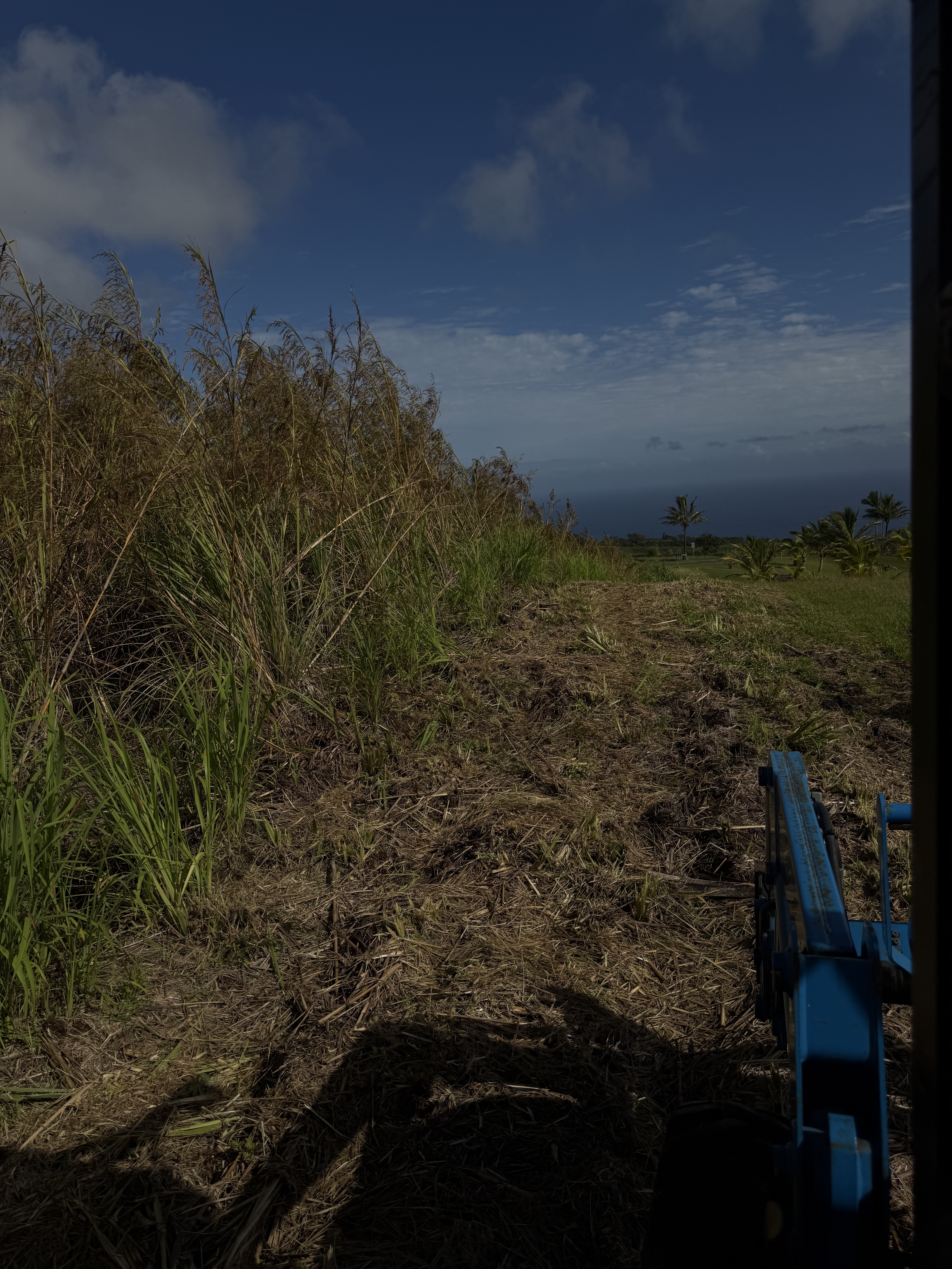

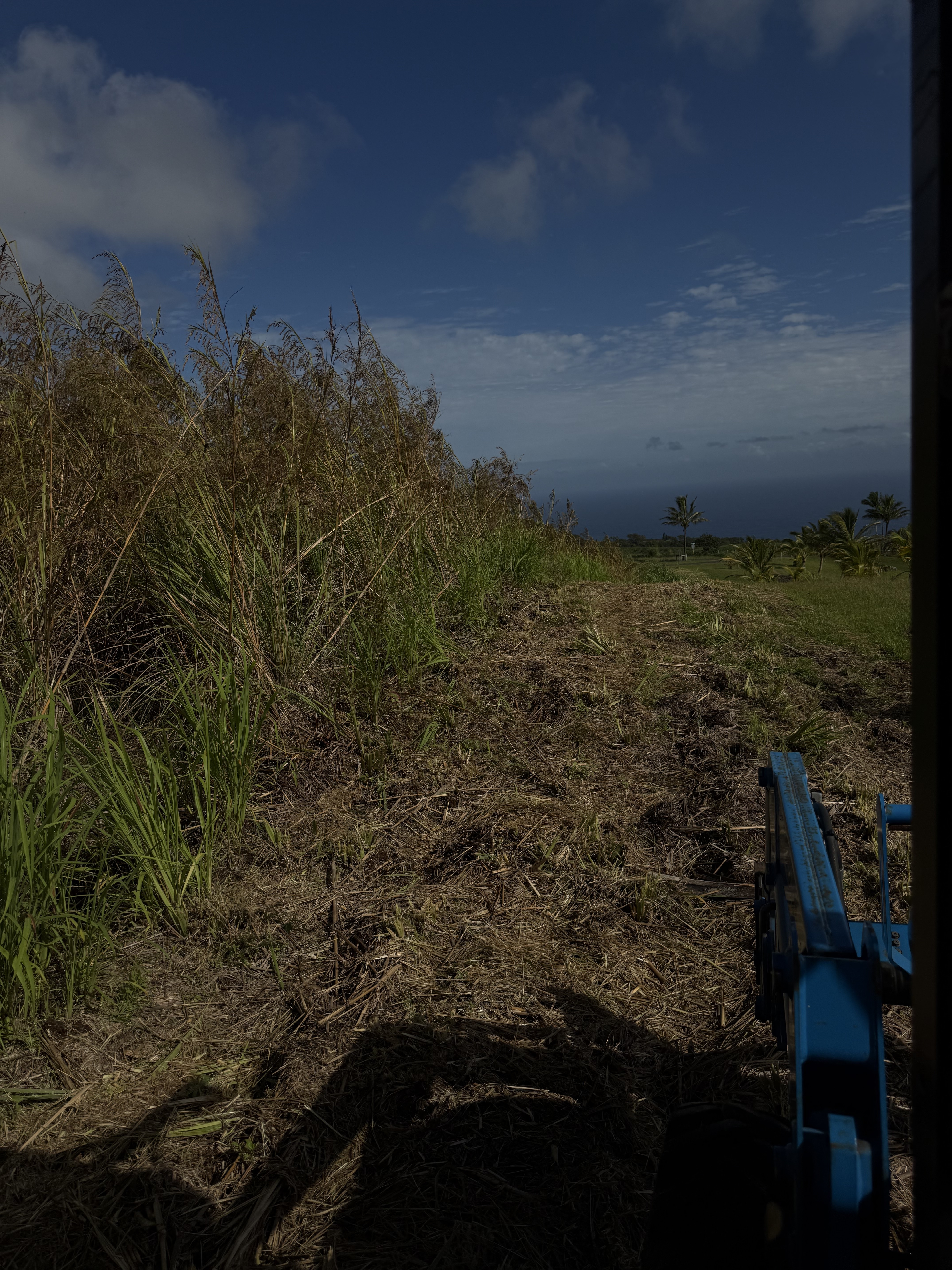

Been awhile, but hopefully finally made some progress.
Tractor back together but only run about 15 min. Then yesterday got to run hard for abit over 2 1/2 hours with the 6 ft rotary mowing some tall, thick, wet stuff in the rain. Pic is one of the easier areas. Didn’t get a pic of the really heavy stuff. We had 1.72 inches rain over night, so much wetter than I like, but a lull tempted me. 5 minutes after I parked back in shed, the sky opened up again.
So what did I do
Removed and cleaned fuel tank as best I could. Not really conducive to to a good cleaning but confident I did good. Although I had purged earlier, it was evident that really wasn’t good enough as the outlet is off the bottom and I could see some debris. This time I washed, flushed, wiped until a micro fiber came back clean.

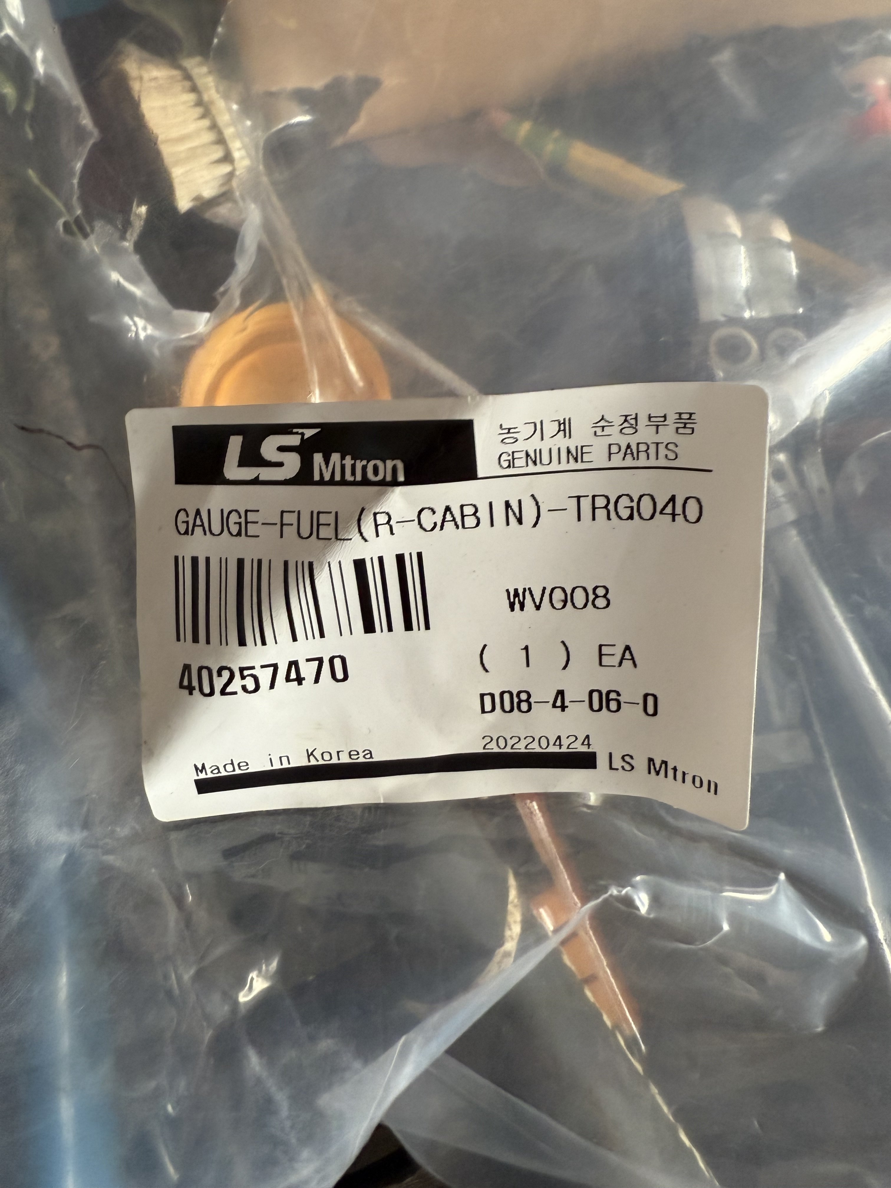

Replaced the fuel sender. Think tech ordered wrong one as it says cabin and I have the ROPS model. Put it in anyway but gauge till reading Empty.
Removed and cleaned the fuel filter assembly but did not attempt to disassemble. This is the part identified as possibly a problem last tech visit. Part has been on back order 6 weeks, tired of waiting. I did leave the inline filter put in by tech, replaced with new.
As recommended here on TBN i replaced the hand throttle.
Once back together put in 5 gal filtered diesel. Started right up.
Not calling this a definitive fix yet, but darn encouraging. Hope to get chance to run for 4+ hour period.
