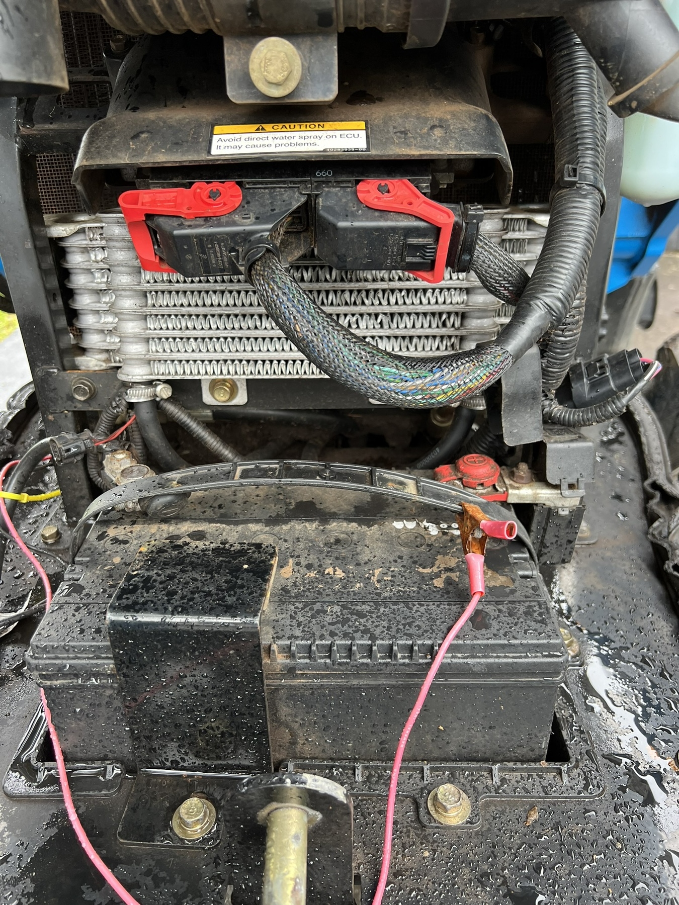

Well, 10 1/2 weeks at dealer and no joy. Tech for a weak ground and reflashed ECU. Never could replicate problem.
Got it back home, and as I suspected, able to experience problem first hour at work. Seems tractor has to be under load to malfunction. Took about 20 restarts to limp back home. Fortunately, my friend Jim is visiting and got to witness first hand, the main reason I want back from dealer even if not fixed. Jim is your ultimate fix it guy for this kind of stuff. So know he and I can brainstorm.
Possibly good news on my LS tractor though.
I ‘ve always viewed as a complex issue, fuel starvation, somehow with a temperature component, leading to electric chaos. Could ECU be suspect? My wallet hoped not and tech reflashed. So with the hood up, Jim and I walked thru. Light bulb moment. What if the ECU was over heating due to its location so near radiator?
View attachment 873118 That could trigger a fuel sensor, it could become progressively more frequent as the temp went up, recovery would improve as temp normalized, and it could trigger electrical weirdness. Sound reasonable? I’m hopeful.

I am more and more convinced it is a temperature issue that is causing ECU to fail, triggering fuel starvation and wonky electrical ad I recently posted.
Plan is today install some sort of 12vdc fan to cool ECU.
