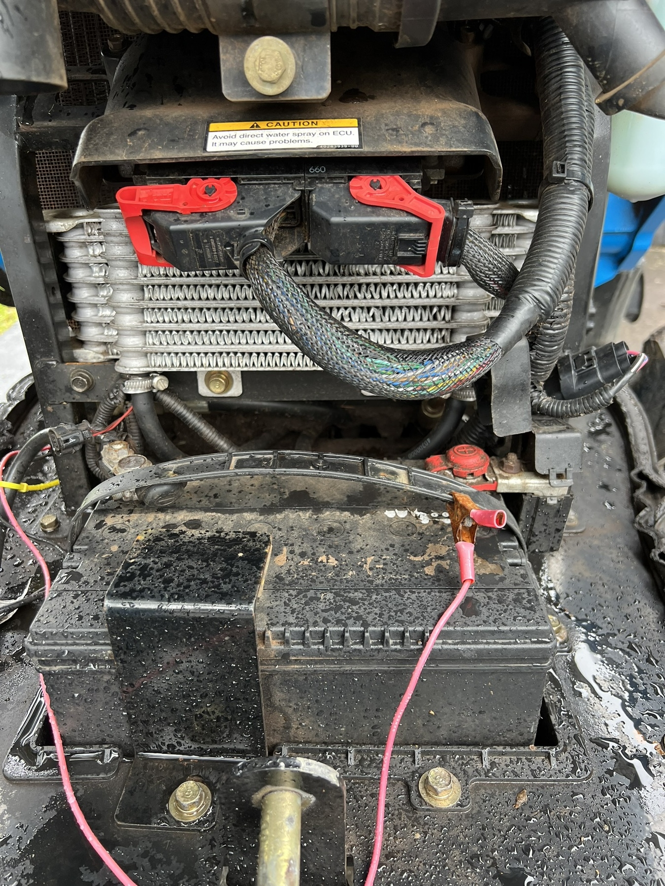

Well, 10 1/2 weeks at dealer and no joy. Tech for a weak ground and reflashed ECU. Never could replicate problem.
Got it back home, and as I suspected, able to experience problem first hour at work. Seems tractor has to be under load to malfunction. Took about 20 restarts to limp back home. Fortunately, my friend Jim is visiting and got to witness first hand, the main reason I want back from dealer even if not fixed. Jim is your ultimate fix it guy for this kind of stuff. So know he and I can brainstorm.
Possibly good news on my LS tractor though.
I ‘ve always viewed as a complex issue, fuel starvation, somehow with a temperature component, leading to electric chaos. Could ECU be suspect? My wallet hoped not and tech reflashed. So with the hood up, Jim and I walked thru. Light bulb moment. What if the ECU was over heating due to its location so near radiator?
View attachment 873118 That could trigger a fuel sensor, it could become progressively more frequent as the temp went up, recovery would improve as temp normalized, and it could trigger electrical weirdness. Sound reasonable? I’m hopeful.

Are you mowing slopes? Wondering if you're sloshing sediment around enough in the tank to affect the pickup?
/ XR4140 stalling
#37
Considered that. And yes slopes, but doesn’t matter which way I’m pointed or on the flat. Would that any sediment was removed when I drained and purged the tank. (and messed up the float).
I am more and more convinced it is a temperature issue that is causing ECU to fail, triggering fuel starvation and wonky electrical ad I recently posted.
Plan is today install some sort of 12vdc fan to cool ECU.
If that fails, I also have plan to install an external fuel tank, bypassing everything before filter. But that is a couple weeks away as I will be living for mainland tomorrow.

Sounds like you may be on to something. You'd think the dealership would have noticed an EGR code. Perhaps not.
/ XR4140 stalling #40
interesting to note that most dealers don't seem to have dyno's to test tractors under load. That is an interesting diagnostic path and at this point it sounds like it is worth exploring before bypassing the fuel tank. I know water and electricals don't usually mix well but perhaps a damp cloth or towel wrapped around the ECU would be an easier test than rigging up a fan. Kubota's have something up with the injectors that sounds a lot like your problem perhaps LS uses the same injectors. I think it applies to M7060 models and there is a tsb that covers the problem.
