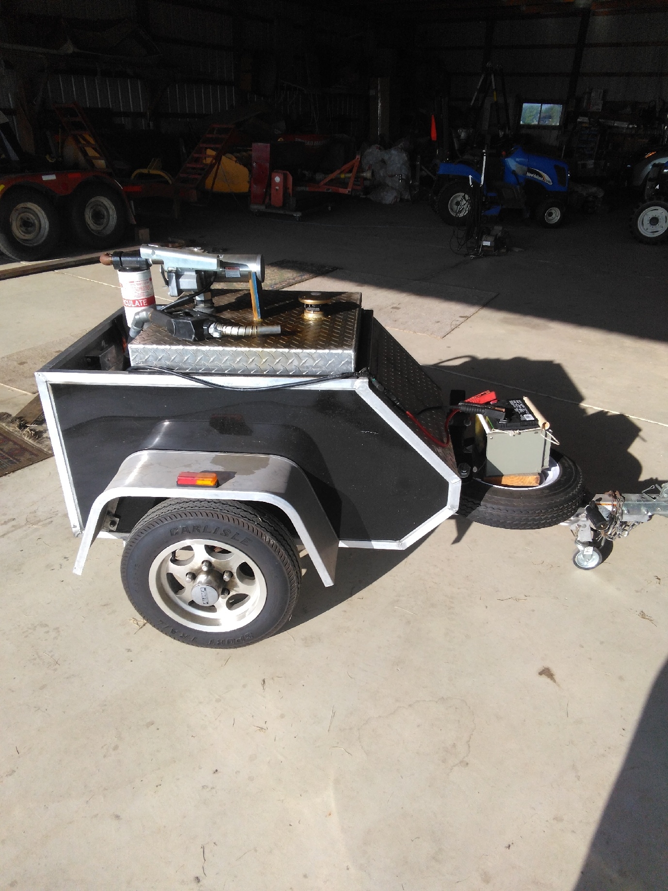

Here is my solution for non-ethanol gas transport. Tank is a 55 gal transport/transfer aluminum tank with 12 volt pump and battery. Trailer was designed to pull behind a motorcycle and has a torsion suspension, 12 inch wheels and an 1 7/8 inch hitch. It has more than paid for itself many times over.

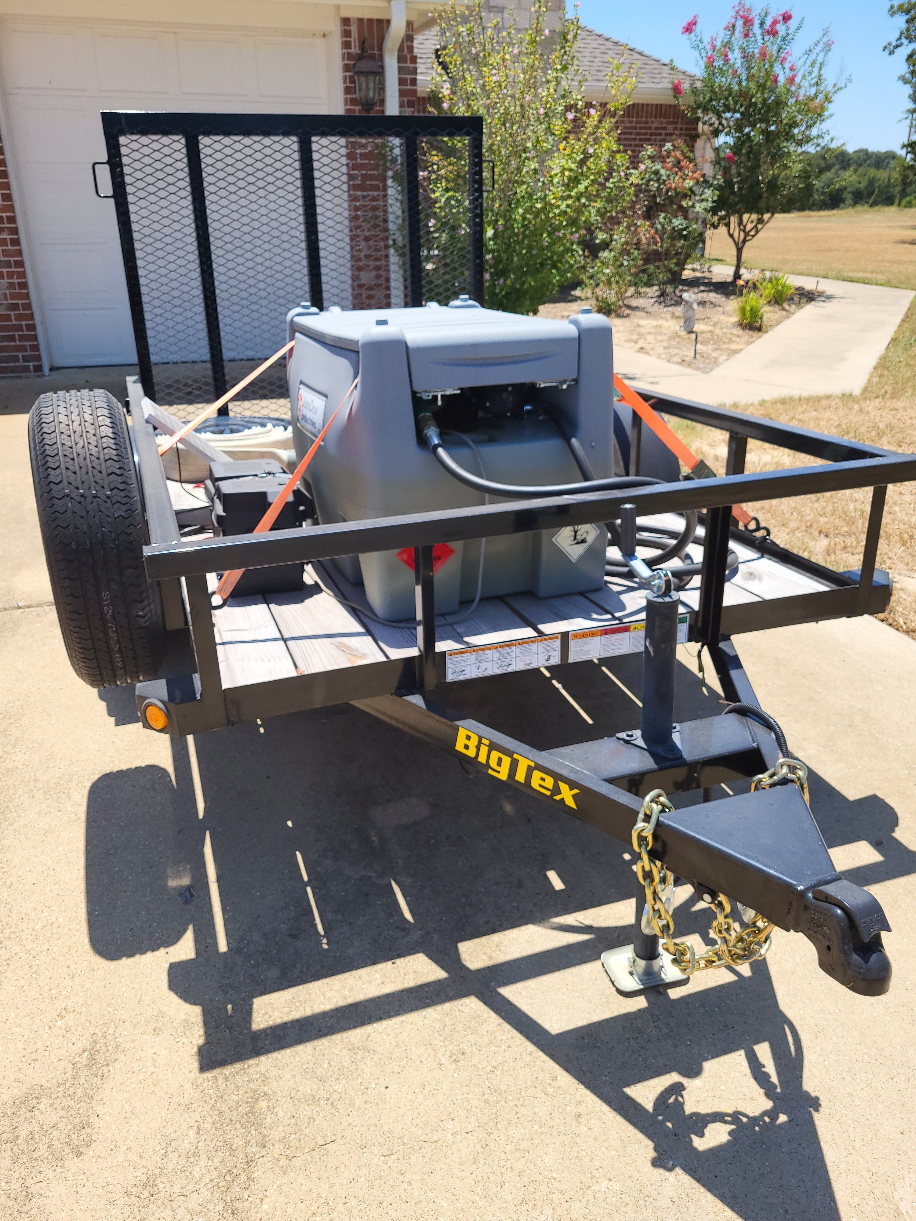

It should work for short trips. I really like my 5'X8' fuel trailer with a John Dow 58-gallon fuel pod, battery, and solar charger. I thought about one like that from Harbor Freight or a TSC trailer, but I wanted bigger tires so I went with another Big Tex with 15" tires. There is enough room at the back so I can use it to haul small stuff like push lawnmowers to the shop. The only thing mounted are the 2 clips for the battery box strap so I could take everything off pretty quick if needed.
Very nice!

My portable fuel tank;
