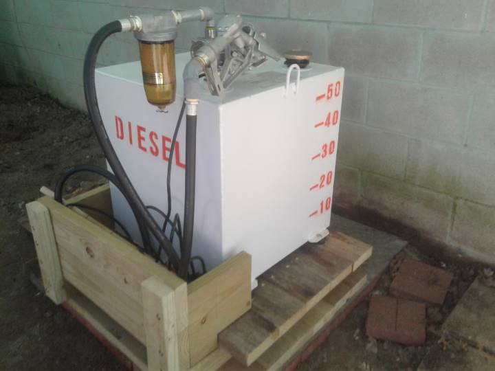

Made a "pallet" for a 50 gal tank, power it from the tractors.
  • Good Post
Reactions: JWR
/ Getting a new portable fuel tank.
#13
Nice setup. That is what I had in mind when I started this project but the tank was $400, the pump was $400, and an auto stop nozzle (wife-friendly) was $100. The setup I bought was $820. Hopefully it will hold up.
