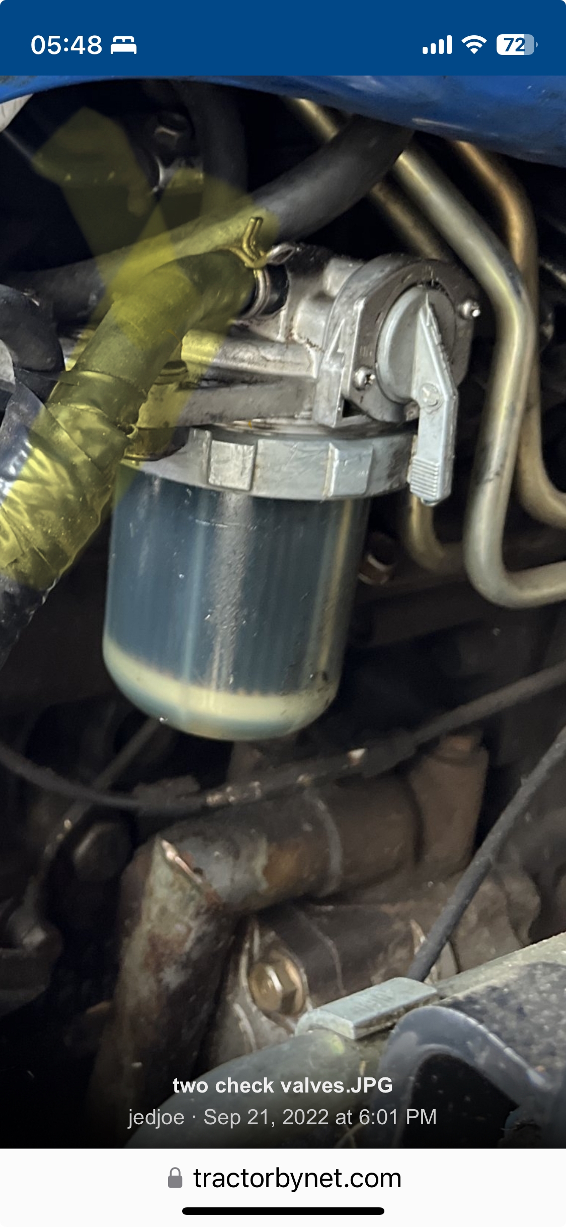

Today my TC45DA quit like it was out of fuel. I pulled the line from the tank off the filter and nothing run out. I used a compressor at the fuel cap and tried to get fuel to flow wi no luck. Then I blew from the line I took off the filter back to the tank and that got fuel flowing. So I must have junk inside the fuel tank that blocked the line.
With it running fine again I was watching the fuel filter to make sure it didn’t get blocked again. However, I noticed that fuel filter only was staying at about half full is that correct?
How much fuel is in your fuel filter when you’re running hard like heavy bush hogging?

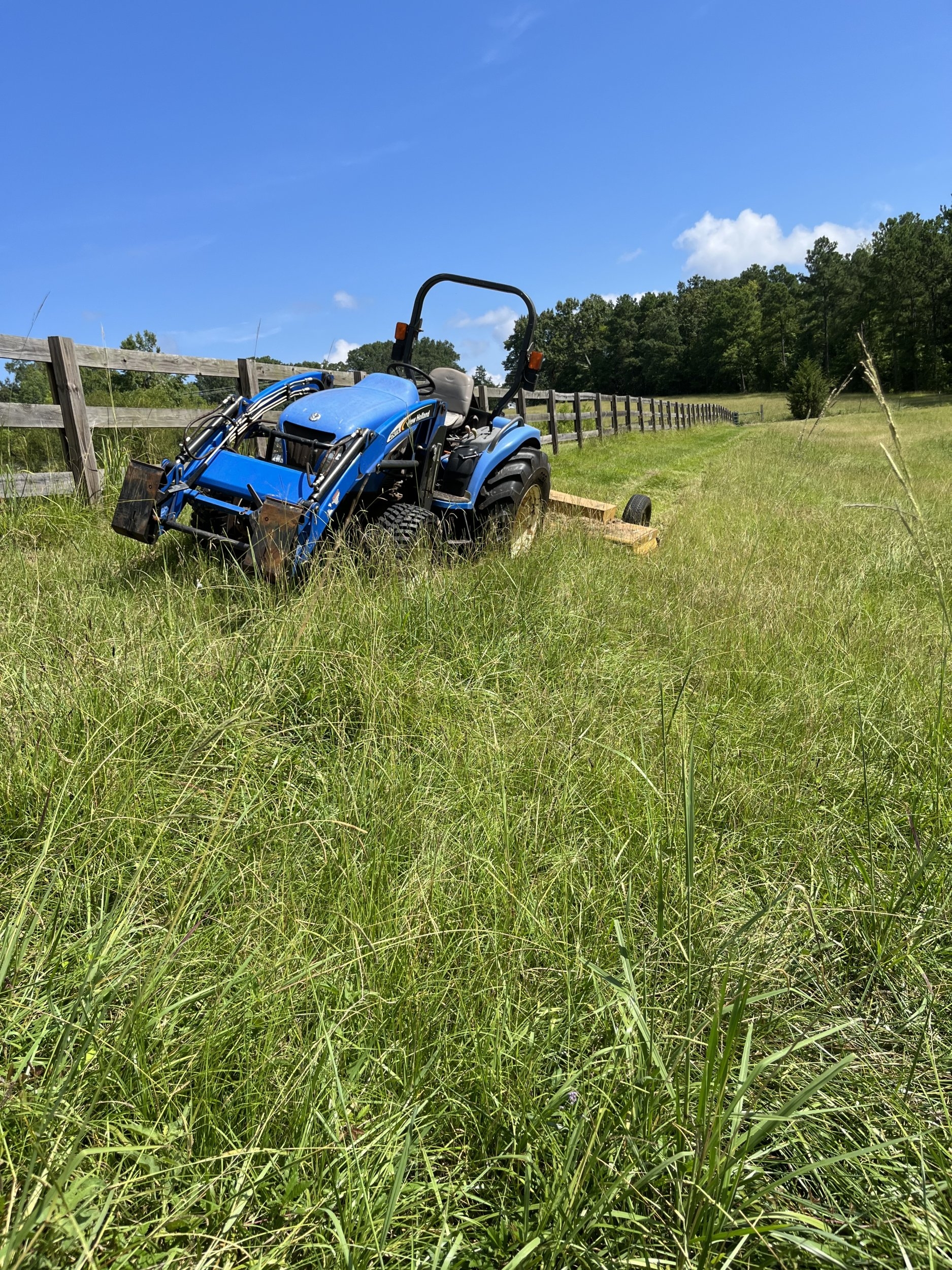

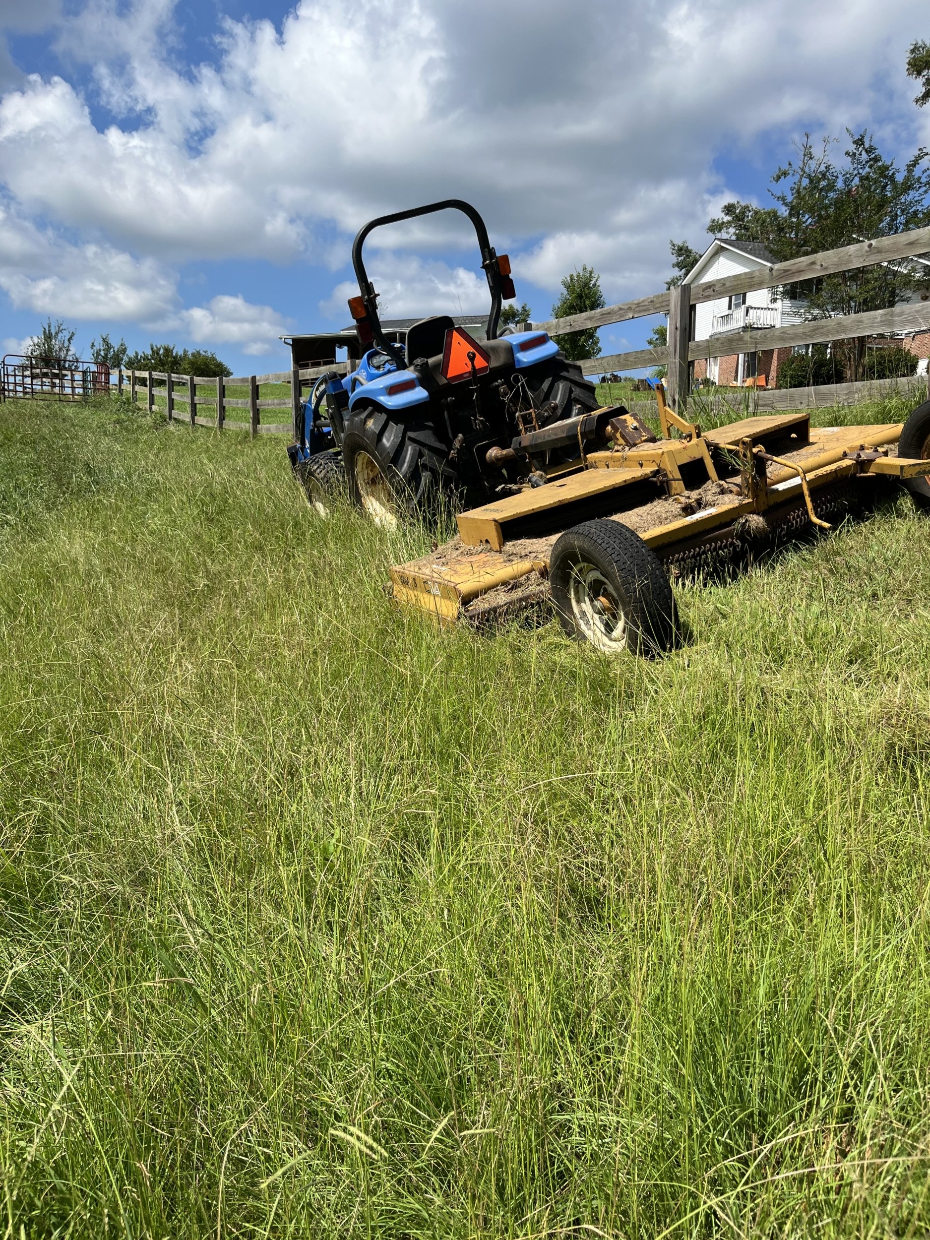

I was pulling a 9.5’ Woods C114 bushhog before and after the line plugged up and I cut at least five acres after that and it maintained that level of fuel in the filter that entire time.
I don’t think it needs bleeding based on how it ran afterwards which was the same as before the incident.

Pinch off the vent line on the top of the filter base. See what that does for keeping the filter bowl full. Better yet, just snip the hose and put a plug of some sort in both open ends. If you notice an improvement I can explain why.

It's quite simply really. The vent line connects the top of the filter base to the injector return line with a free flow to the top of the fuel tank. The supply pump is pulling fuel from the bottom of the tank through the filter and pushing it to the injector pump. You already know you have (or had) a problem with fuel getting out of the tank and into the filter. Once that starts and the supply pump has trouble getting an adequate supply of fuel it will start pulling air from the vent line and the filter won't stay full.

I cut and blocked off the line that goes from the top of the fuel filter and tees into the return line. It runs great and the filter bowl stays full now.
