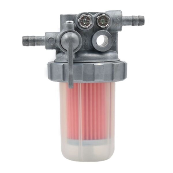

Most of the Yanmar machines have a fuel filtering system like this.
The filter, o-ring and plastic fuel bowl are used across nearly all of the Japan imported tractor brands.
I have the Ford/Shibarua SBA052300650 LONG on my machine. The reason being, I don't want a clogged filter while out in the back 40 to cut fuel off to the engine. It's a long walk back. Having the LONGER filter and plastic bowl also allows you to LOOK at the filter condition better. And you can see the real difference of the sludge at the bottom vs the middle and top. This is how you'll realize it's time to change it. With the SHORT (small) filter you can't hardly tell anything, thus you are stranded and need to keep waking the field to get back.
Here is the silly short (small). Grant it not all machines can do the large (tall) due to clearances in and around the engine, BUT if you can do the large, then by all means do so.

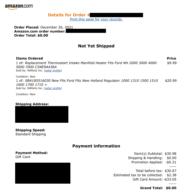

For some reason, the Ford/Shibarura 'identical' parts to our Yanmar parts are commonly at a better price.
Back in 2021/22, I had an order for a thermo-start and a VR. Just look at the great pricing not saying it was for Deere nor Yanmar! My neighbor has a Ford 1500, lots of parts on his engine are on my engine. filters, VR, alternator, etc.
Only 1 parts dealer shows part listings to fit more than one brand, Southern Global. If you browse enough for parts, you will find those cross references. Or a good neighbor to take measurements and compare. ;)
