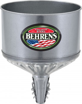

Or you can just go to tractor supply and buy one of these.
