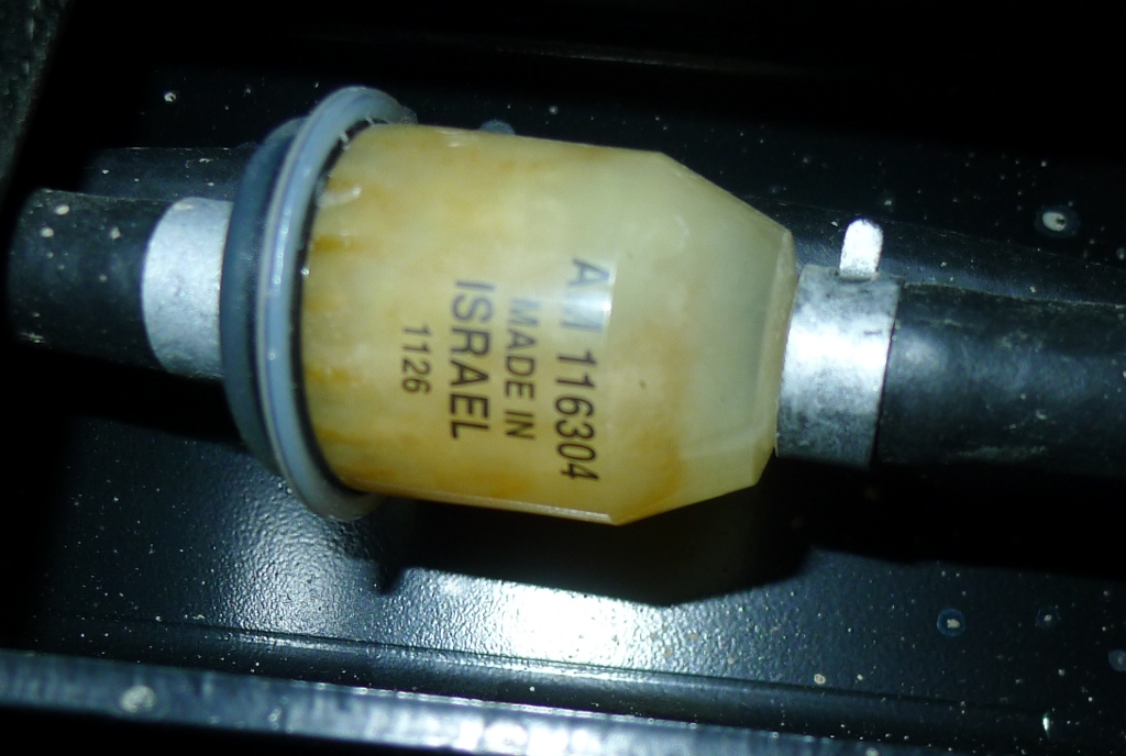

I've had two instances where my BX2660 freezing up. It would idle, but not run open. I dumped 1/3 of a bottle of 911 in the tank and let it idle. It took 45 minutes of running to dissolve the gel in the fuel filter. I am convinced it is due to the plastic fuel filters. I never had issues with my B-Series with the bowl-style filter. I think it's the paper insert. Even filling my tractor fuel tank, the fuel would gel up on the screen insert in my funnel. Treated with Power Service.
