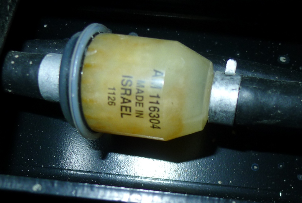

That's what my filter looked like after getting fuel at one of the local places. Surprised me because he puts that same fuel in his concrete trucks.
/ Frozen, Gelled fuel #45
Yeah, this was supposedly fresh winterblend from my local station, and we have more than avg diesel usage up here.

Honestly right now, i think its my new Racor that's keeping the tractor running and not the PS. There was 1/4" of ice/gell in the bottom of the filter ! And again this is PS "treated" fuel !! After this 5gal can is finished, im going to be going to another additive brand.

If the bottom of the raycor had ice in it, you have 2 problems. The fuel gelling is one, which should well respond to winter antigell/ diesel fuel "heat" provided the gel hasn't clogged the diesel fuel high pressure pump. The Raycor filter bottom which has a thumb wheel drain tap is for the purpose of a fuel / water separator. Ice in the bottom suggests water in your fuel. That bottom is specifically to allow water in the fuel to separate out and should be occasionally drained off! Unfortunately, depending on the mounting location of the raycor, it will either have a tan aluminum bottom cup, or a clear plastic bottom cup. The clear plastic lets you see if water is separating out, but is not for mounting in a closed potentially very hot engine compartment! With the tan aluminum cup you should simply periodically drain into a sight glass to check for water. If its significantly below freezing however, ice freezes in the lowest place (the drain tap), and it won't drain from the separator drain wether you have the aluminum or plastic bowl!!!
/ Frozen, Gelled fuel #60
Temp got up well above freezing and the ice liquified. I drained it into a mason jar, which I still have. Ill grab a pic.
I know there has to be a bunch of water in the tank somehow (im pretty careful with my fuel). Im going to dump what's left and start with some fresh. I also got a Racor "Mr. Funnel" to run my new fuel through because I got it at the same place as the current tank that has given problems.
