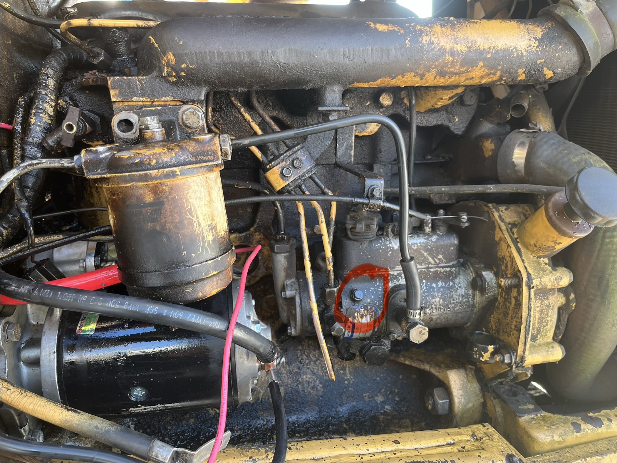

Finally got enough progress to get the 555 to turn over, but it will only fire on ether. Opened the bleed screw on top of the fuel filter and fuel dribbles out without air bubbles. I opened the bleed valve on the pump circled in red on the screenshot and it squirts out decently when cranking over. Nothing at the injectors though after a lot of cranking.
What is the next logical thing to test?
Supposedly this thing ran just fine in October of last year.
A few disclaimers…
1- I have not yet swapped the fuel filter…don’t know how old this one is.
2- It’s been consistently cold here with temps rarely getting above freezing for a few weeks…often into single digits at night.
Next time I’m there I’ll do the filter. If I’m getting fluid at the 2 bleed points I mentioned, could it still be the filter?
Could frozen water in the diesel be the culprit?…if so, where?…In the lines running to the injectors?….in the pump itself?
Thanks for any assistance.

Either's not good on a diesel! You can get it to fire so the Eng. not locked up. IMHO don't use it. Compression Check them would be a good thing to know. Fuel Filter, Clean Fuel and my guess it runs. If you look where you have the Red Circle in the Pic.. Next to that where it's located the Fuel line could be sucking air. One side of the Rubber line is clamped but not the other end No Clamp? which may be a leak before the pump. That would be what to look for etc..

Do you have a glass bowl on the fuel pump? On my 1998 555E there is a filter inside the fuel line where it goes into the fuel pump that gets plugged up. It's also a good idea to remove the glass bowl and clean everything inside there with brake cleaner. I just spray a can on everything until it's clean.
Be sure to fill the fuel filter with diesel when you install it.
When I've run out of fuel I have to loosen the lines for all four injectors and then I hand pump it until all four have fuel coming out of them. Only then will it start back up for me.
I've never messed with it when it's cold out. If you are getting fuel to some of the injectors, odds are good that the injector pump is fine.
The fuel pump on mine has gone out just about every four to five years. They are cheap on Amazon or Messicks. I haven't noticed a difference between OEM and Aftermarket.

If the pump top has not been disturbed since it was last running, I would say the shutoof rack is not the problem.
I would wager that there is enough gunk in the pump from age and your cold weather to cause the pistons that cause the high pressure charge to be stuck. As suggested, warm the pump with a torch to see if it will pump to the injector lines.
The missing clamp is not a problem as that is a return to filter.
It has a thermostart manifold heater in the front of the intake manifold that you could apply power directly if it isn't working off of the ignition switch, but you need fuel to the injectors before you worry about that.

No fire. I was told they last ran it in October/November and now they have a much newer unit on site so they don’t need this one. Is there a way to prime the injectors without turning the engine over?…some sort of manual method? It’s very cold here and turn the motor over constantly is tough on the battery and starter.

You most likely have a fuel problem! We can see that! Mentioned the possible missing clamp doesn't mean that was the problem. If it sits Vacuum can suck air in it. Rule out #1 compression. You was using either to get it to fire was a indication of being low. Now could be possible No compression after using the either ?. Which is well known to cause problems on a diesel Eng.. Go through all the lines and replace the High degree Ghetto Job!! No doubt about that now. Doesn't take a genius to see that. Replace the lines and Chk. the compression If it has any now..

No, there is no way to get the injectors primed without the injection pump turning over. The starter will be fine, but you just need to go in short 20 second tries. Your battery cables are nice and heavy; good for transferring needed amps.
One thing to do as well when priming is to open up the throttle fully.
