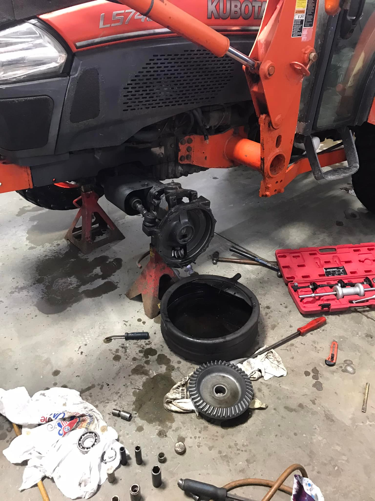

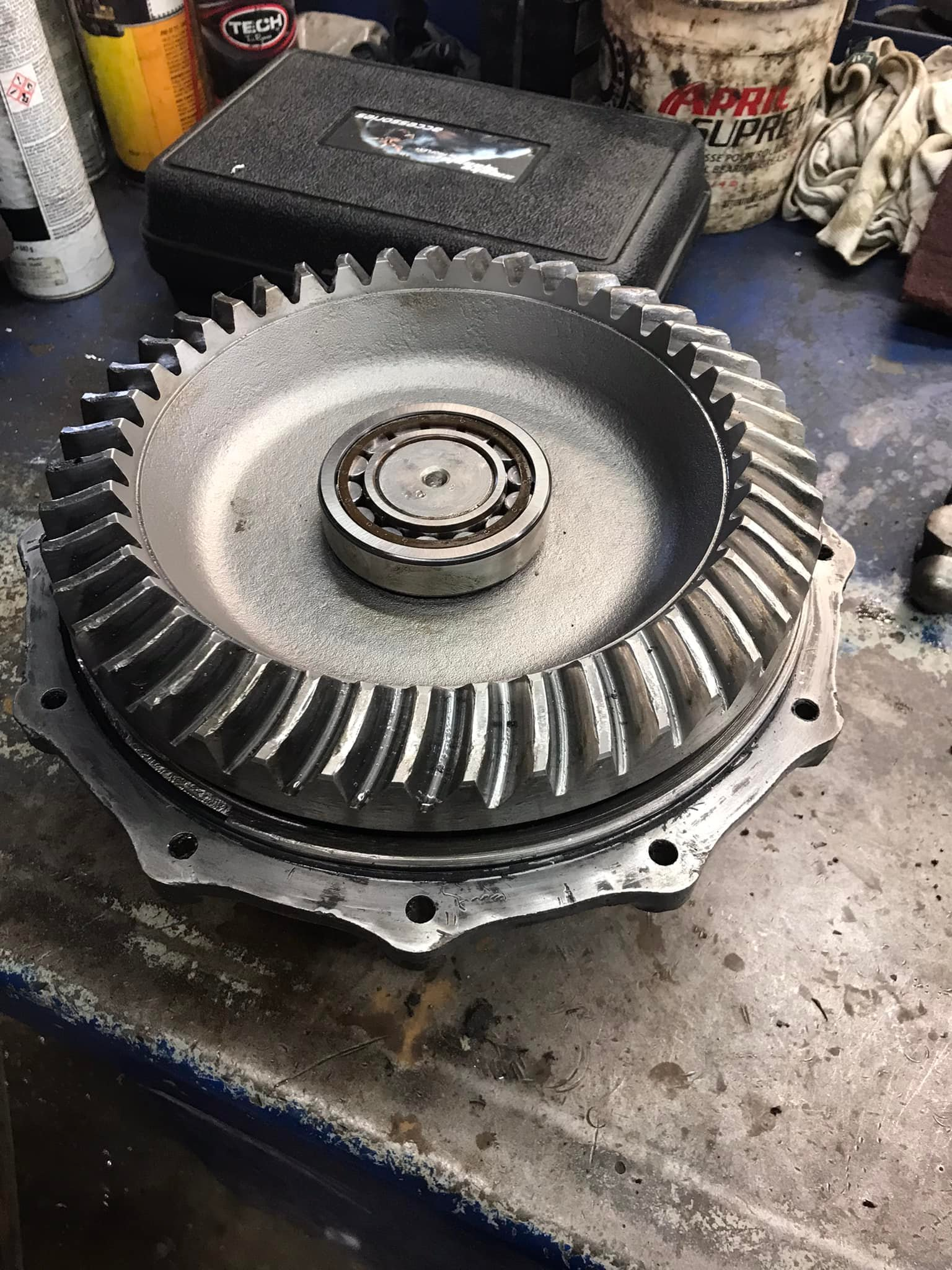

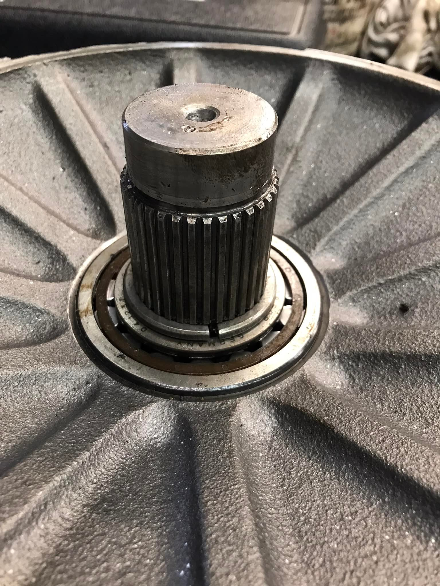

just to make an update on this post from at least 1 years ago, yes, there is some more reliable bearing that can go in i use a 7-12 foot extendable push/pull snow bucket during winter and a hay ball clamps that weight 390kg during summer and tractor is at 4100h right now. nothing last longer then this one so far
