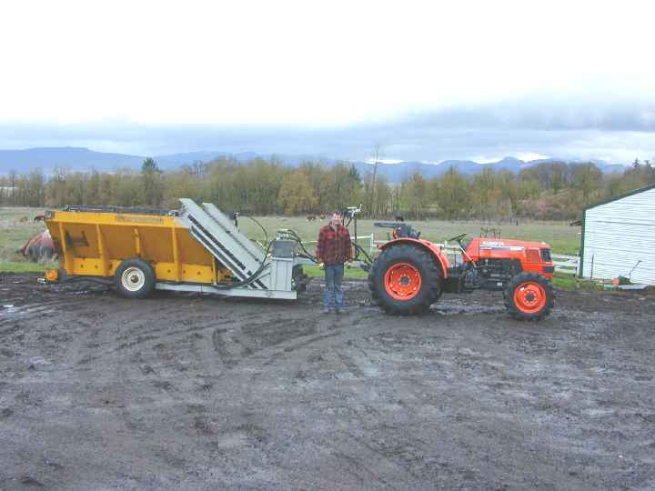

So I just built a rather large implement for my tractor to clean my poultry barns. I’m guessing that it weights somewhere around 5 thousand pounds empty. I’m not done with it yet but I did take it for a first test drive. Now so far I haven’t needed any extra weight on my tractor but with this monster behind me things felt a little to light on the front end and steering sometimes needed some help with the turning brakes.
So I have some options.
I could get the Kubota 120lb suitcase weights. The bracket cost $230 and each weight is $60 and there are 10 of them. I may have to wait a little while until funds become available if this is the best option.
I could build my own weight bracket and cut out suitcase weights which I haven’t looked into how much this would cost.
Or could I fill the front tires. This would add less weight but would be more compact which is important when driving inside. There are lots of you folks out there with filled tires. Did you fill the fronts?
As always your opinions are appreciated

Moving that axle and changing the center of gravity or tongue weight a bit would have solved your need for front weights. However weights or filled tires are not the worst things in the world. We use rear weights but have not yet needed front weights. Very nice job on the construction.

Is you decaker attached to the tractor in the picture?

Moving the axles forward would have certainly put less weight on tongue but would have raised the rear end of the machine and increased the angle of the lift conveyer. Both of these things might have been problems with the design.
Jerry:
<font color="blue"> Is your decaker attached to the tractor in the picture? </font>
Yes it is the first rev of my decaker as you call it. It is similar to a Lewis or KMC poultry housekeeper machine. Many things need changed and buttoned up on it (like guards ect.) which I am going to be working on now that we got chicks back in the barns. I will be doing a full post detailing the construction once I get it done. I have been working on it pretty solid for about a month now.

The reason that I asked if it was hooked to the tractor in the picture was because I was thinking the same thing as Egon. If the tongue was as long as it appeared in the picture, then you could possible put caster wheels on the front of the machine. You would need a fair size wheel for flotation in the litter.

The tongue was built in haste. I plan on making mine more like the one in the attachment. The hydraulic tongue will give me more control. I also want it to be as short as possible to allow for more maneuverability.

</font><font color="blue" class="small">( tongue was as long as it appeared in the picture, then you could possible put caster wheels on the front of the )</font>
Neat idea.. could even do a swivel.. and have a sort of 'trailer dolley setup.. actually having two casters on front, with a swivel. The'll automaticall track when towed, and with two tires will 'float' better.. and unload the tractor rear end to some degree.
