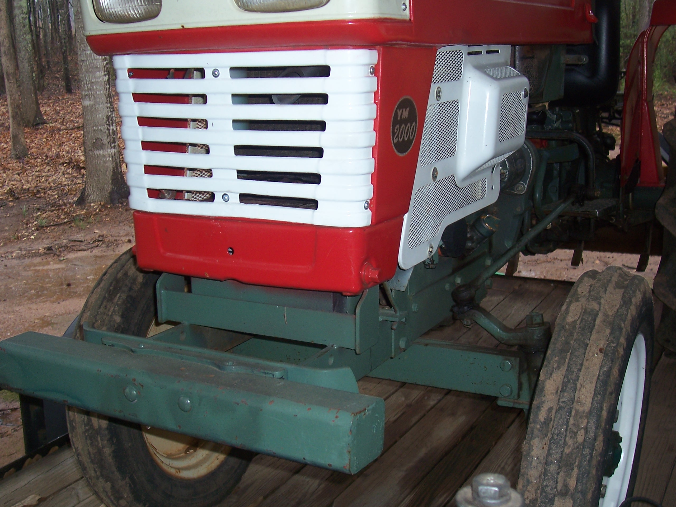

The lead in metal pipes works really well. A collection of lost anchors from local Lakes packed this one. ;) It's been a while but I believe in came in around 80lbs. Plus it added a bigger and better bumper. Everything is set back out of the way which I have to be really close to hit something with it. I only needed the weight for when I lifted the FM. of 600lbs. It was really light on the front traveling.

:D Collected a few over the yrs. but what's not funny is where my 2000 was sitting was were my Ranger use to sit. Had to sell it since there was no way I could use it much if @ all anymore. Had it for yrs.. Over 10 so I accumulated a few and found a good use for them. And when I tagged it which confirmed what was told to me or actually my wife who bought it for me. Was that it came from Augusta. Ga.. W. Payne owner...Yup!! it was BA. esp. after It took care of some things......
But my bumper packed solid and wasn't sure if it was enough weight or not. Which it did help a lot and added the bumper. If I recall I set it on the wife's scale just to get a good idea of the weight. Which came up about right It was actually 4 anchors I cut up and packed in.
