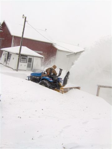

NH TC33D, 33 hp and 26 at PTO. 5 ft. front mount blower and tractor barely notices blower at full capacity. 7.5 ft, 5 blade rear finish deck and again, tractor barely notices mower at full capacity. The 5 blade actually pulls very easily, but I borrowed the neighbors Woods 7 ft, 3 blade with high lift blades, finish mower and it pulled noticeably harder. I attributed the difference to the high lift blades.
This was my TC33D with a 60" blower in deep, hard packed drifted snow (you could walk on top). I would slowly creep as it took lots of power.
