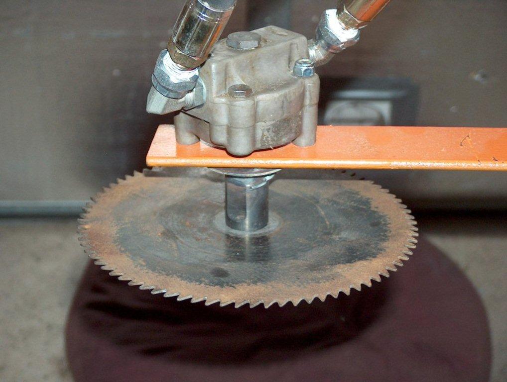

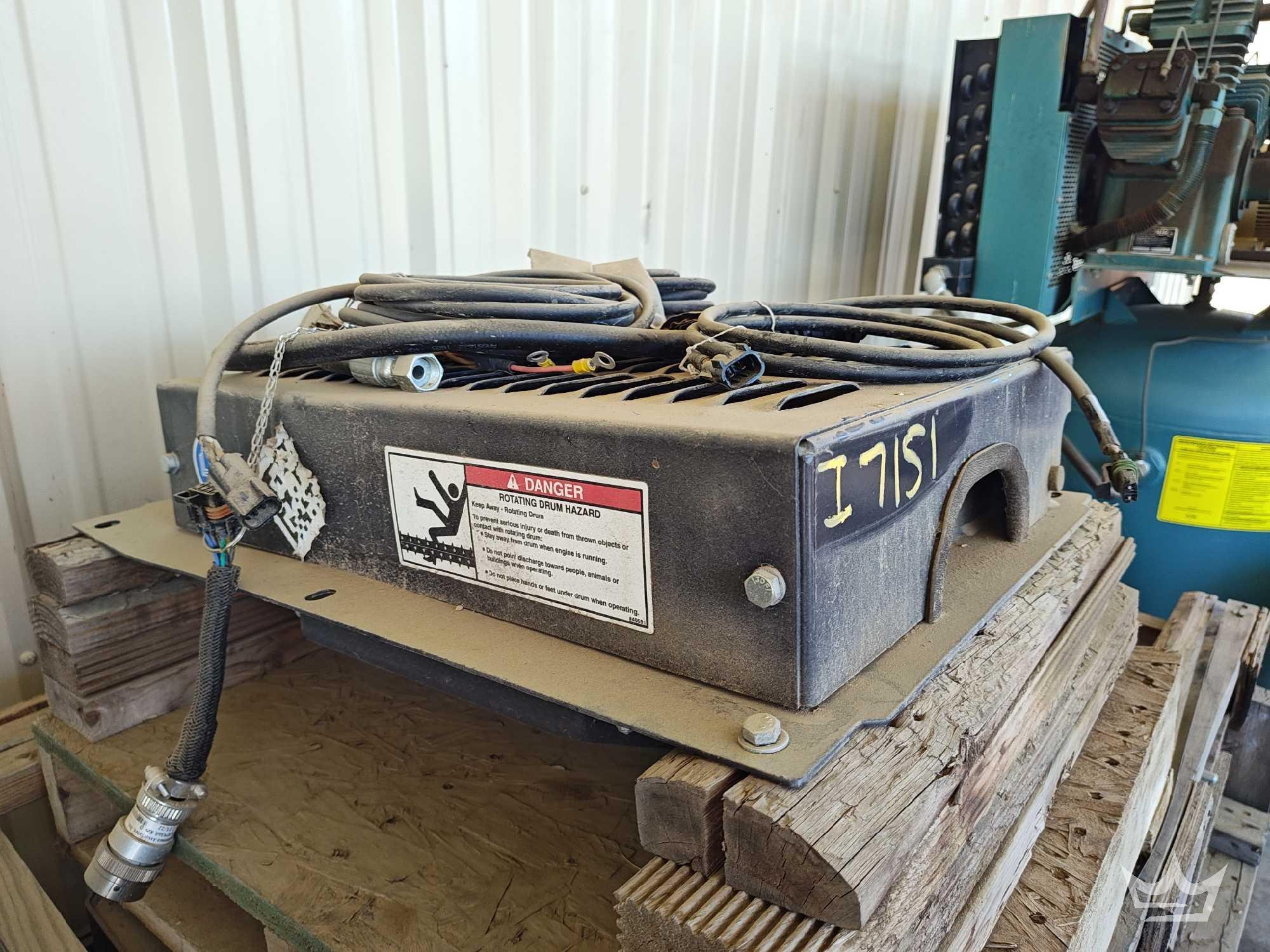

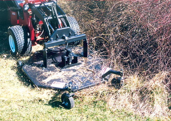

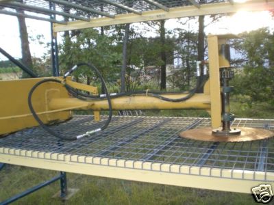

Here are some alternatives.

Thanks for the info. J.J: I like the pictures you provided. Do you have any info about them? The Bobcat brushcutter is neat but it doesn't seem like my little tractor will run one.
