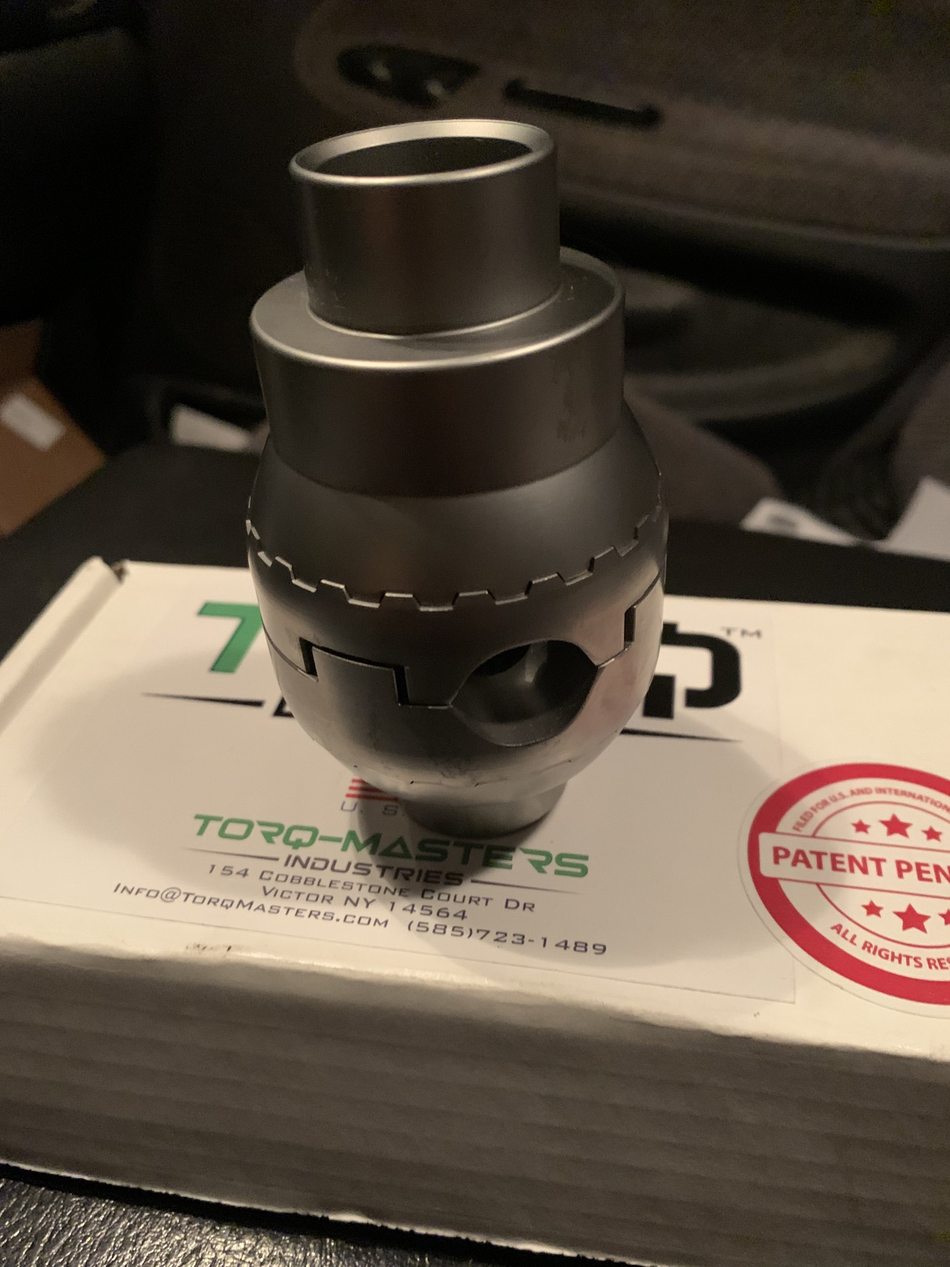

let us know how it does. the website say out of stock ?
I couldn’t find one anywhere in stock either. Called the manufacturer and they didn’t have an ETA on one either. Neil Messick actually had one sitting on his desk the company gave him to make a video on. Neil sold it to me for 1/2 price. $300 shipped.

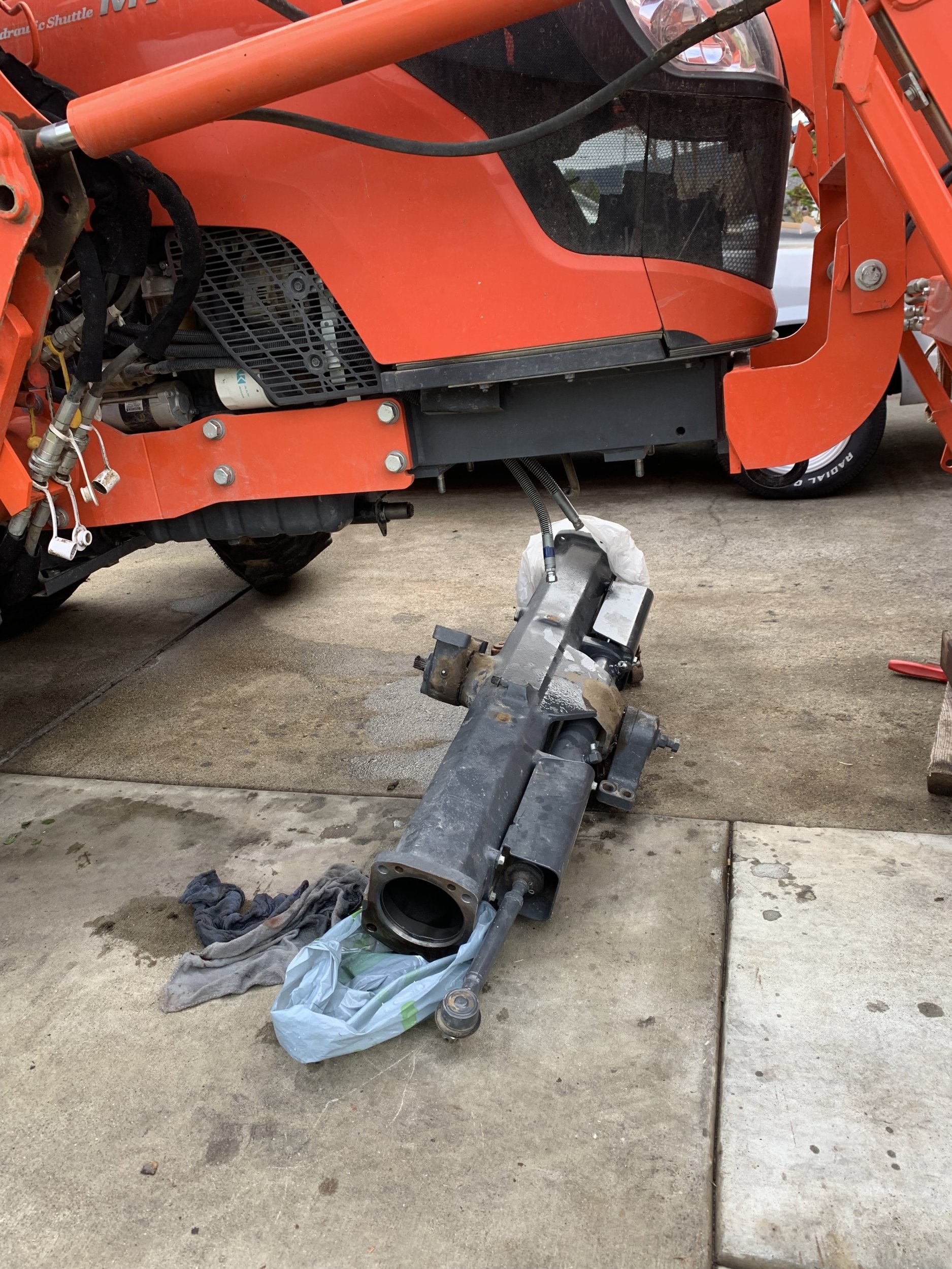

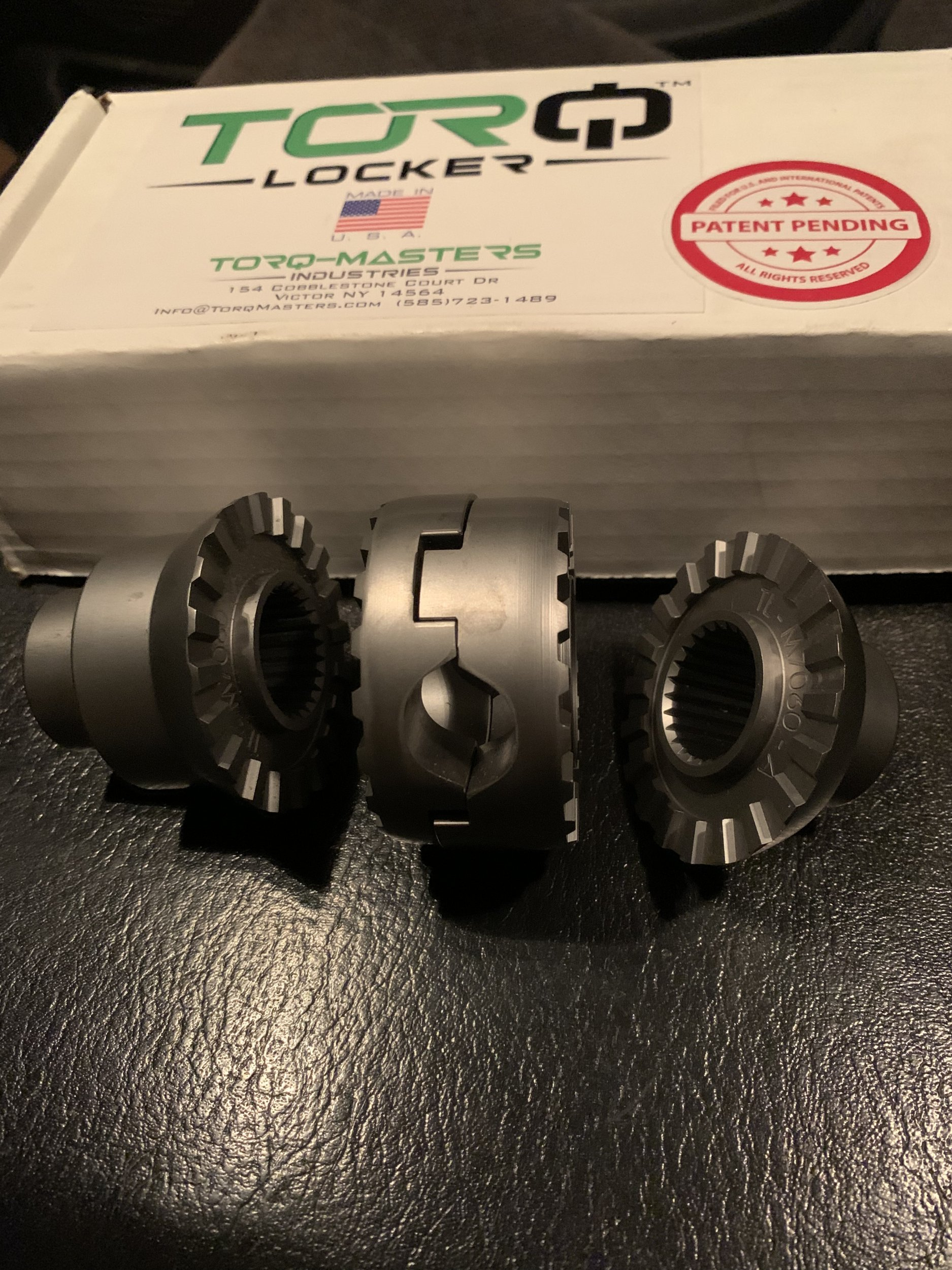

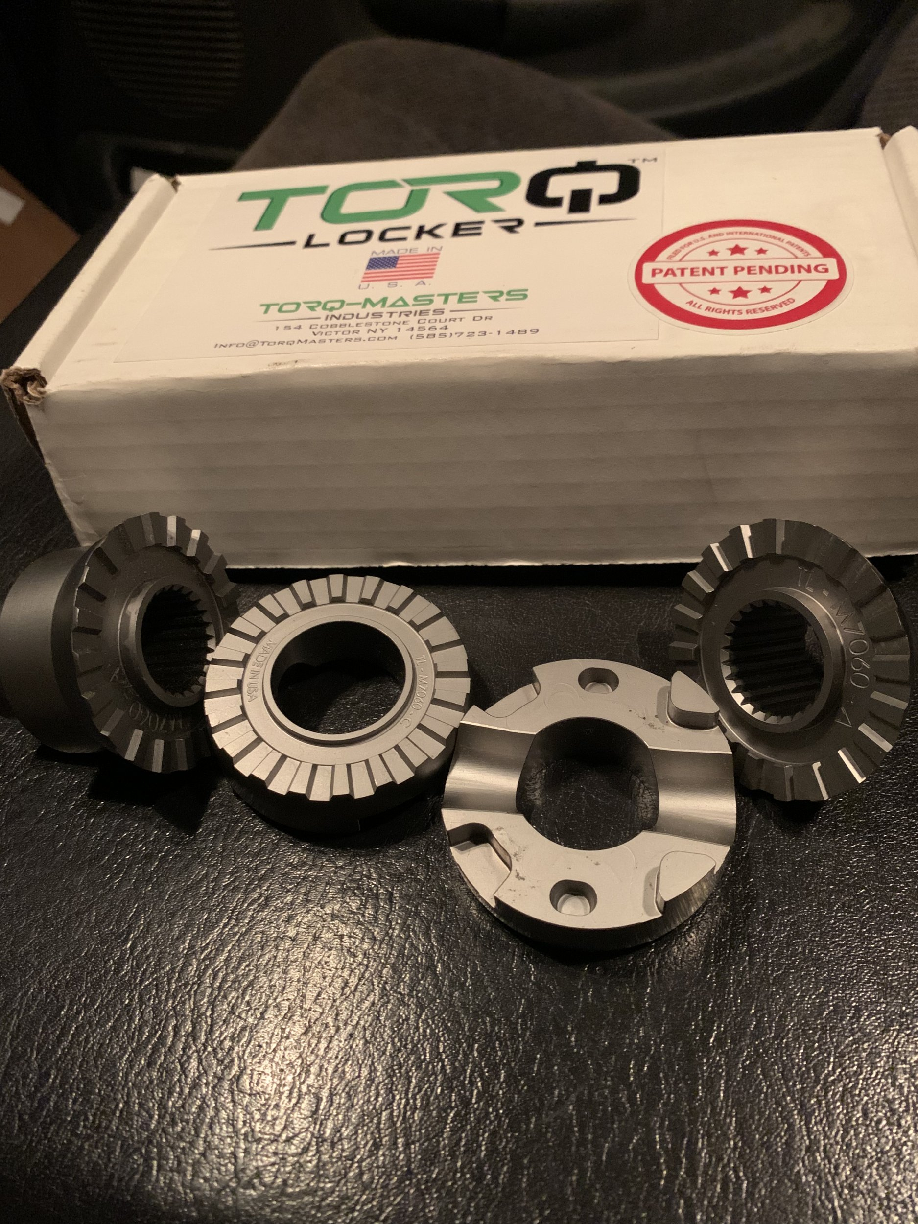

I’ll start on the install this weekend.

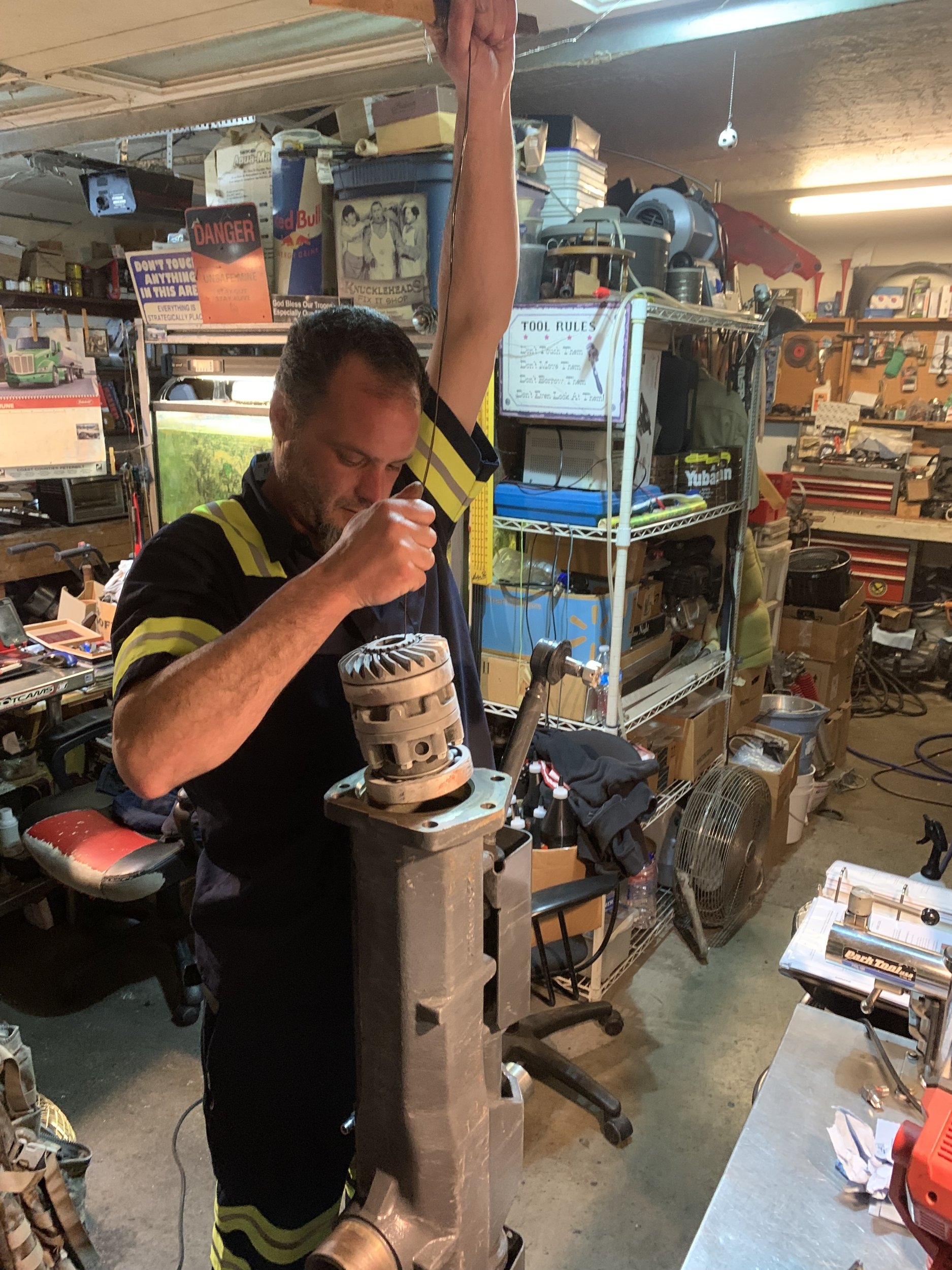

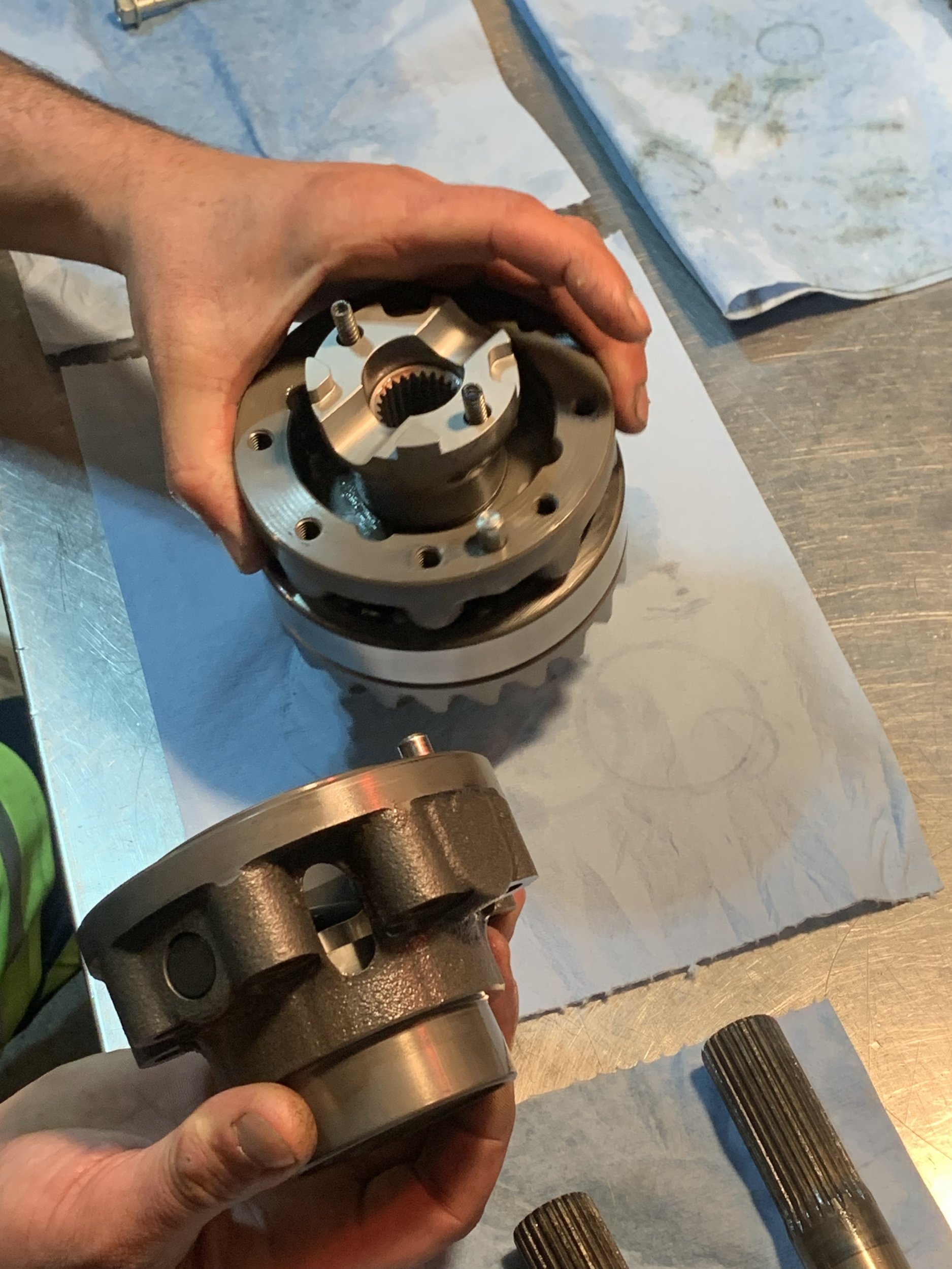

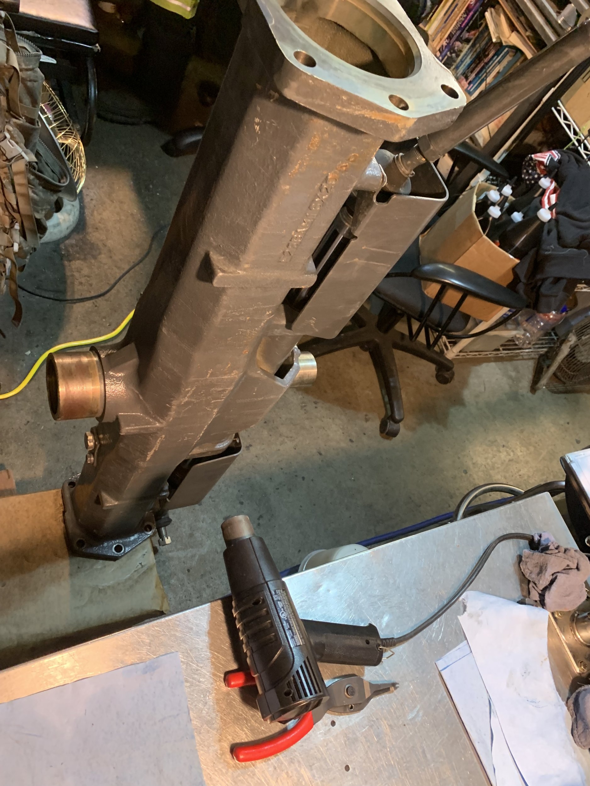

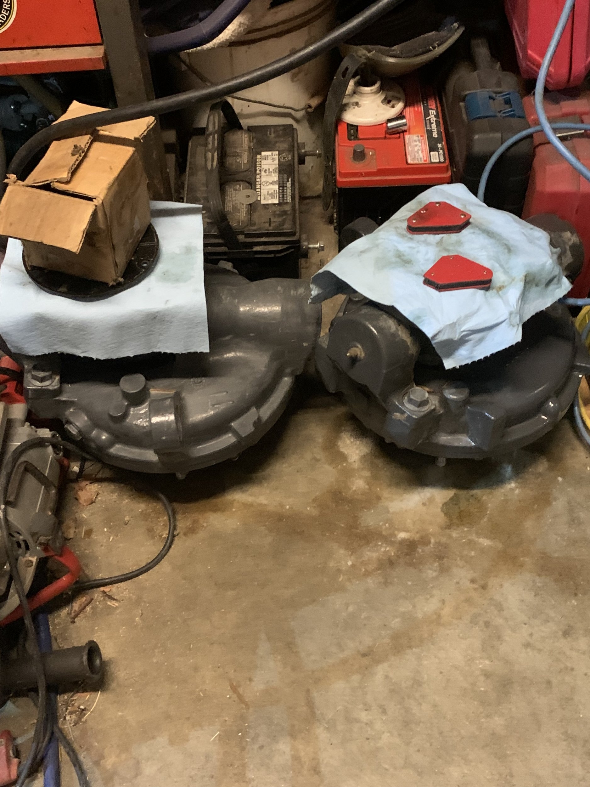

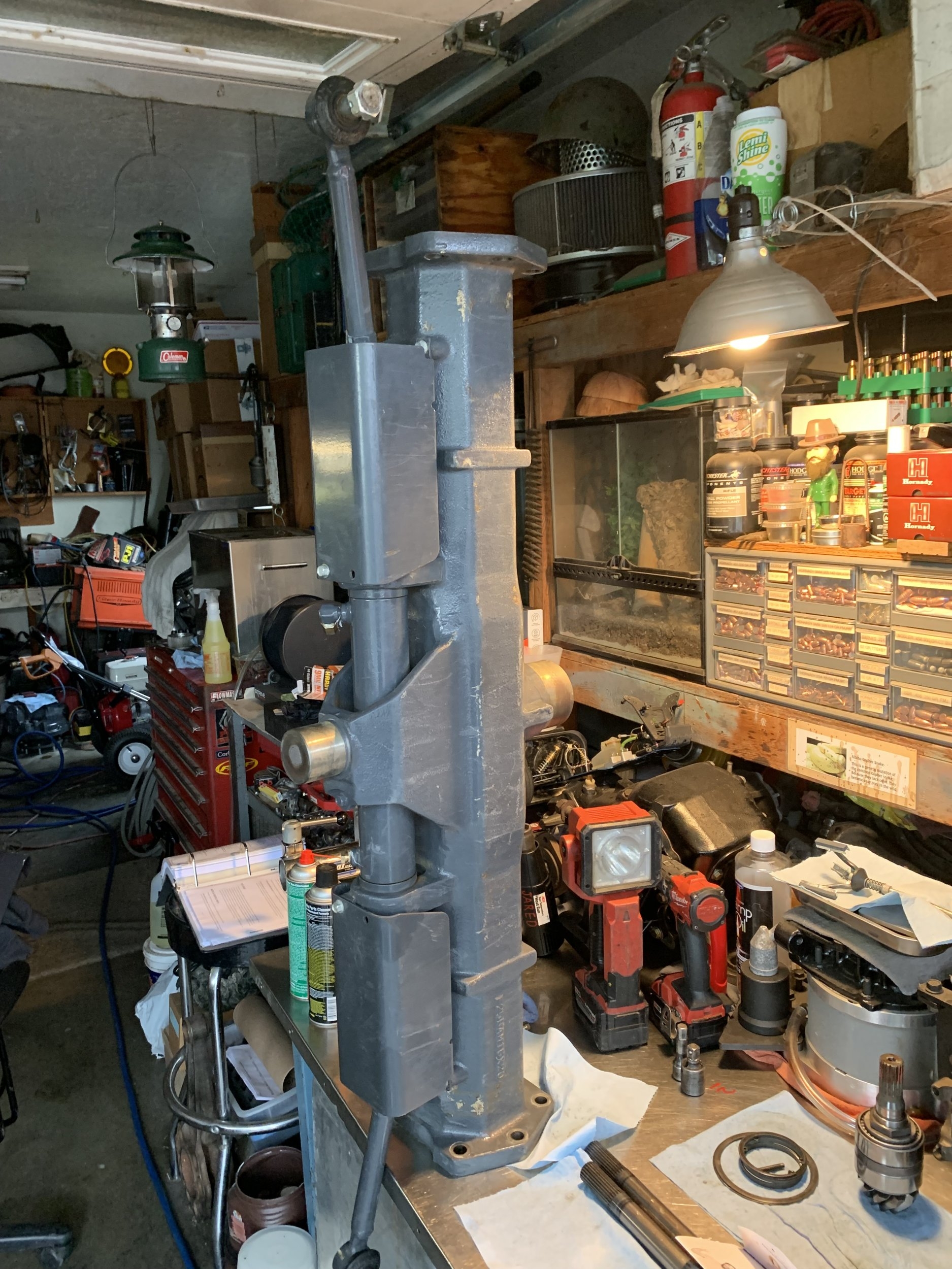

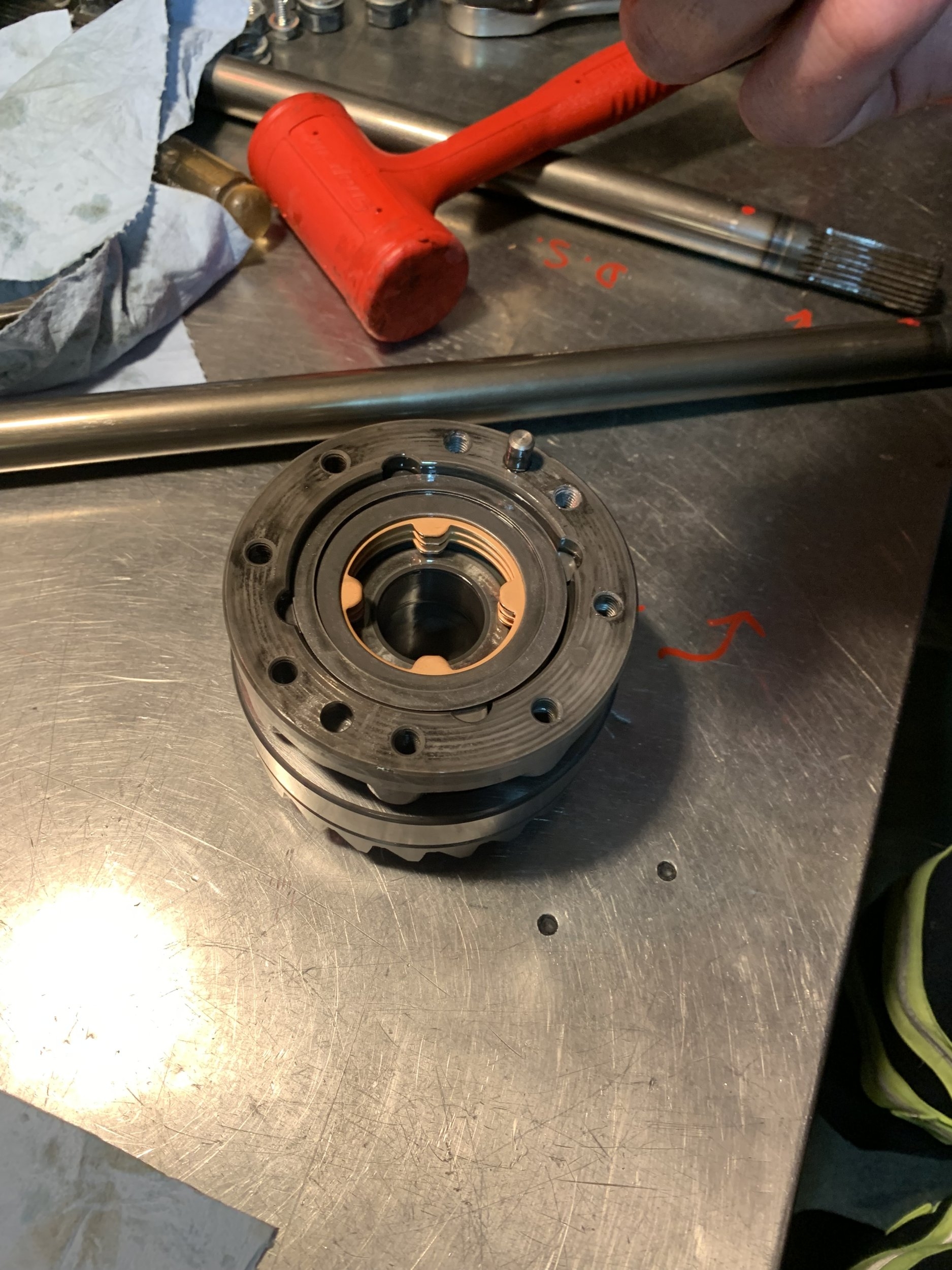

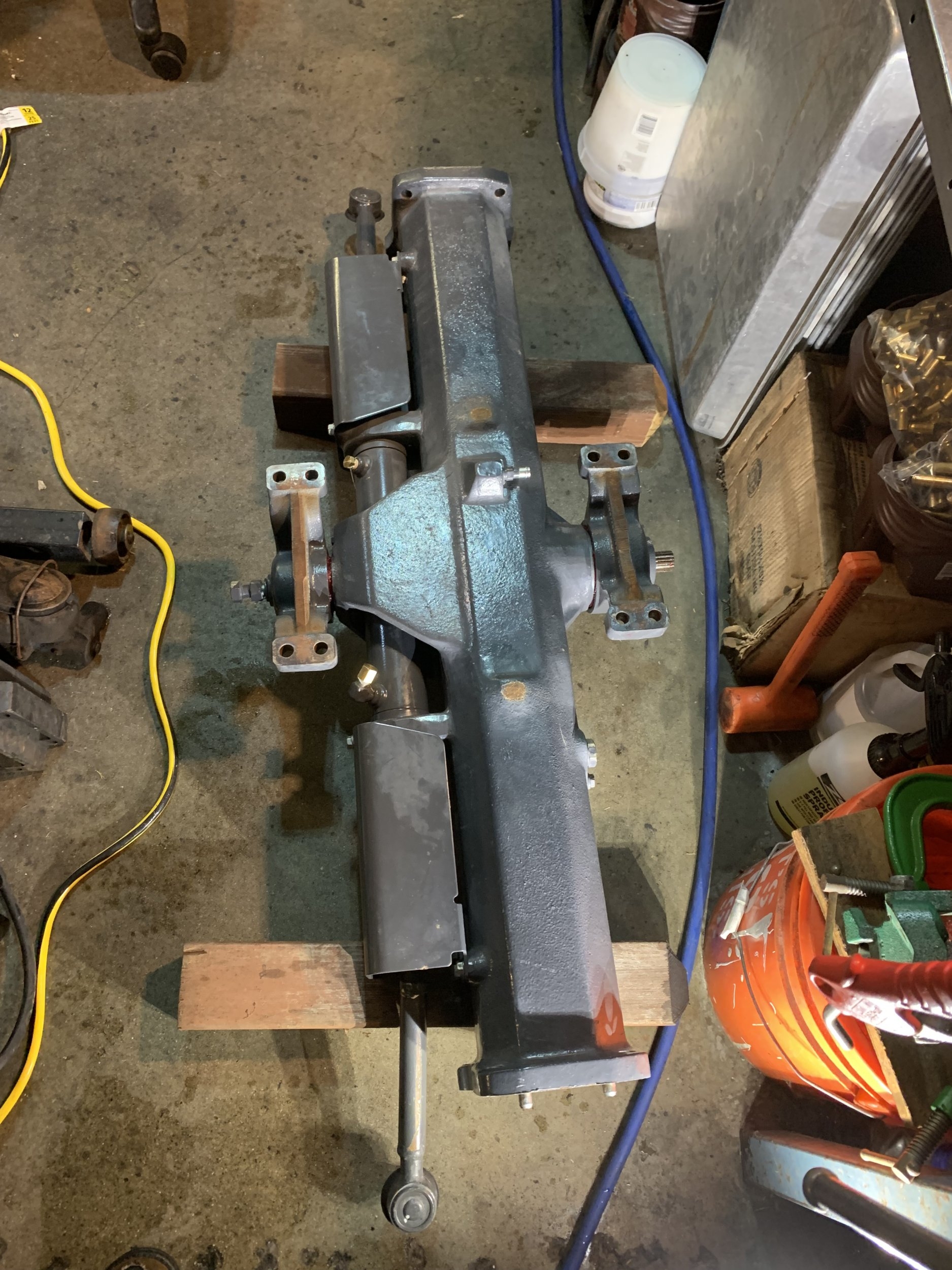

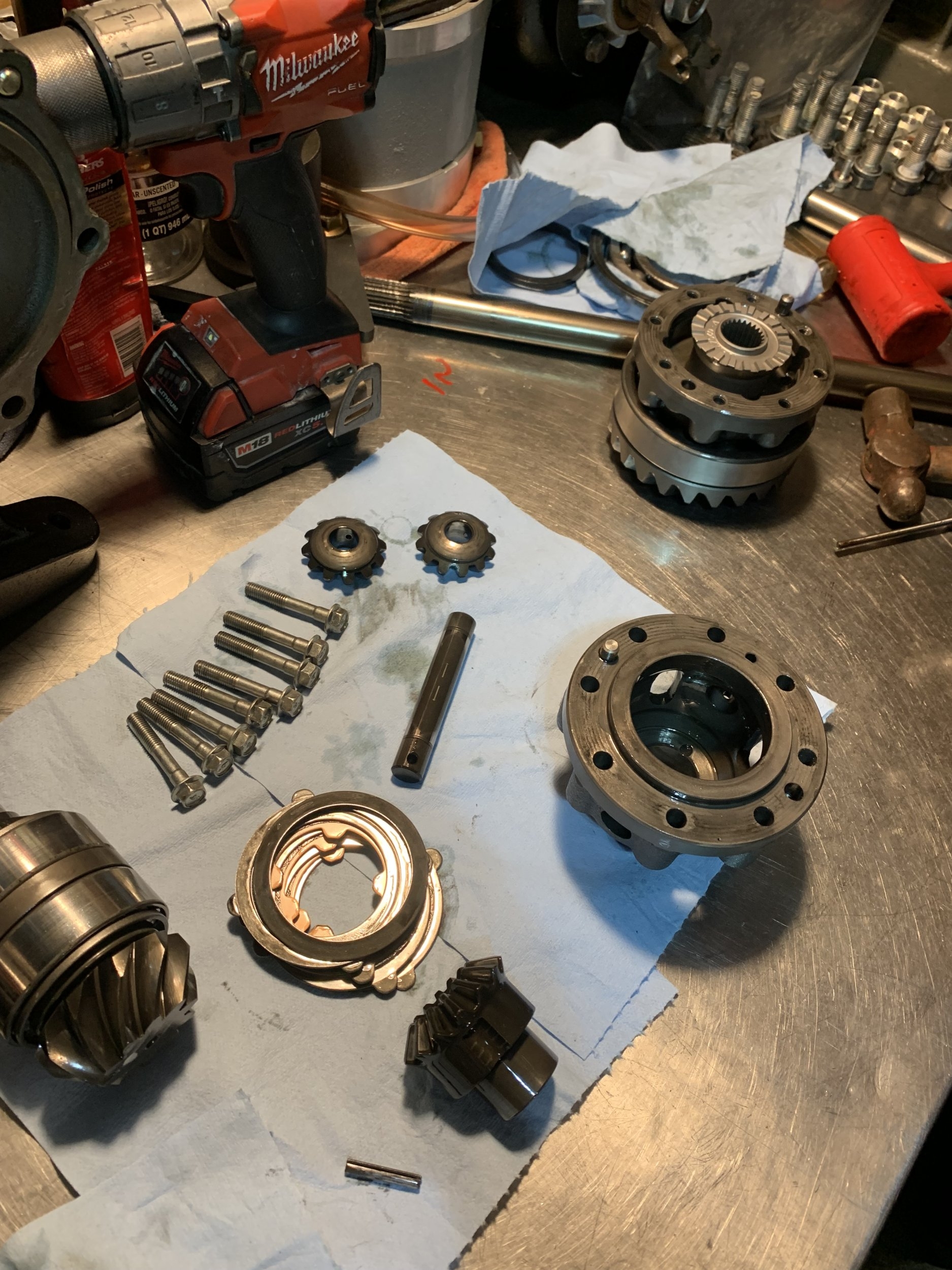

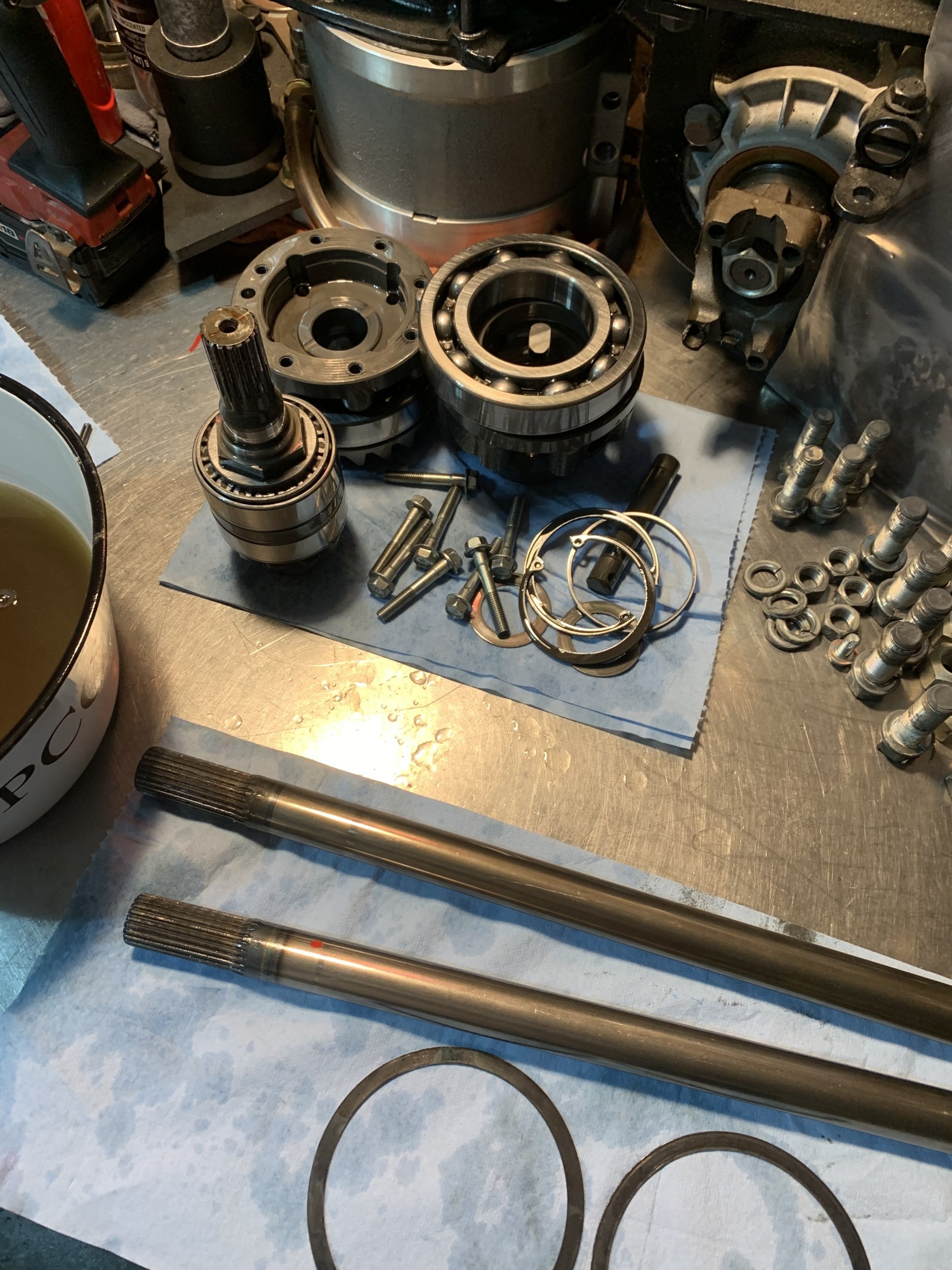

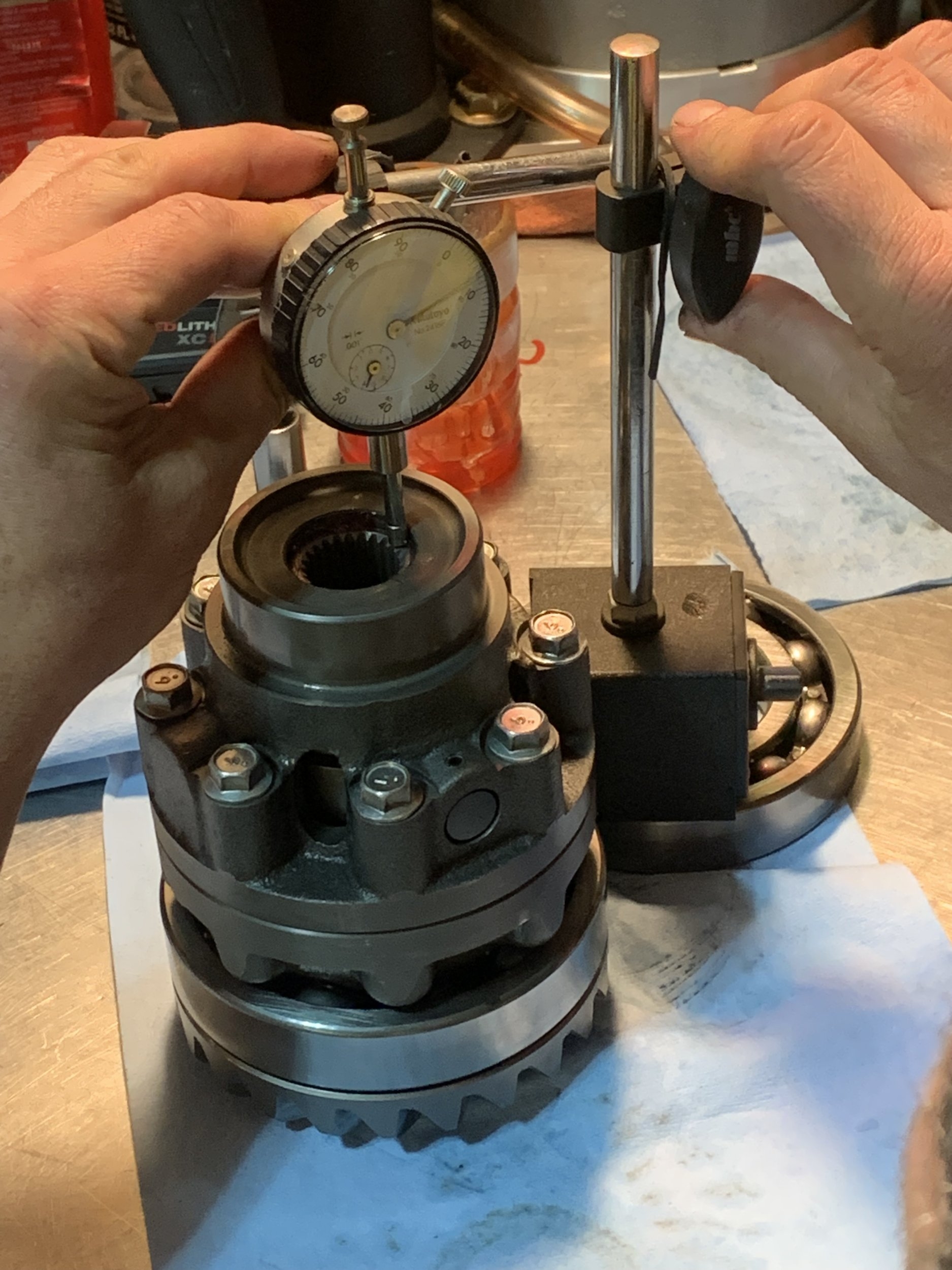

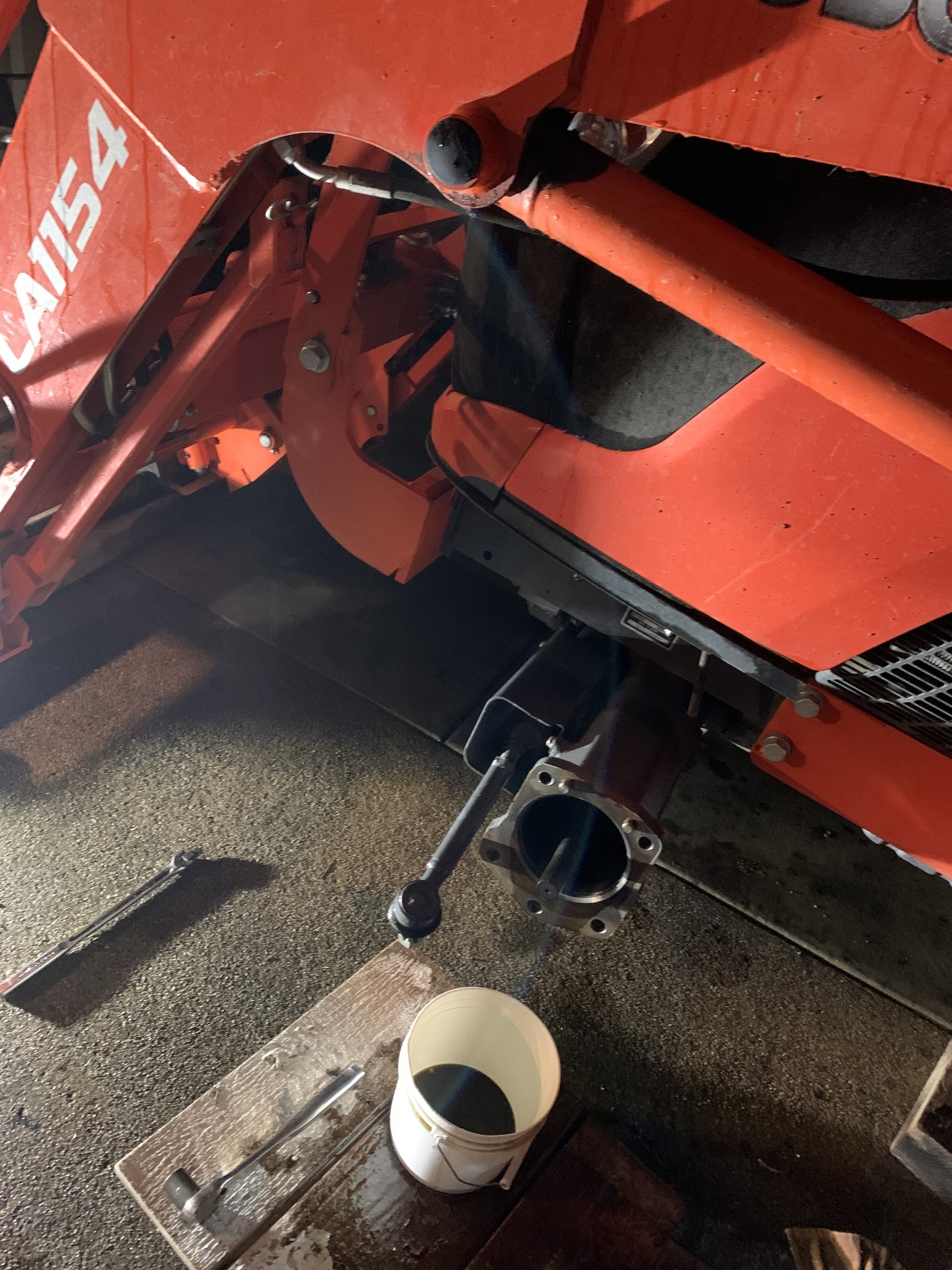

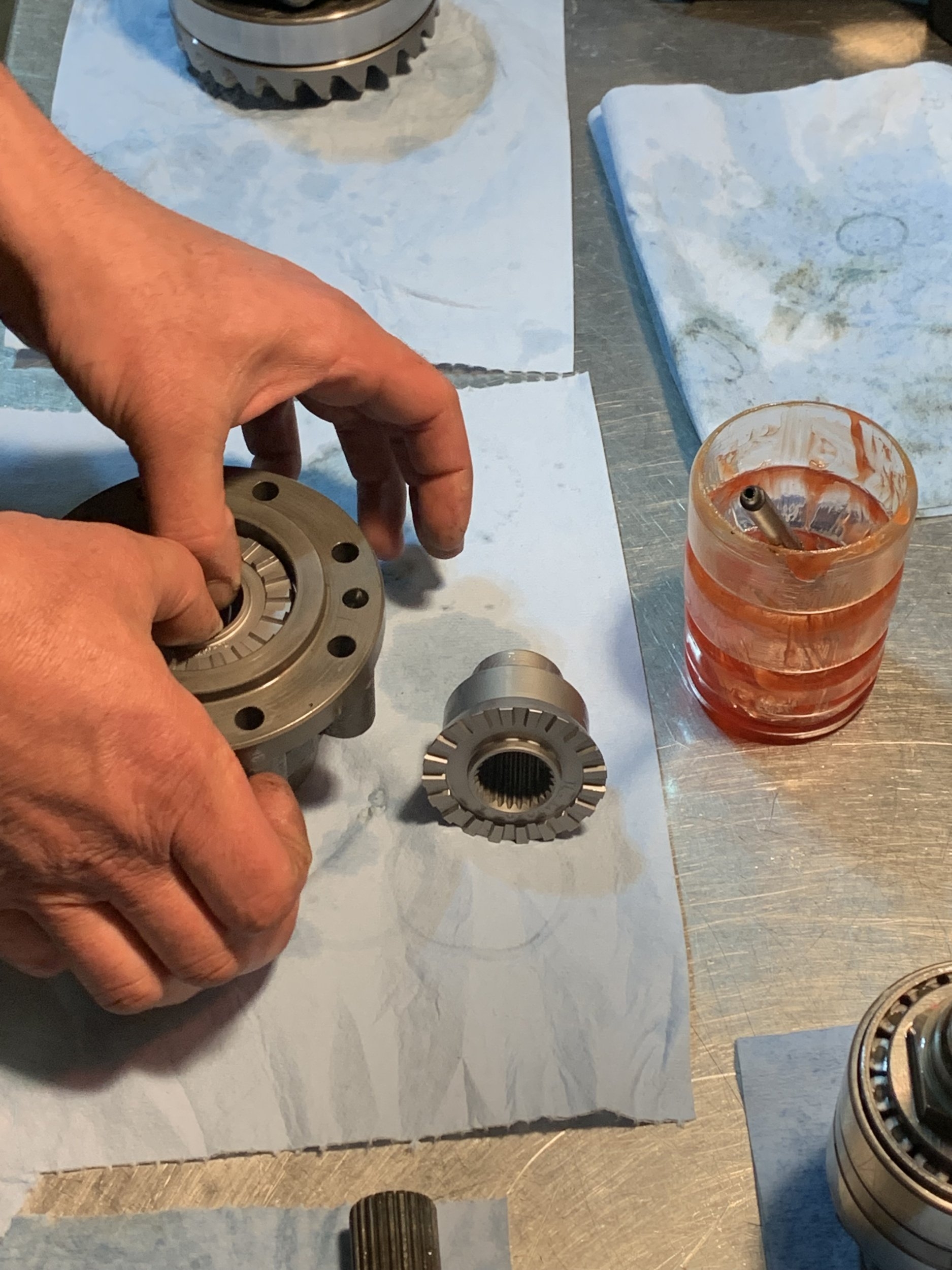

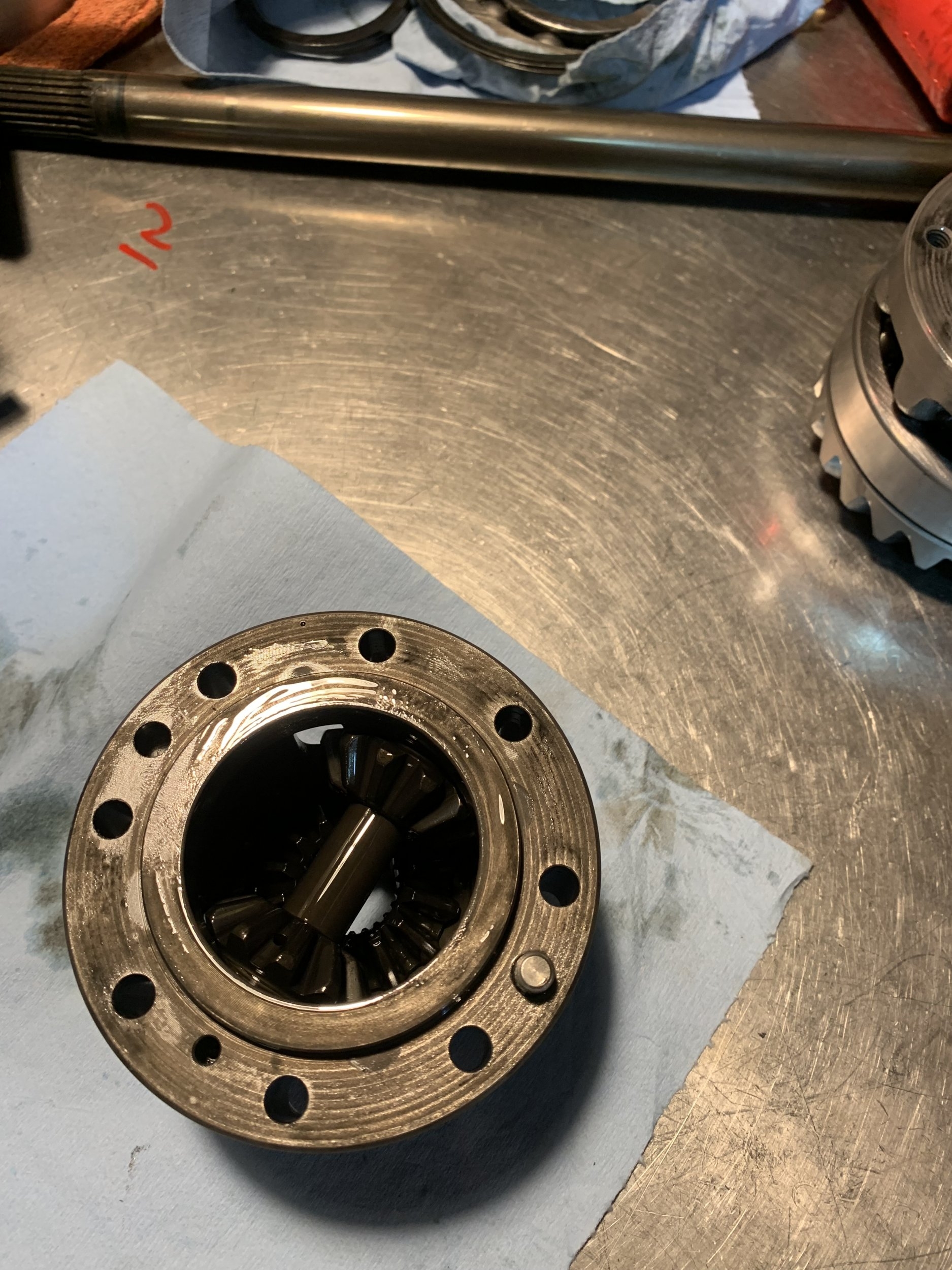

Well I finally got it installed. Took me 3 days. Dropped the axle, tore it apart, cleaned everything, assembled and put back together. The bull gear/bevel gear assembly are very heavy. Good grief. Trying to muscle that back on, and aligning the axle shaft took a couple guys. Not too bad of a job. Really take care in noting the placement of the shims/spacers for the differential.

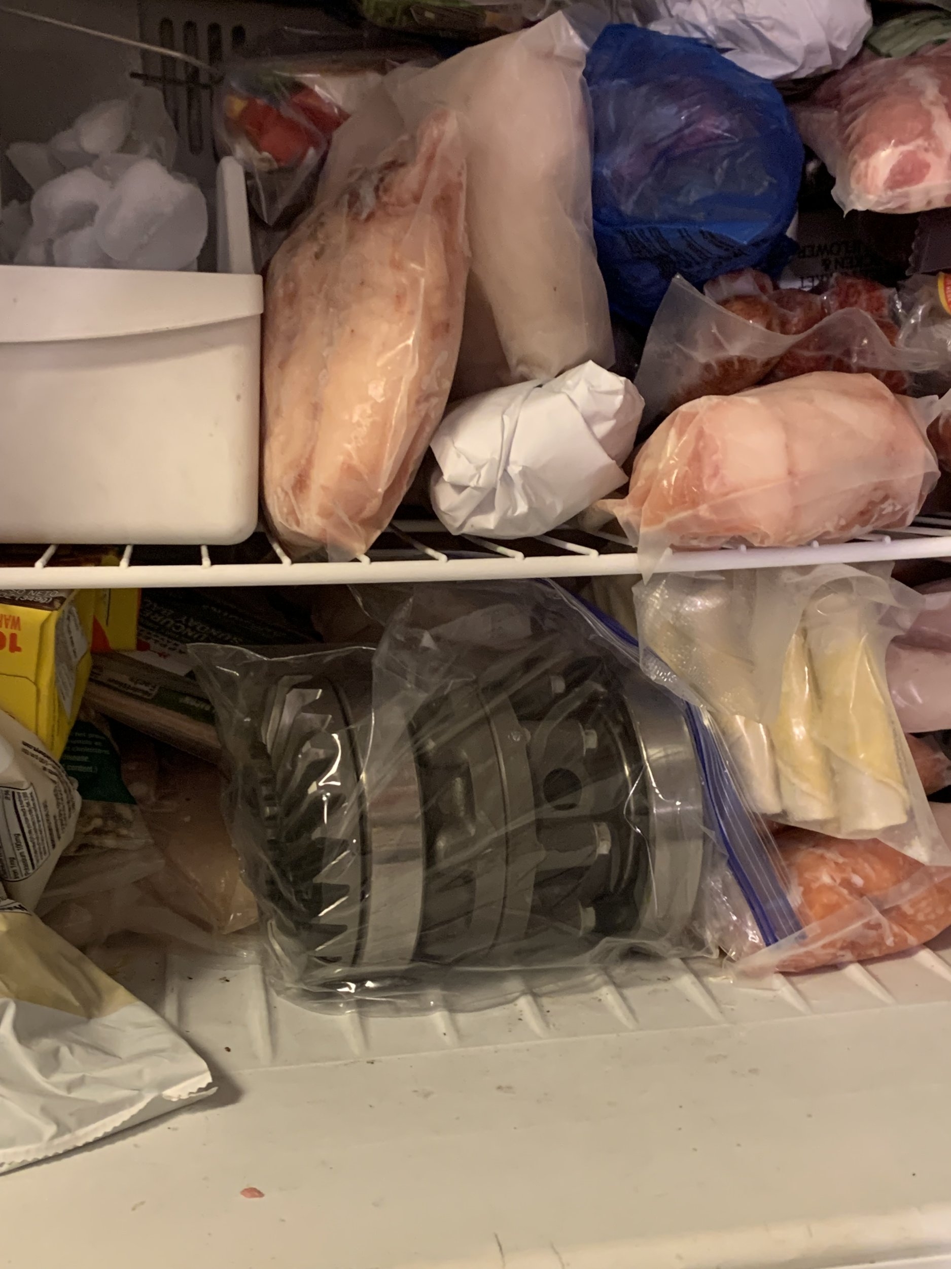

And putting the diff in the freezer overnight and using heat gun to warm the housing really helps. It dropped right back in.
My brother was a big help.

I hope it lasts for you. I feel like bevel mfwd axles are already a weak point on compact tractors from fel related stresses and I personally wouldn't consider this except on a heavier planetary gear unit.
Thanks for sharing the pics/install.
Let us know how it works/turns out
