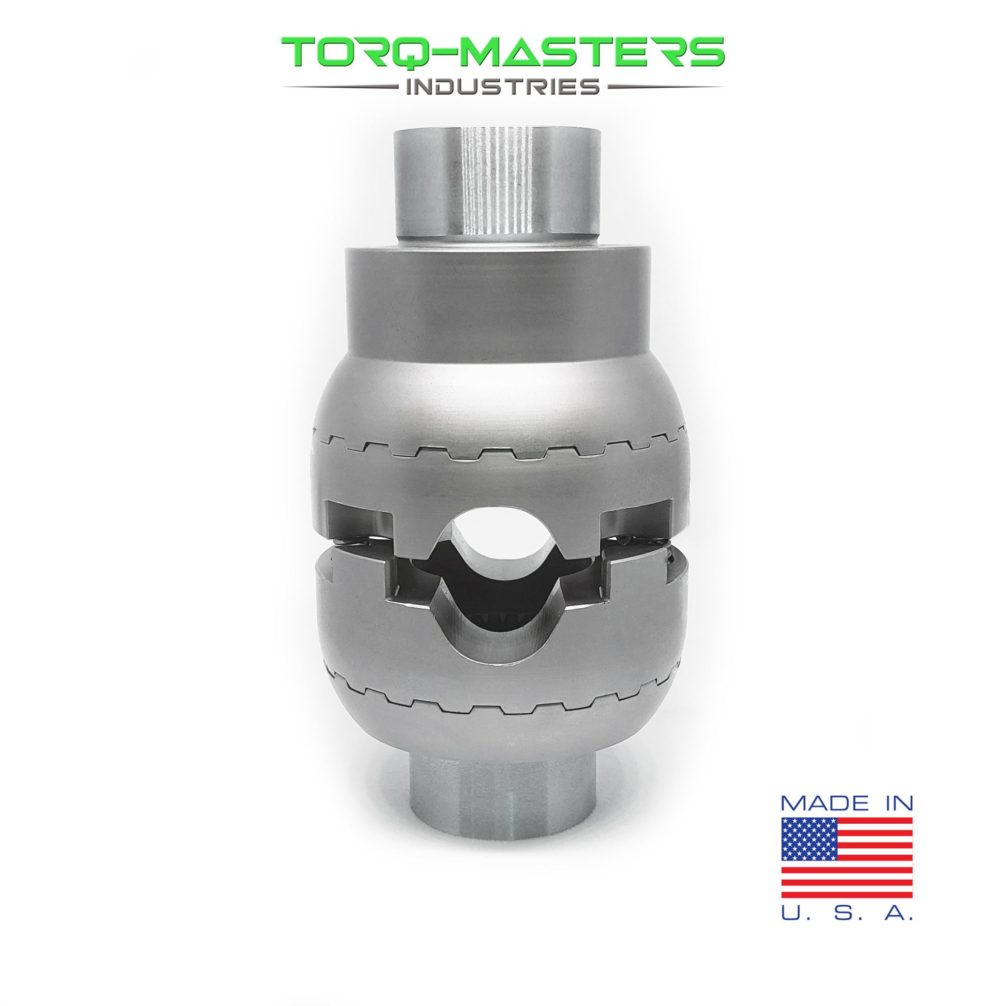

mopardude318
Platinum Member
Mar 22, 2017
749
Hollister Ca
Kubota M7060 HD12 Oliver 550

Biggest difference is on hilly ground. All I have and tractors stay in 4wd. Normal differentials deliver power to the wheels with the least traction. My old M5030DT had a automatic front locker and great traction. Newer L3830, M59 and B26 do not and will spin out.
/ Front locker available for Kubotas #4
Several years ago I ran one of these in a Jeep axle. Worked okay. Some quirky side affects. It applies itself when power is applied. The spider gears are removed. This unit goes in their place. When power is applied the spider gear pin going thru the center forces the notched pieces outward and causes engagement. So every time you apply power, it's locked.
Imagine this. Slick conditions. FEL bucket full of material. 4wd engaged. Front wheels turned for sharp corner. Add power. Unit engages. Front wheel on inside of turn needs to travel "X" distance. Front wheel on outside of turn needs to travel "Y" distance. Locker says nope, you both are going to travel same distance. Something has to give. First thing it will try to do is straighten the front wheels. Next, one tire has to skid, one has to spin.
For this reason I quit using it. Extremely stressful on axle components. Severely limited power turns.
Contact Kubota and see what they say. :)
^^I agree 100%^^ Great for mud or rock (wall) crawling but is a pain on pavement. Will you scrub one tire in places you don't want to, like your yard? Will the bevel gears at the front wheels handle the extra torque? Trying to turn on pavement with the bucket full would test the parts!
Also, will it help or hinder snow plowing in icy conditions?

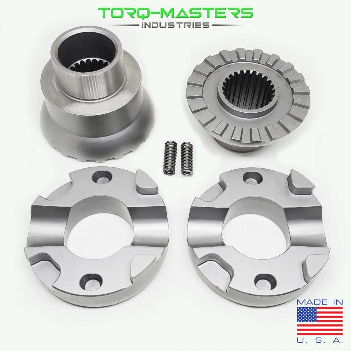

An autolocker of this style "should" allow freewheeling of the outer radius wheel in a turn so in a left turn, left wheel does "X" revolutions, (directly related to tailshaft driven speed), right wheel needs to go "X" times say 1.5 revolutions, so it freewheels faster than the driven speed. However, the design ensures that at no point can either wheel go a lower speed than the driven speed, meaning if the outside circumference wheel had solid traction and the inside wheel does not, the insid wheel will turn at the same speed at the outer, meaning it will speed up/slip, IF the driveshaft is demanding it to, meaning the drive on the rear will be slipping as well.
/ Front locker available for Kubotas #10
Nope.
/ Front locker available for Kubotas #11
Simple explanation of the Aussie Locker operation
The Aussie Locker mechanism allows a wheel to turn faster than the speed of the differential that is driving it (differentiation), but never allows a wheel to turn slower than the speed the differential and engine is turning it (traction). Therefore, a wheel cannot ever stop turning if the engine is driving it, but in a corner it can be forced to actually turn faster. Unlike a standard differential, the engine can never drive one wheel faster than the other.
Depending on the situation, the locker can either uncouple the driving gears i.e. if the differential force is acting on a wheel to turn it faster than the wheel is being driven by the differential and engine, then that side can freely disengage and unlock providing differential action.
Simply not true. Study the pics in the earlier post and it becomes more obvious. Note the sloped cut of the notches. As long as power is applied neither side will disengage.
To make a short turn required applying power to get speed. Then let off throttle to disengage. Then make turn while coasting. As soons as power is resumed it locks up.
Manageable on the highway. Not convenient for a sliw moving tractor.

As my post was quoted from the manufacturers website, I'll let you take it up with them.
In the middle of their lengthy description of it's function they inserted their "out". "Depending on the situation". Interpretation is "off the throttle". Then it unlocks and ratchets. The small push springs unlock the side gears unless power is applied thru the spide gear pin to push them outward.
/ Front locker available for Kubotas #19
I did not understand their description and how it related to constant pulling or pressure like tractor use would be. Their description of a wheel spinning faster than it is driven would be like descending during rock climbing.
