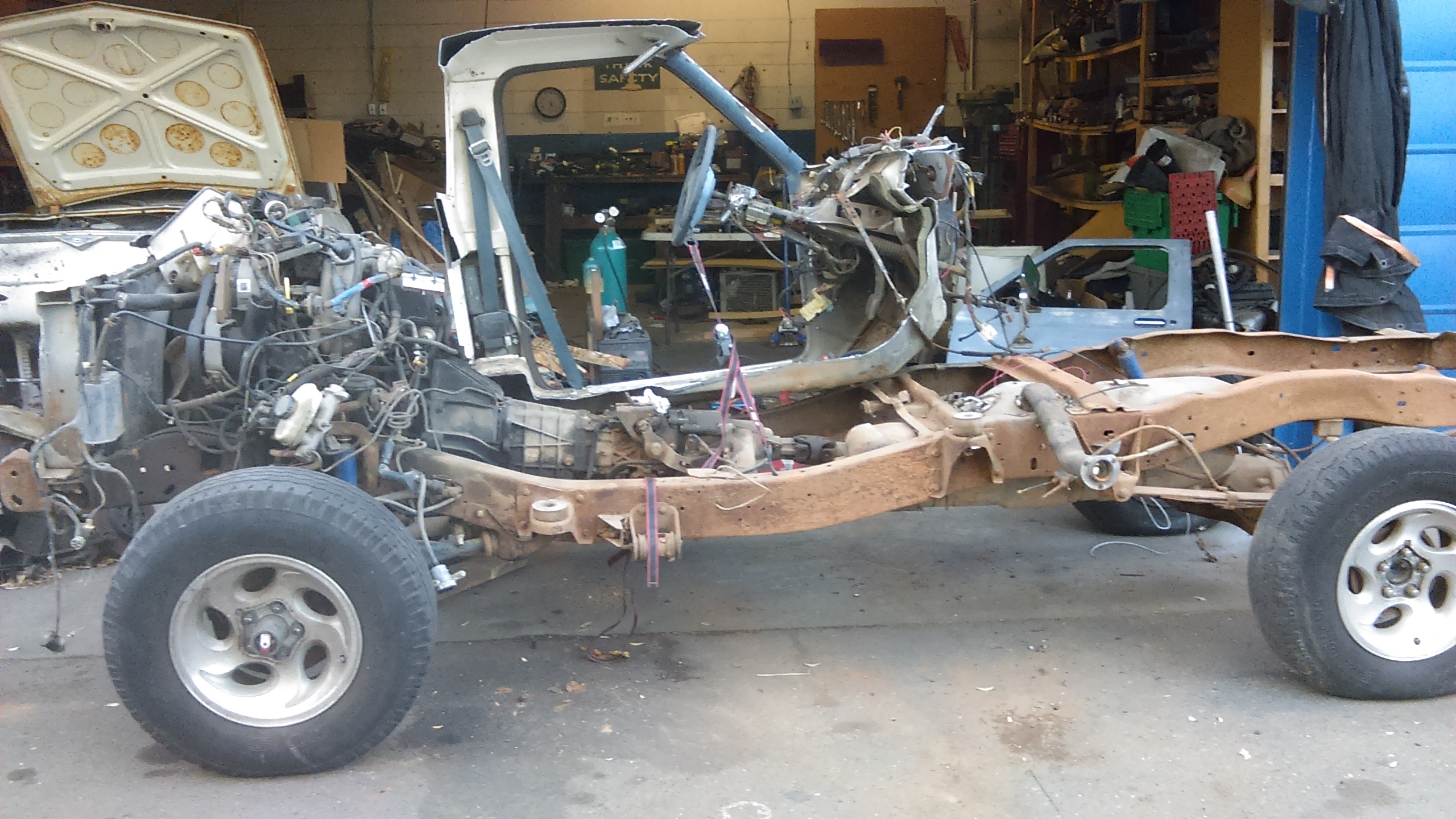

I replaced the starter and tried to get the engine running. The solenoid was bad too, and replaced that. The fuel pump wasn't working, so I wired it directly,
and discovered the fuel line was spraying everywhere. Seems a dog had chewed on it, so fixed that, but still not running. Had spark, starting fluid got it to run a bit.
Was going to check if the injectors were working, but then I found what looks like my mistake with the cutoff tool I cut all the wires to the ECM. Oops.
So decided to just move on and get running after I reconfigure it. So stripped the cab down and removed it from the frame and cut it in half, and got it mounted
onto the frame to see how far the rearend can be moved inward. Here is a pic of that mockup. So the leaf spring mount works great to put the leaf spring plate on after
I cut it up sufficiently. That was all mocked up, now ready to weld it and get the rearend back on, shorten the driveshaft.
Next up I will go back to getting the engine to run and fix all the broken wires. I was hoping to just trim back all I don't need while it was running, but now I'm going to need
a wiring diagram and wire up just what I need to make it run. These older vehicles have simpler EFI systems, so shouldn't be so hard.

Here it is with the frame cut and axle attached. Got the driveshaft shortened. Going to mount the fuel tank
in the back, and work on wiring to get engine running.
