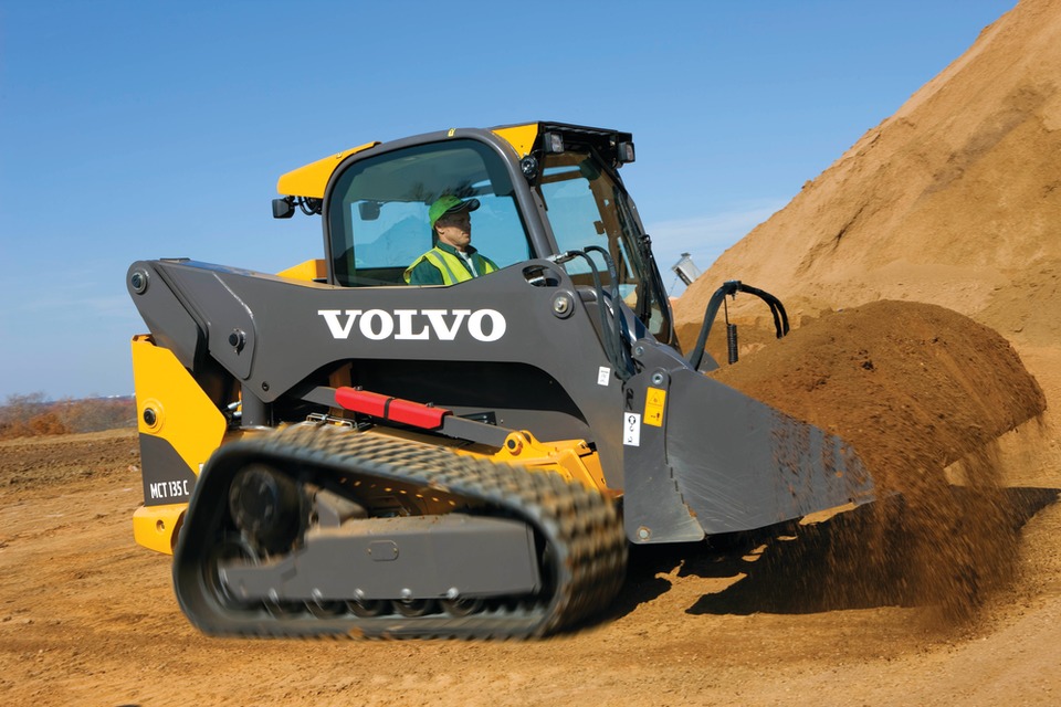

The loader will be a one-arm bandit, like this Volvo loader:
