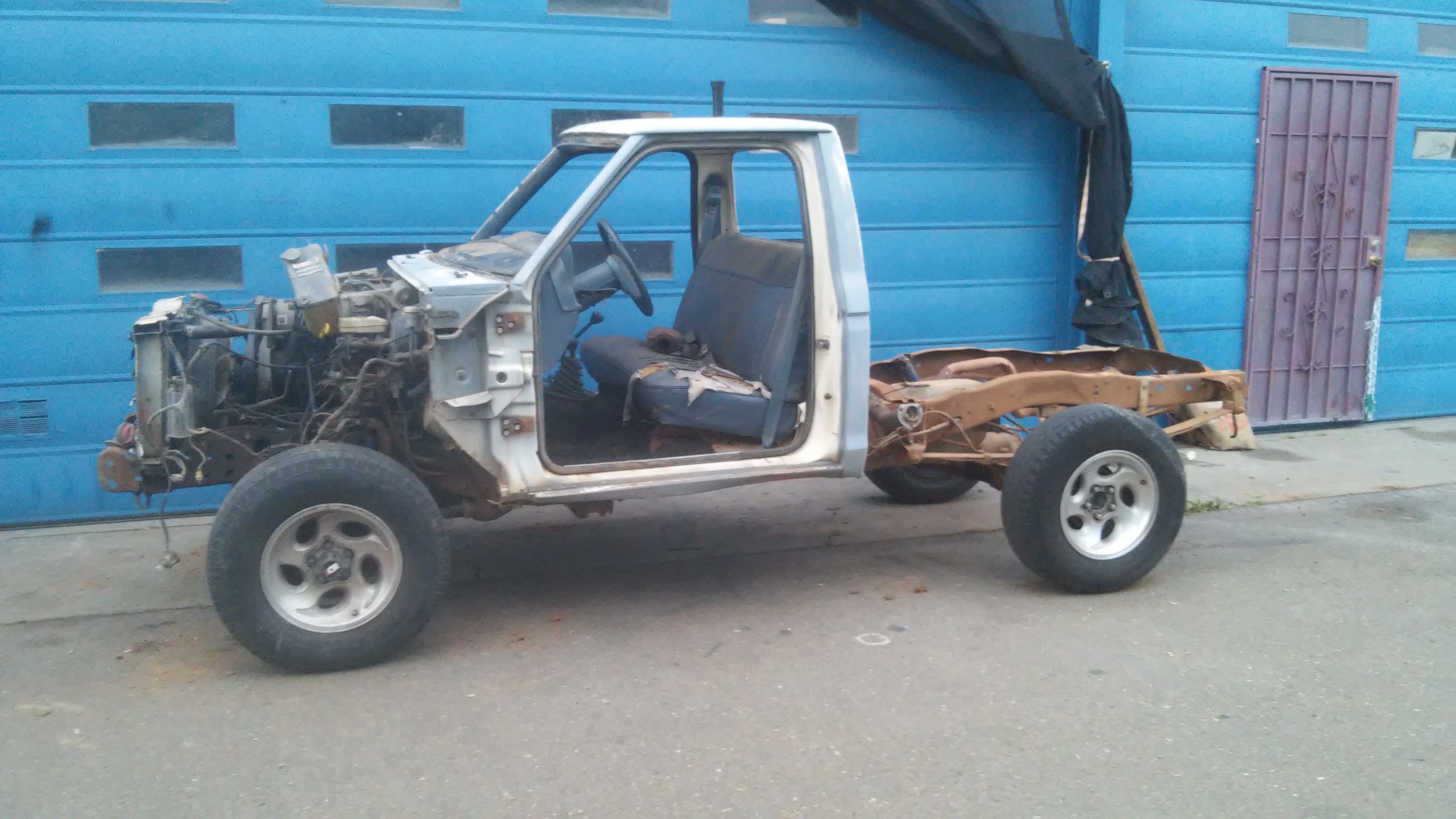

/ Front Loader from a Ford Truck #44
That looks like a nice truck. Don’t butcher it for this project. The cylinder in my dump truck is like a 5” cylinder. It’s pretty slow. Like 30-40 second cycle time. Where are you located?

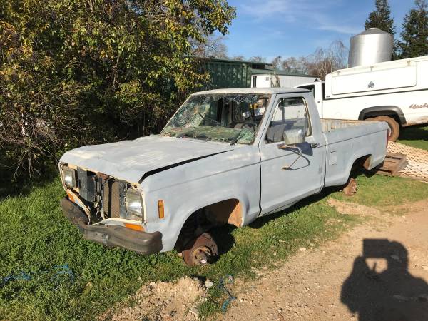

Doesn't run, has more than 326,000 miles and has the dash torn apart, no ignition, and no title..I think best bet is try to part it out. Sacramento, CA
/ Front Loader from a Ford Truck #48
No title puts a damper on the spirit. It’s worth more parted out than what it’s worth in your loader. Why not use that truck for the loader project. It’s probably equivalent to a F-450 or F-550 and seems like a more suitable loader platform.
