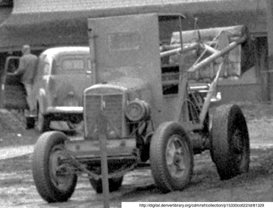

This sounds like a great project. Hope you can do it. The kind of machine you are talking about building hasn't been done often, but any mechanically oriented farm kid has seen or heard of something like that. During a decade of migratory farm work I might have seen half a dozen variations on that idea....and that was half a century ago & more. I never had the opportunity to really study one or work with it, but they do exist and I've seen them in action.
Some explanation is in order......I grew up traveling with the grain and fruit harvest. It's a gypsy kind of life. We were called "Harvies" & often worked for the same farming family year after year. Sometimes we worked directly for the farmer, othertimes we worked for a custom cutter or picker. If you are country, you know what I'm talking about.
So I got to sleep in a lot of barns, see a lot of farm machinery, and marvel at farmer-designed inventions.
Even as a young kid I was known to have a knack for machinery, so earned extra money on rainy days fixing things and doing maintenance.
Using a truck backwards to make a maneuverable loader was not common, but it was something that I remember seeing every once in a while.
What struck me at the time was a couple of things. One is that the lift arms often had very long cylinders, another was that it wasn't uncommon for the entire loader frame to be made of welded and bolted metal pipe. Another thing that I wondered about was that nobody ever seemed to refine their design once it was built enough to work. It was the rare farmer who ever used even elementary physics or math; most just went with instinct and used what they had laying around. I remember the ones who did plan more completely though, because those were the ones who would often invite me up to the kitchen where we would eat pie while they explained their drawings. Wonderful times.

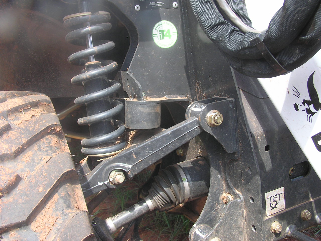

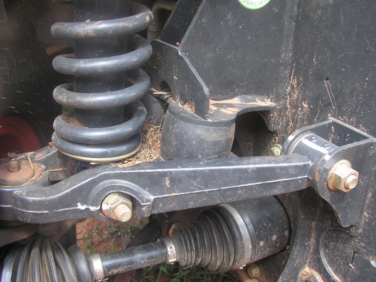

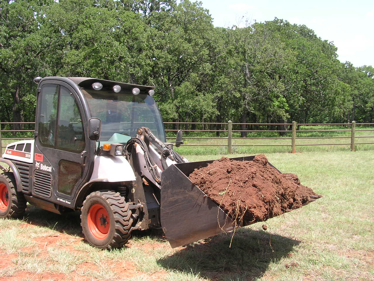

I like that Bobcat with the single arm loader with the telescoping arm, what a nice design.

An interesting project, gonna be keeping an eye out for updates. I've always wanted a Toolcat, just not fond of the pricing and complexity of the machine.
