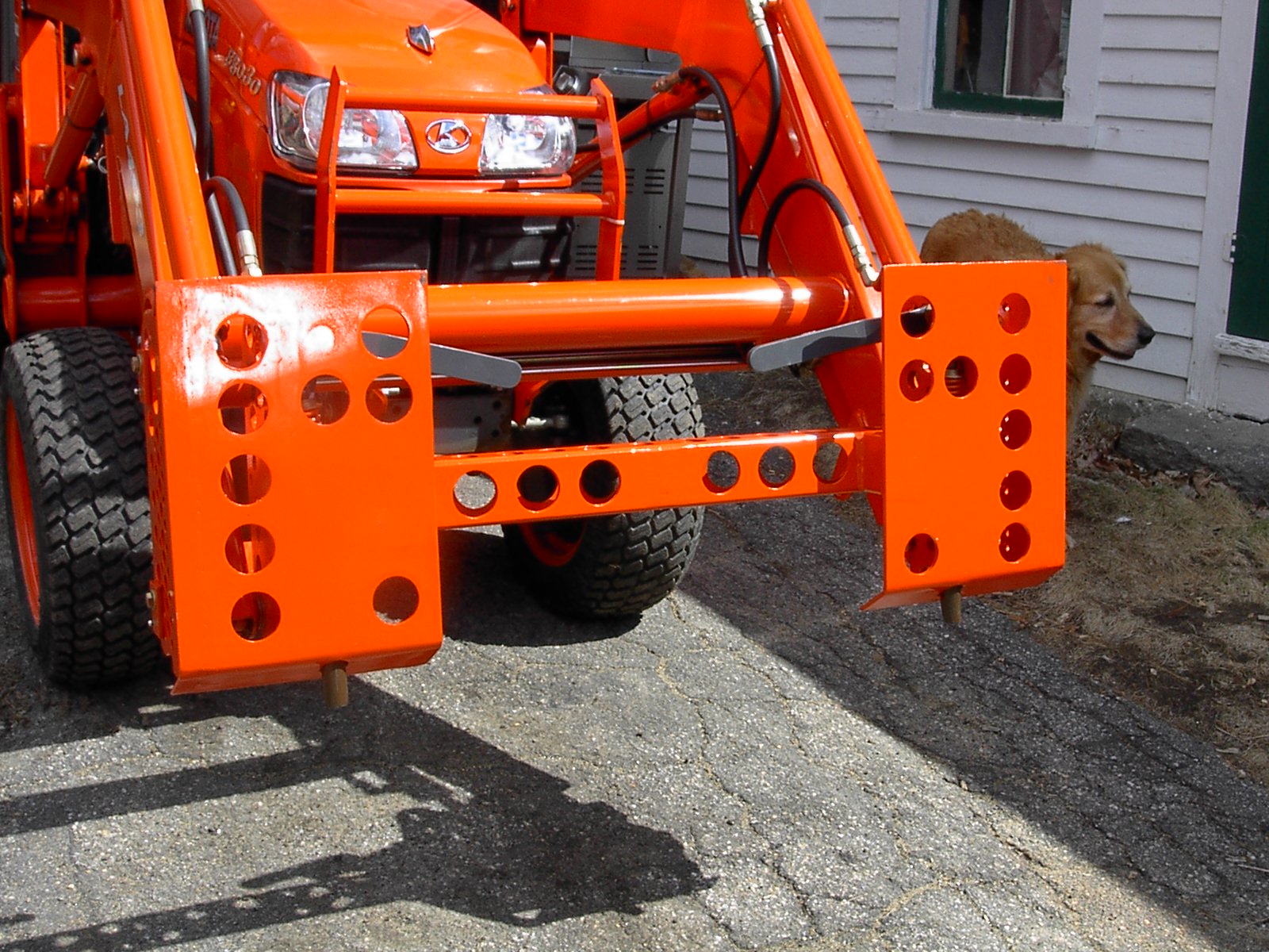

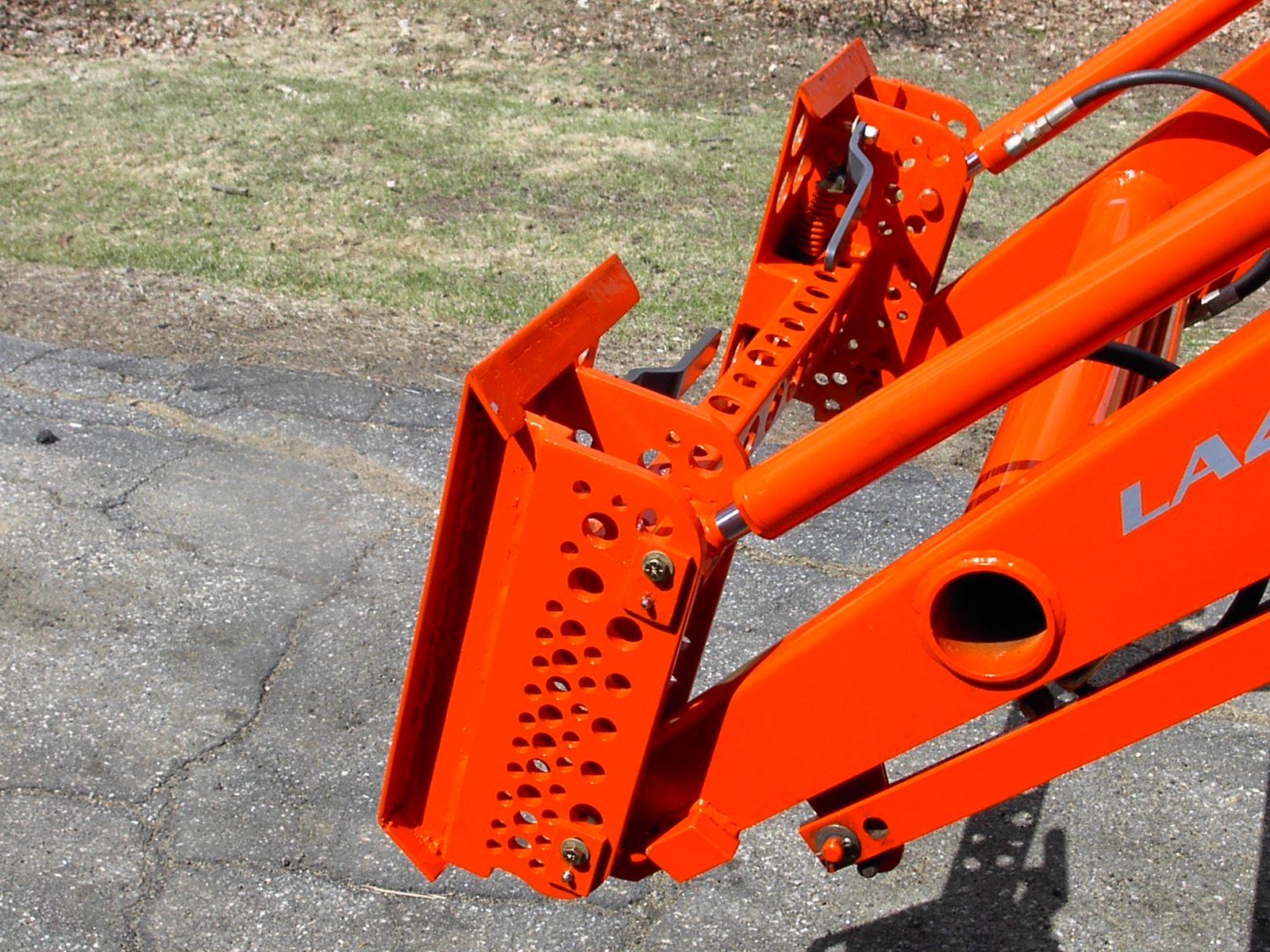

I have one also, and now couldn't live without one. I will caution you, however, that just because you can attach it to your loader doesn't mean your tractor can use it. Generally speaking, SS attachments use ALOT of hydraulic flow (which most tractors can't match) and are built to take abuse from skidsteers (much too heavy to effectively use on a tractor).
But with all that being said..... they are great for changing from bucket to forks to grapple, etc.

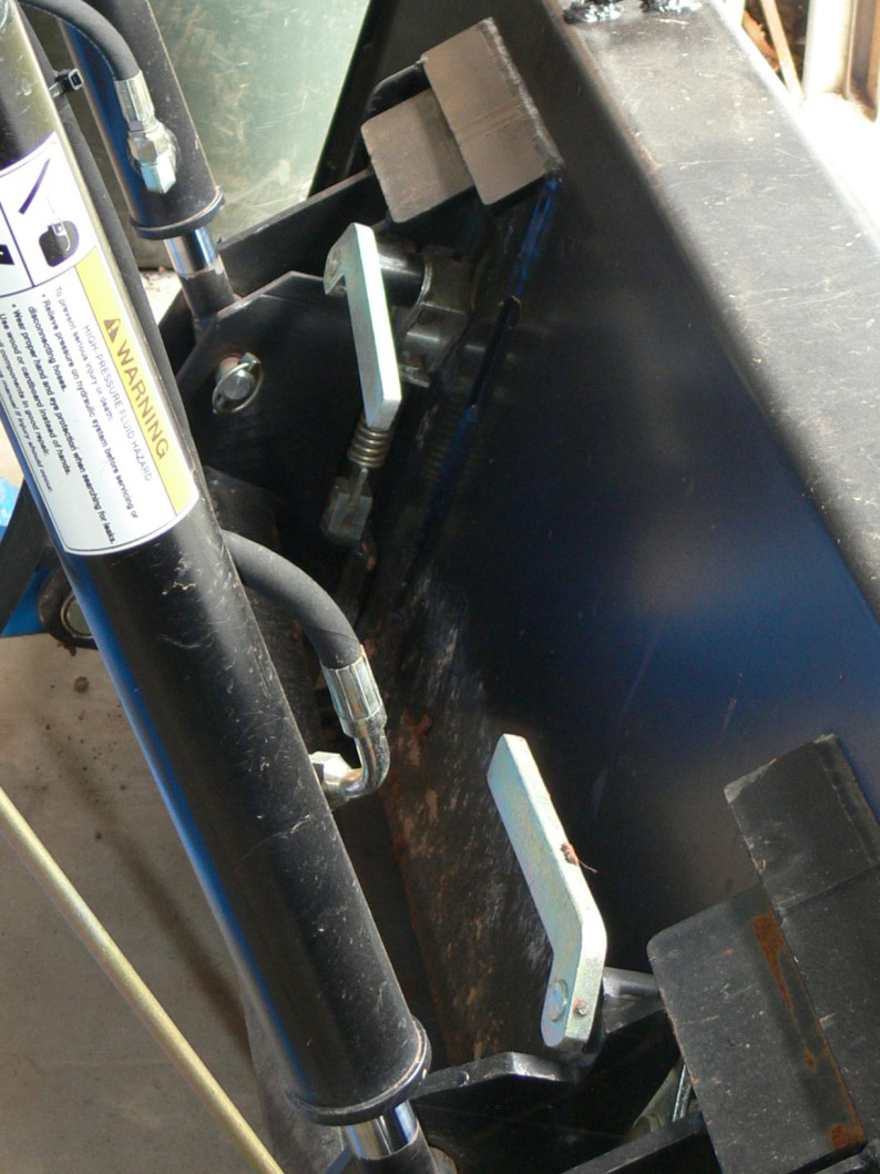

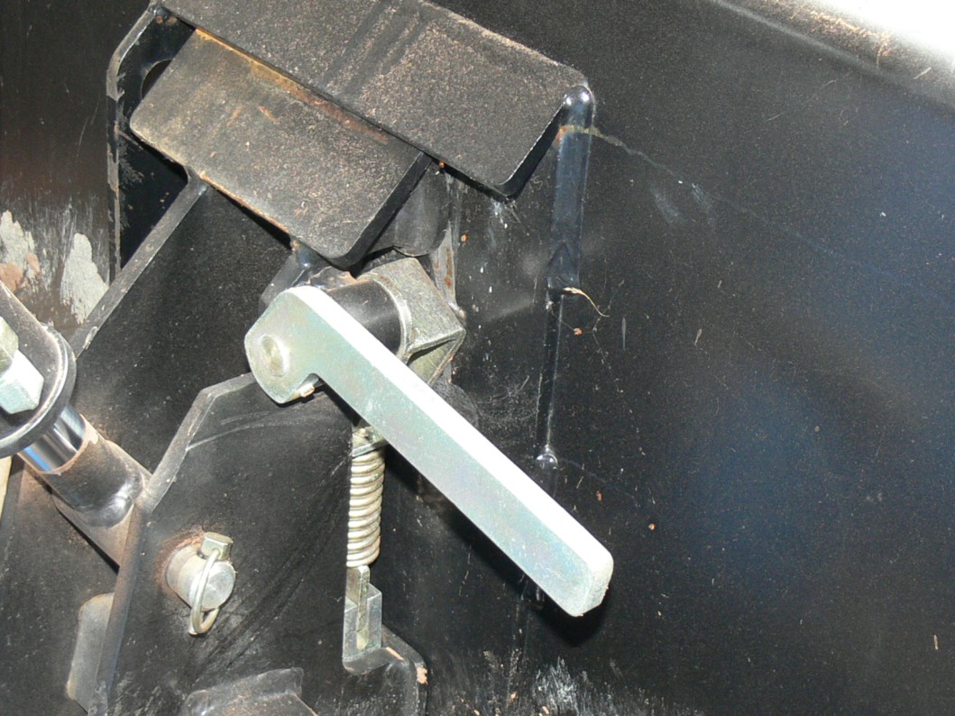

I have that on my Landini (Korean LS tractor) - likely identical to the one you saw. It works beautiful, no problems. Takes about 15 seconds to drop the bucket. :)
