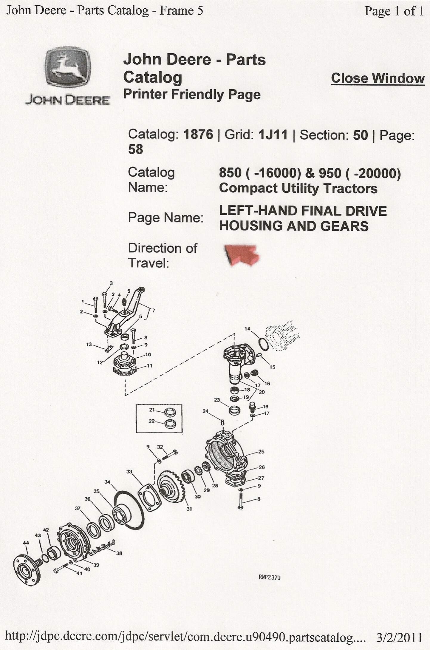

Does the front knucle seal usually require a bearing replacement? I am going to repair a badly leaking seal and notice some play in the l\f knuckle and wonder if the bearings are worn ? Is this is difficult or rather easy repair ,its a 336d
Thanks !!
/ Front Knuckle seal #2

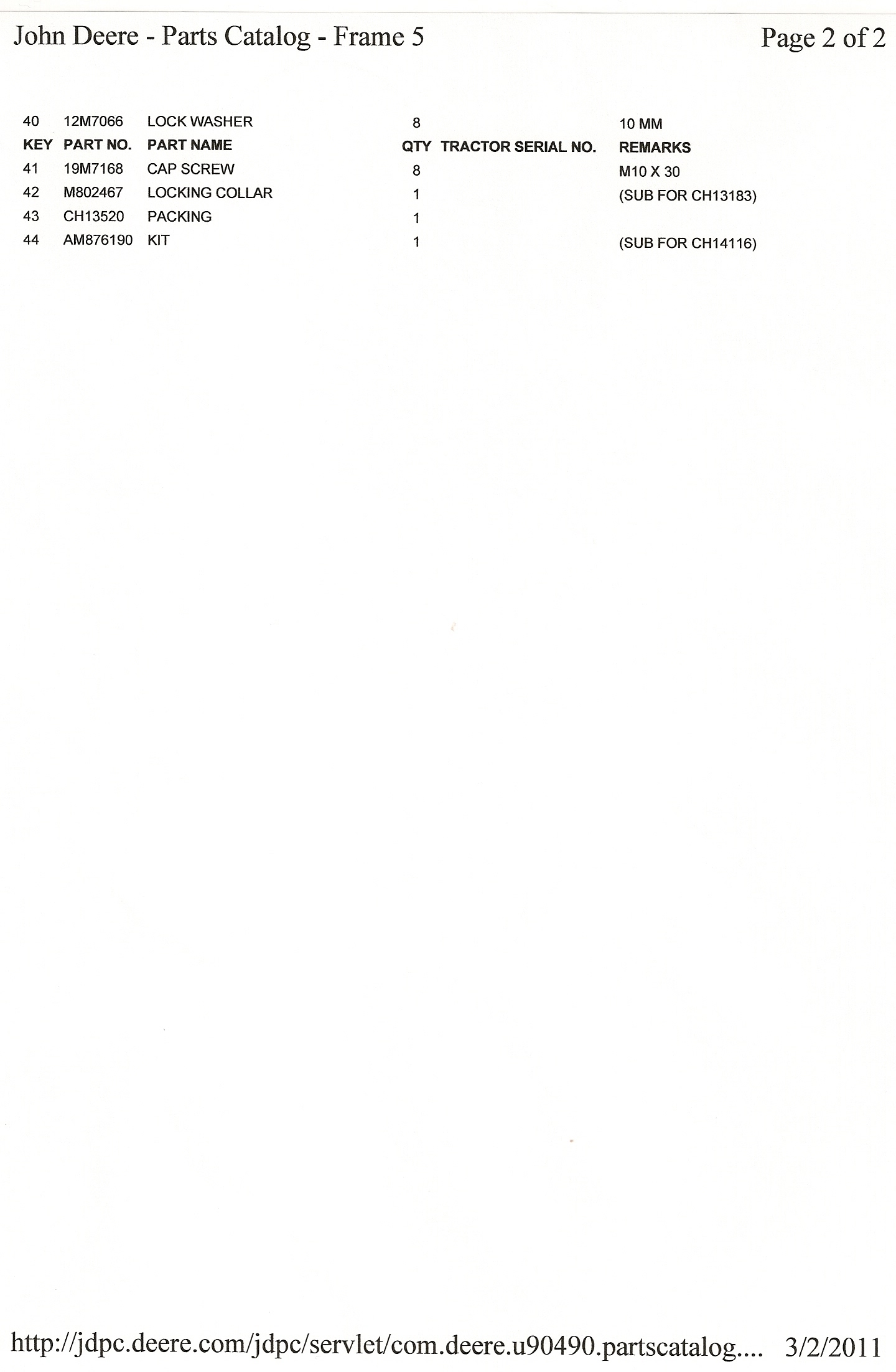

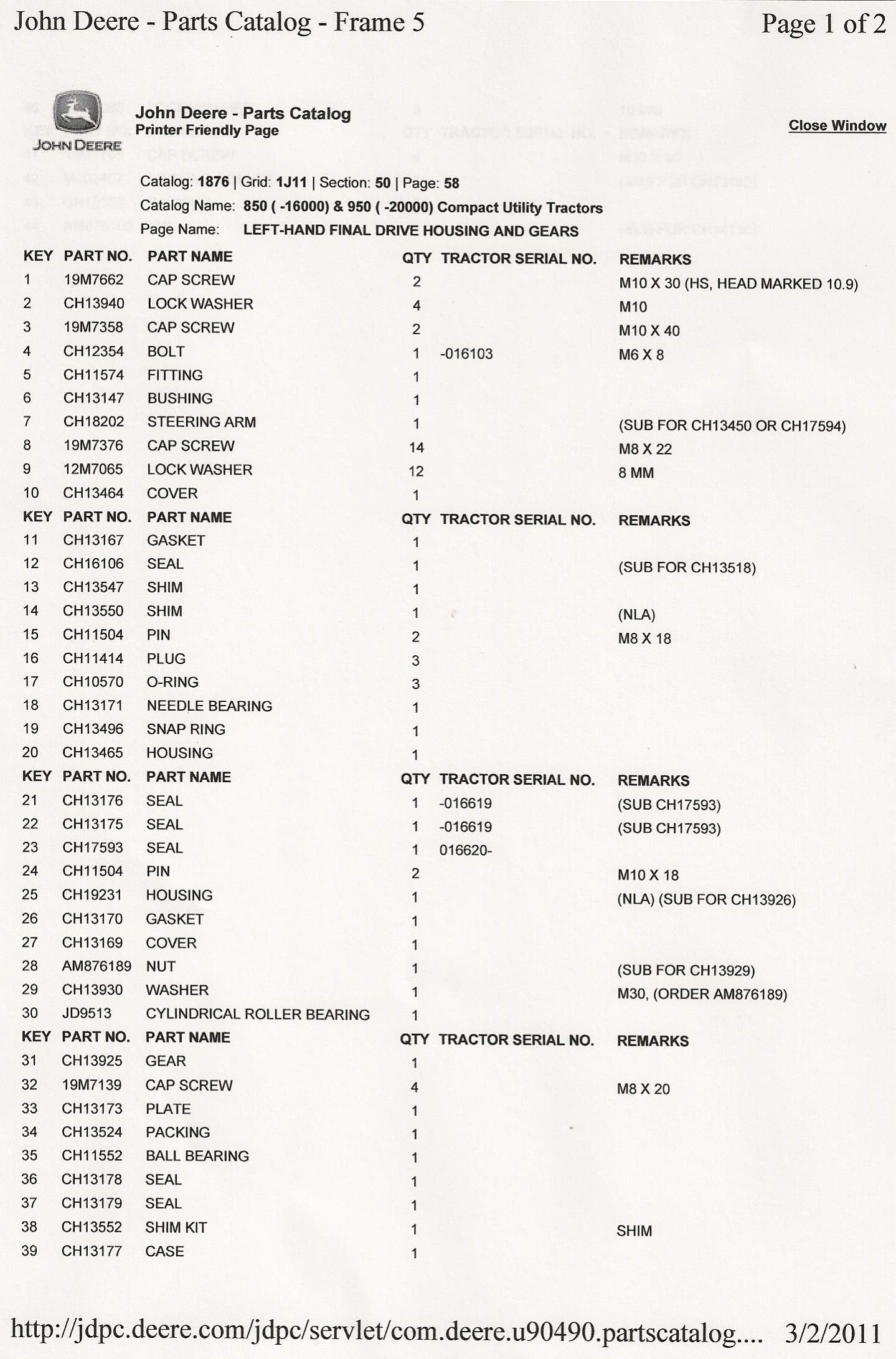

I have changed the seal on my ym2002 but it is a little different than yours. I did not have to replace bearings. I think on hand inspection would be the best determining factor. You may have a manual. Will try and post pictures on a JD 950. Suspect it is real close to your 336.

Usually, if you just have a leaking knuckle seal, you will not need to replace the bearings. But if your bearings get loose it can cause the knuckle seals to leak just by letting them wobble around. We have the 336 4wd section on our website now so you can sort of see what it looks like inside (links below).
Internal
Yanmar Tractor Parts: 4WD INTERNAL
external
Yanmar Tractor Parts: 4WD EXTERNAL
