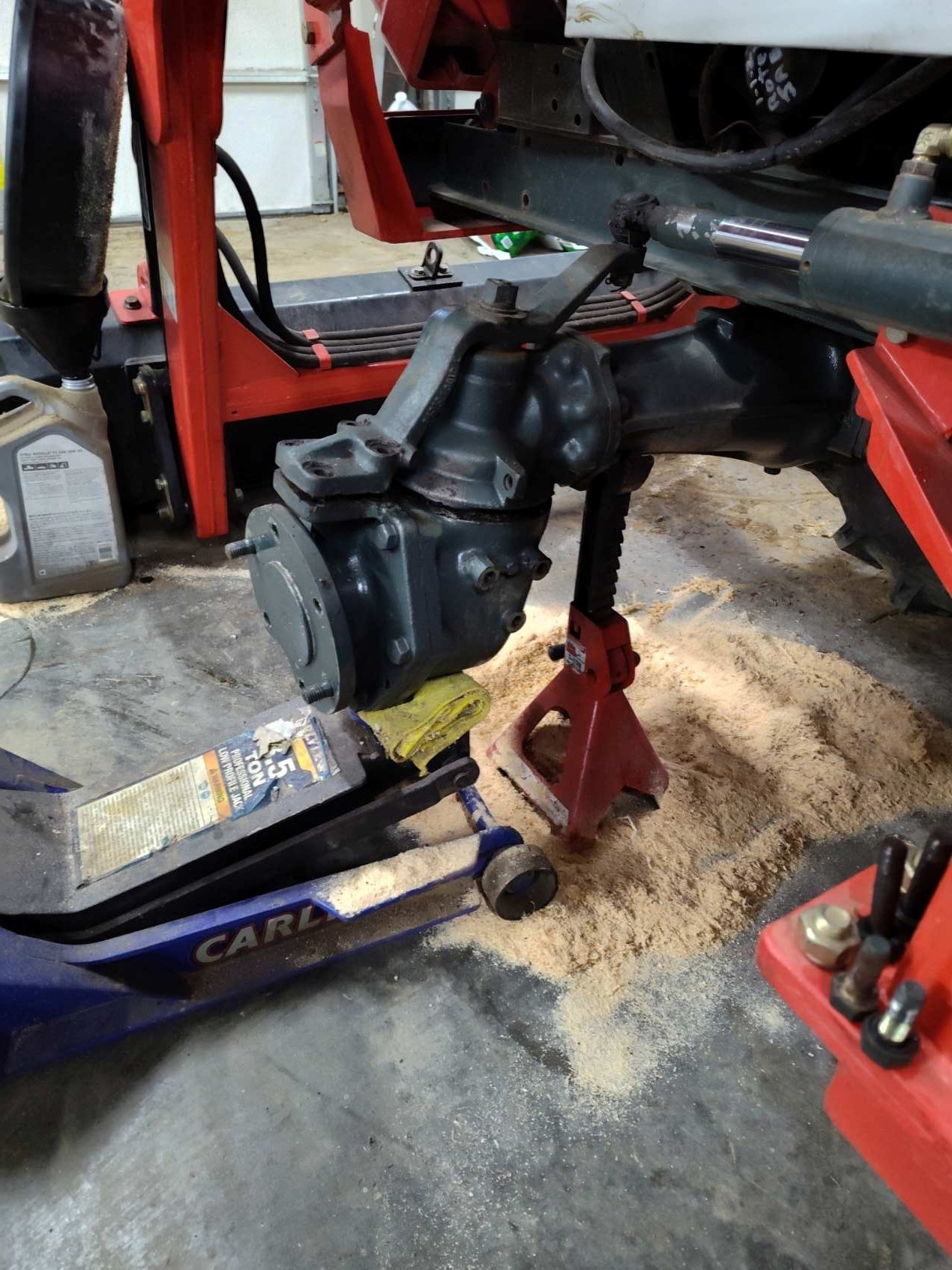

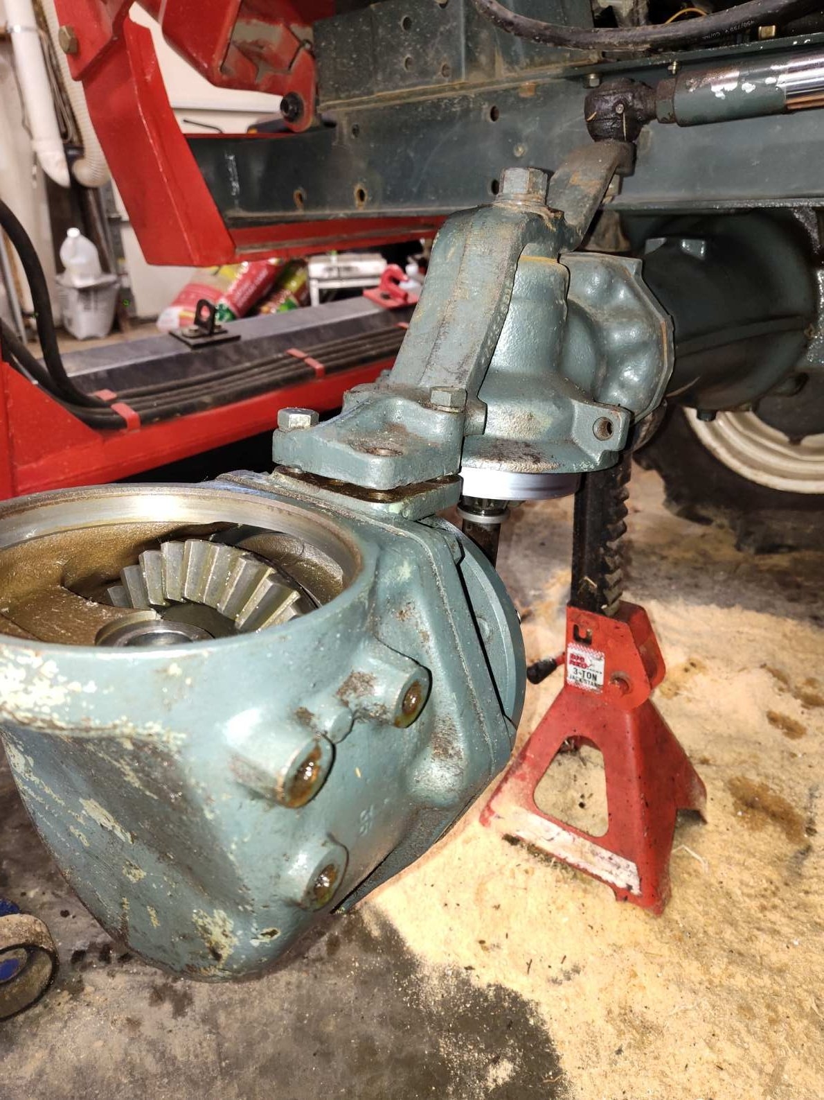

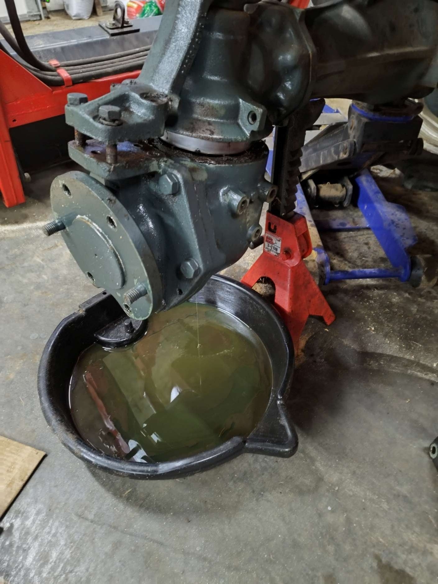

Ordered the seal earlier from Southern and watched a few video's and looks to be a straightforward process. It really just started and pretty much emptied the axle on the garage floor over several weeks, have not use since (annual monsoon's) so hopefully just a tired seal. The second video looks to be my setup.
/ 2310D Knuckle Seal Replacement
Came apart with little effort and cleaned up nicely and does not appear to have any surface issues. New seal here tomorrow or Tuesday.

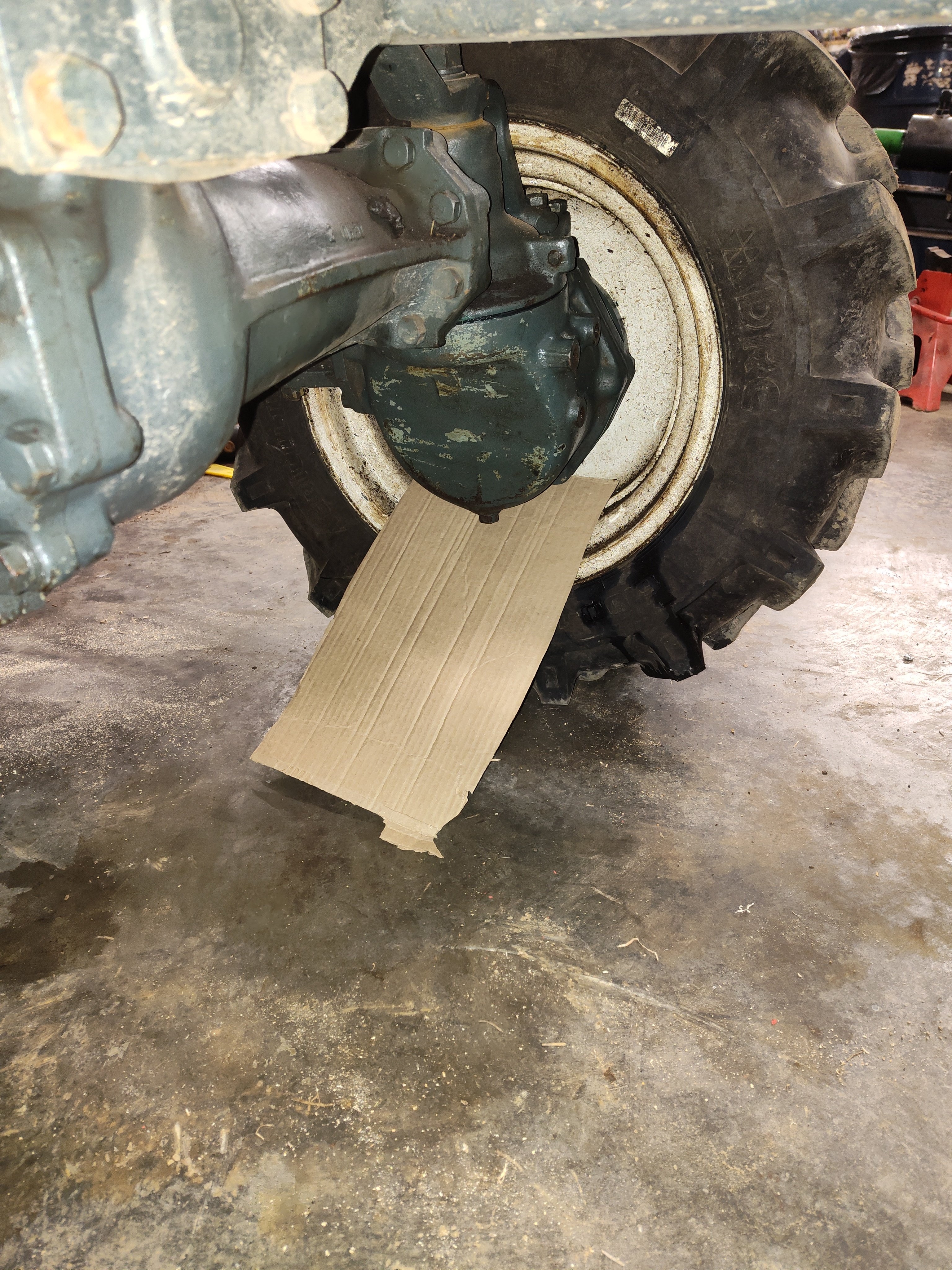

Well that was easy, new seal seems to have done the trick. Sat all night and still dry after a bit of a workout. I suspect it was just a substandard seal since the replacement had twice the structure....

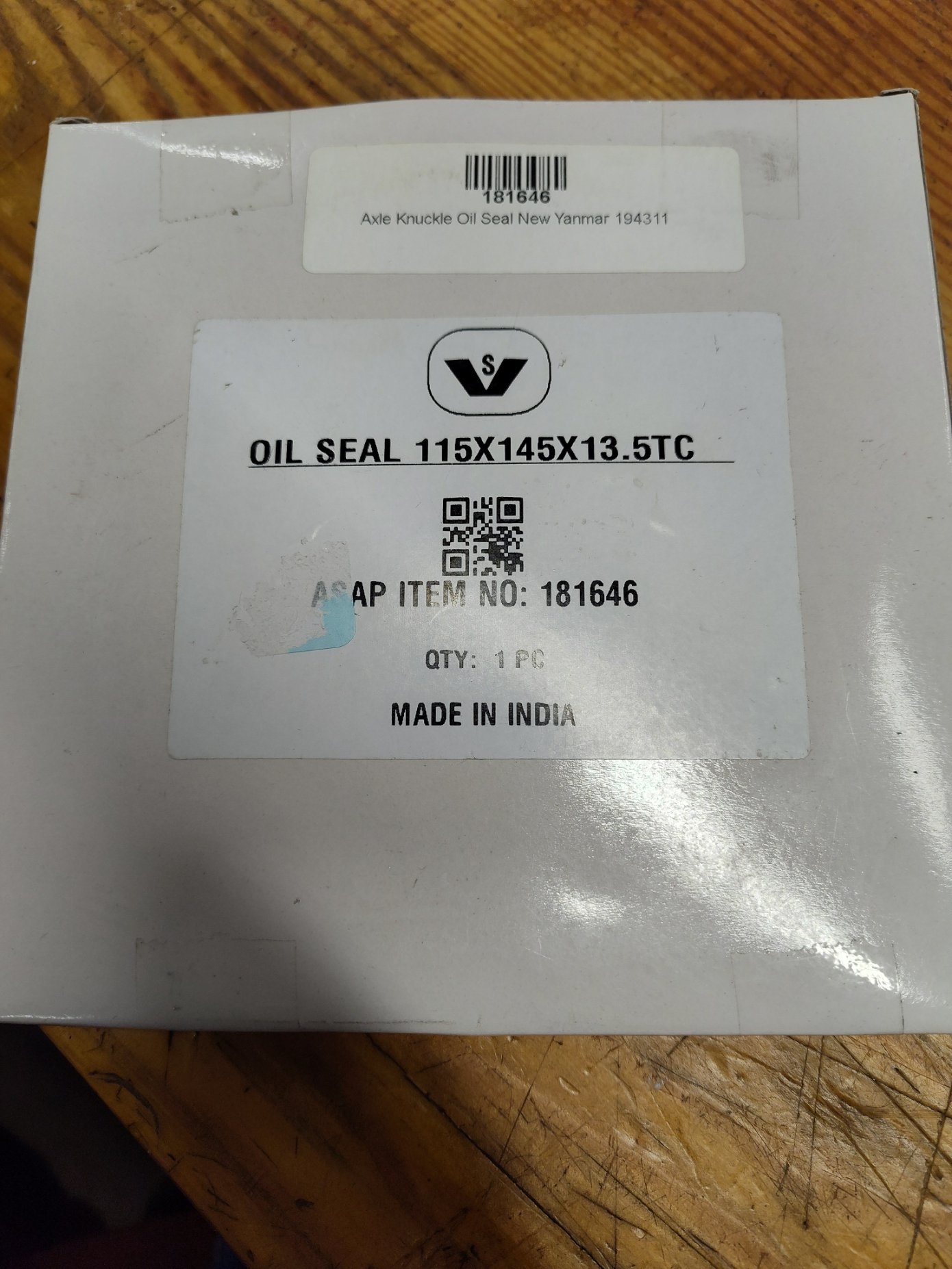

The seal you went with, was it one @winston1 posted or a different brand? IT would be helpful to let others know when this thread is read later on. (y)
As suggested.
