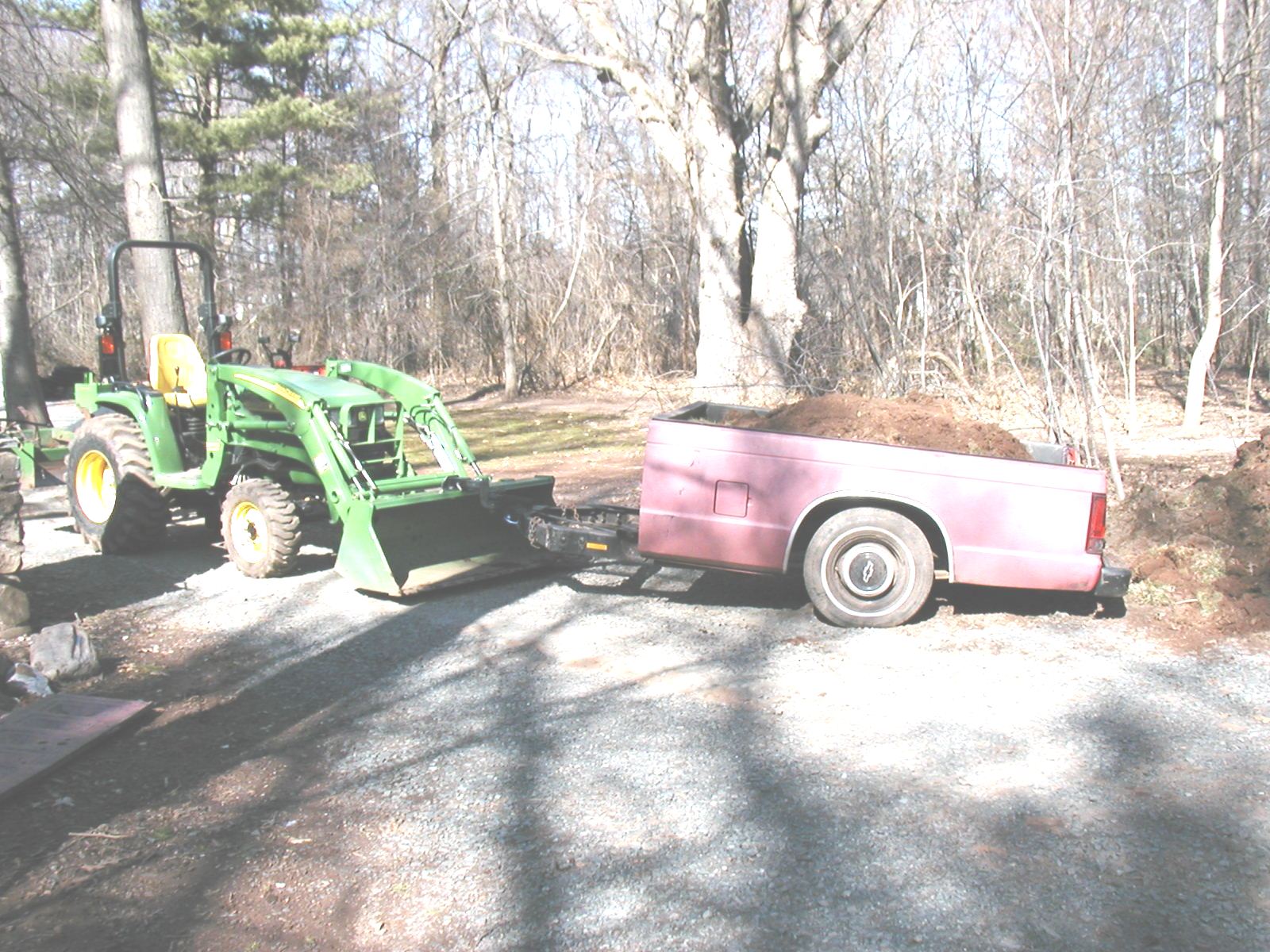

Except for the fact you say it might be a detriment maneuvering when the building gets full, I would say the loader mounted hitch would be the best/quickest way to snatch a trailer and go. with a frame mount under the hood sight line you'll never see it and would make it difficult to engage couplers.
You could even get a simple electro coupler latch then you might not have to get out of the seat or have a second person involved (in the coupling stage anyway) A front mounted hitch is the way to go for ultimate trailer jockeying.
The only problem with the one shown here is it might be to high for boat trailers, and if you got a longer drop it might not be seen from the seat. You may be better off with a receiver mounted on the inside bottom of the bucket.
At least it would be easy to try the loader mounted hitch to see if you like it, the frame mount would be a little more involved, not much, maybe you could mount it to a weight bracket if you have one.
Good luck, JB.
