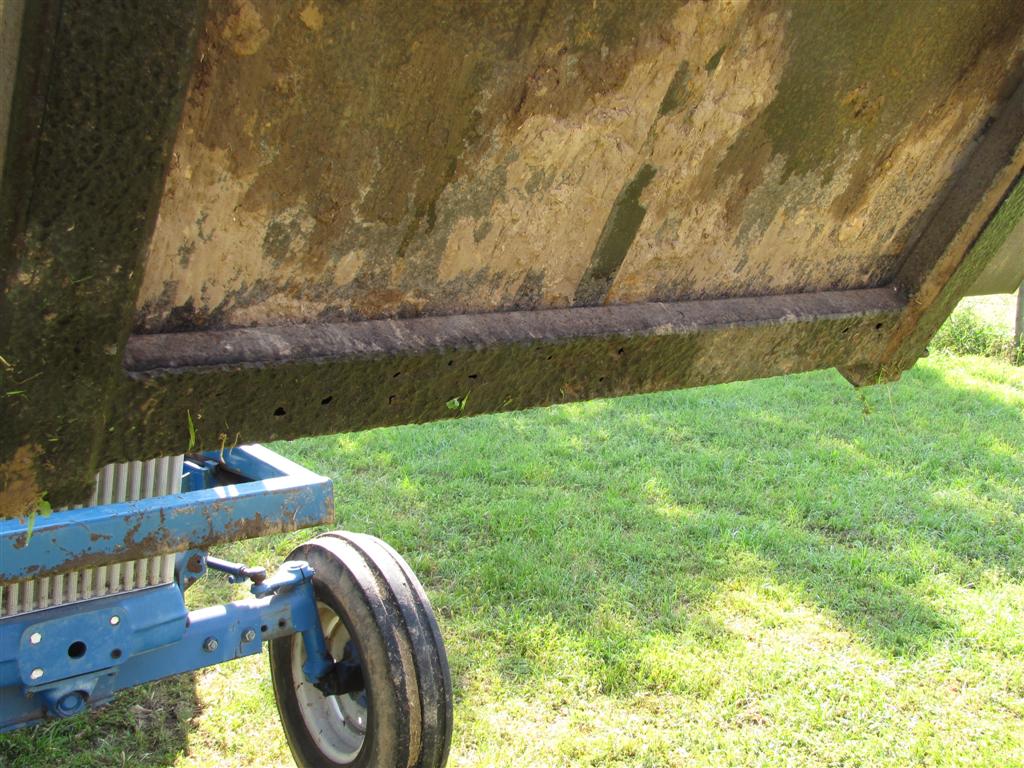

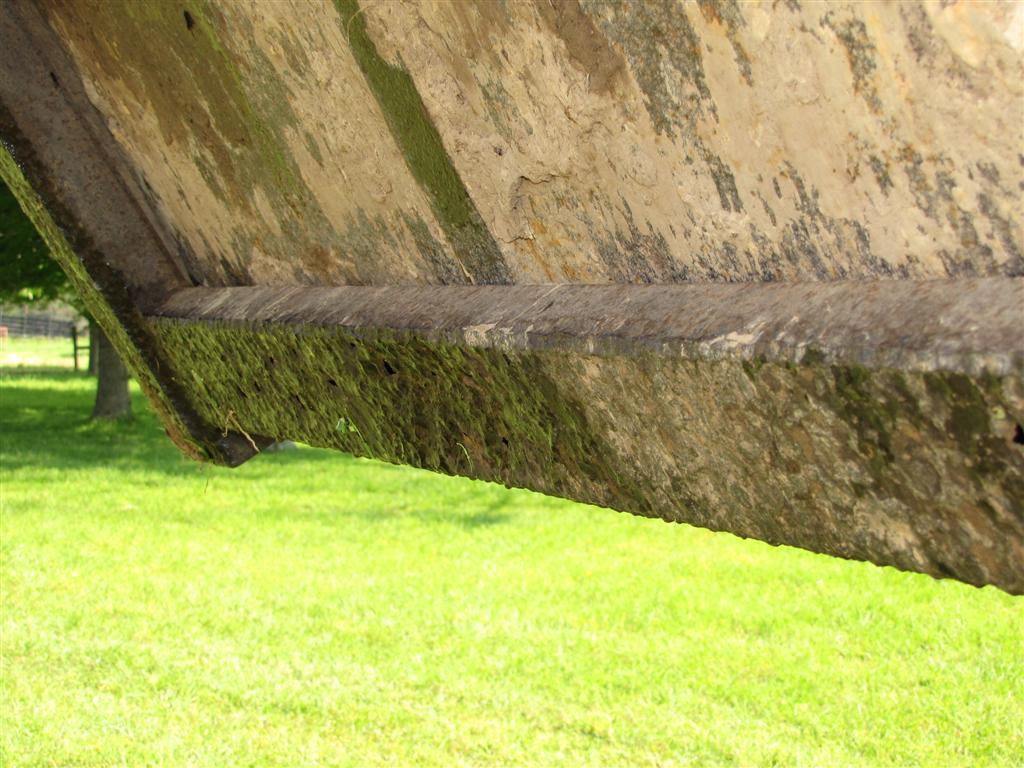

I have a bucket fork that is about 18 years old and has served me well. It slips on and off and is bolted at the rear of bucket. This weekend I discovered that the rear crossmember has rusted pretty bad. It has a few holes and the metal has caved, difficult to see in pictures, in spots.
I need to either weld a plate over or replace the crossmember. Replacement is best but I would have to find a replacement piece as I know I do not have any in stock. This would give me another few years of use.

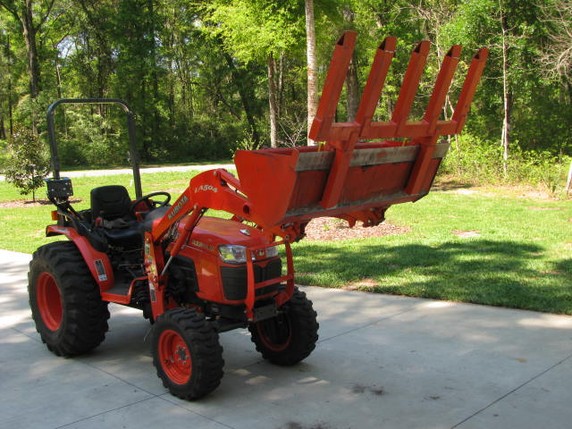

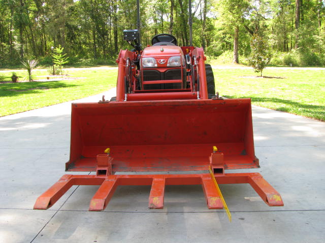

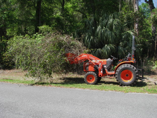

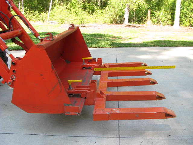

Attached are photos of Payne's Clamp-On Debris Forks in Aluminum. Pricey @ $775 delivered but they work great. Only fifty pounds. Here is a links to Payne's web page, which is out of date. Call and they will readily tell you they have both steel and aluminum debris forks.
Bucket Solutions also offers clamp-on debris forks.
Paynesforks.com - Tractor & Skid Steer Bucket Forks Attachments
Bucket Forks, Tractor Forks, Loader Forks by Bucket Solutions
I used the debris forks today to scoop up several big piles of brush and wild grape vines I had consolidated with the rake on an ABI Gravel Rascal. The arrow shape tips allow me to get under most piles and then lift them without getting off the tractor. With the big pile in photo #4 I did have to get off and tuck in "ends" before proceeding to the burn pile.

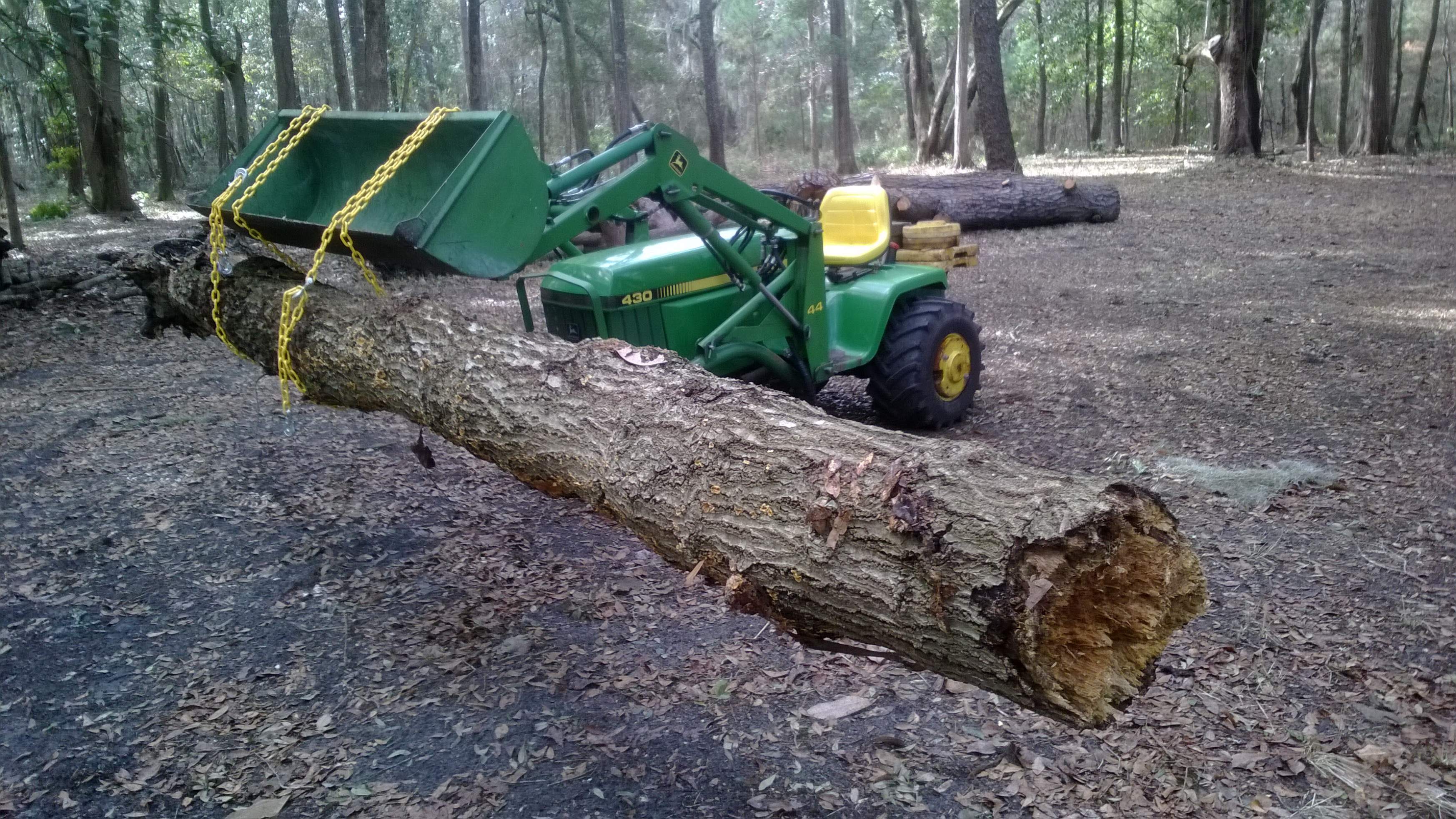

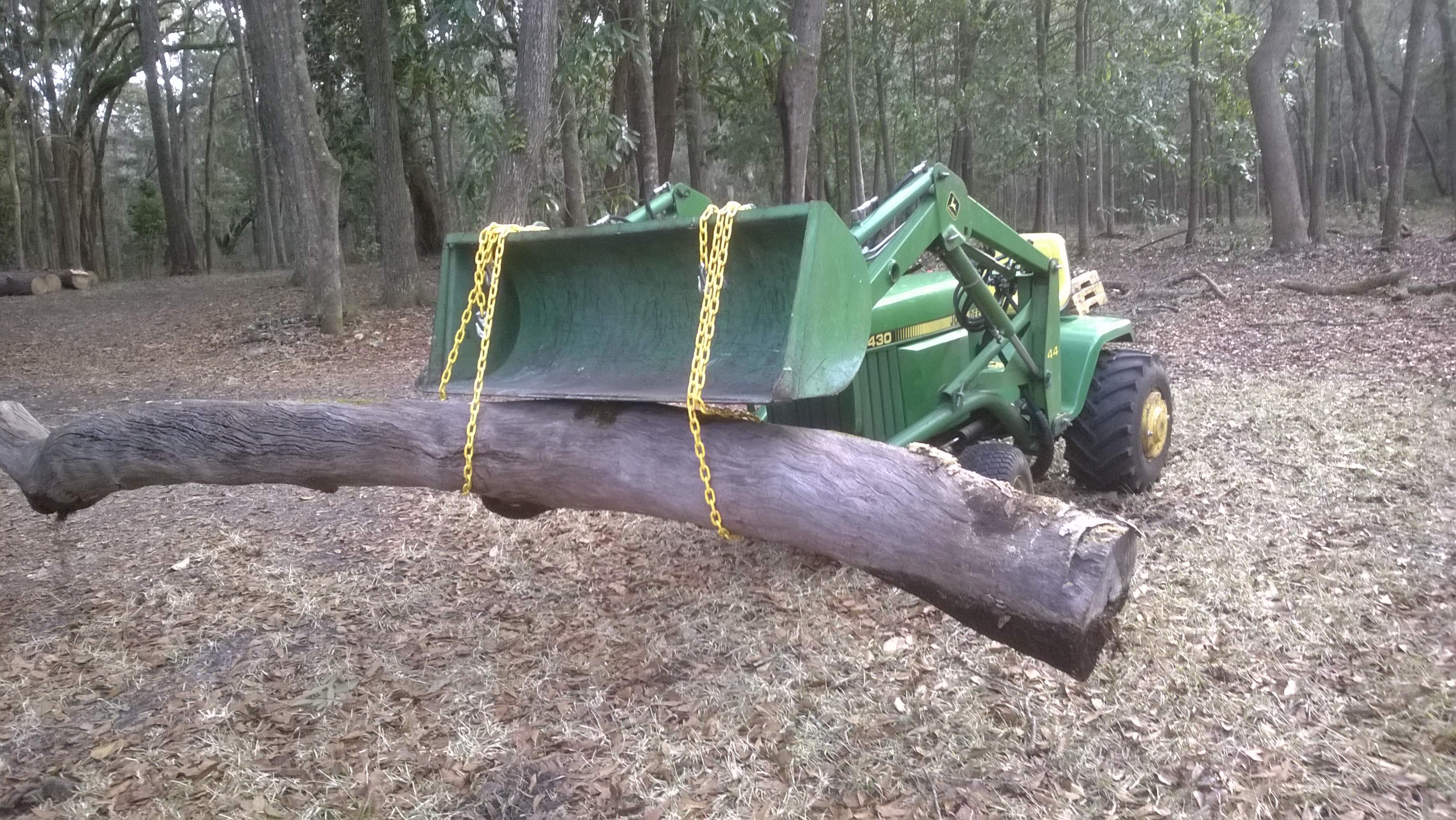

Keep in mind also having hooks welded to the top of your bucket can come in handy for lifting bulky items of course. I have two hooks welded on top, then use two chains with hooks at either end, has worked like a champ so far for multiple items. Longer the chains, the bigger brush pile you can lift. Just lay the chains out, pile your branches across the chains, then wrap the chains over and hook-em!140115 430 log haulin1.jpg140115 430 log haulin3.jpg
