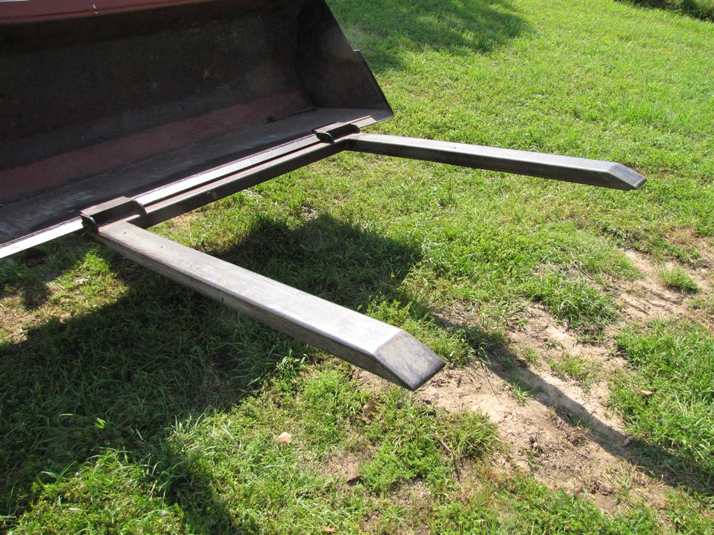

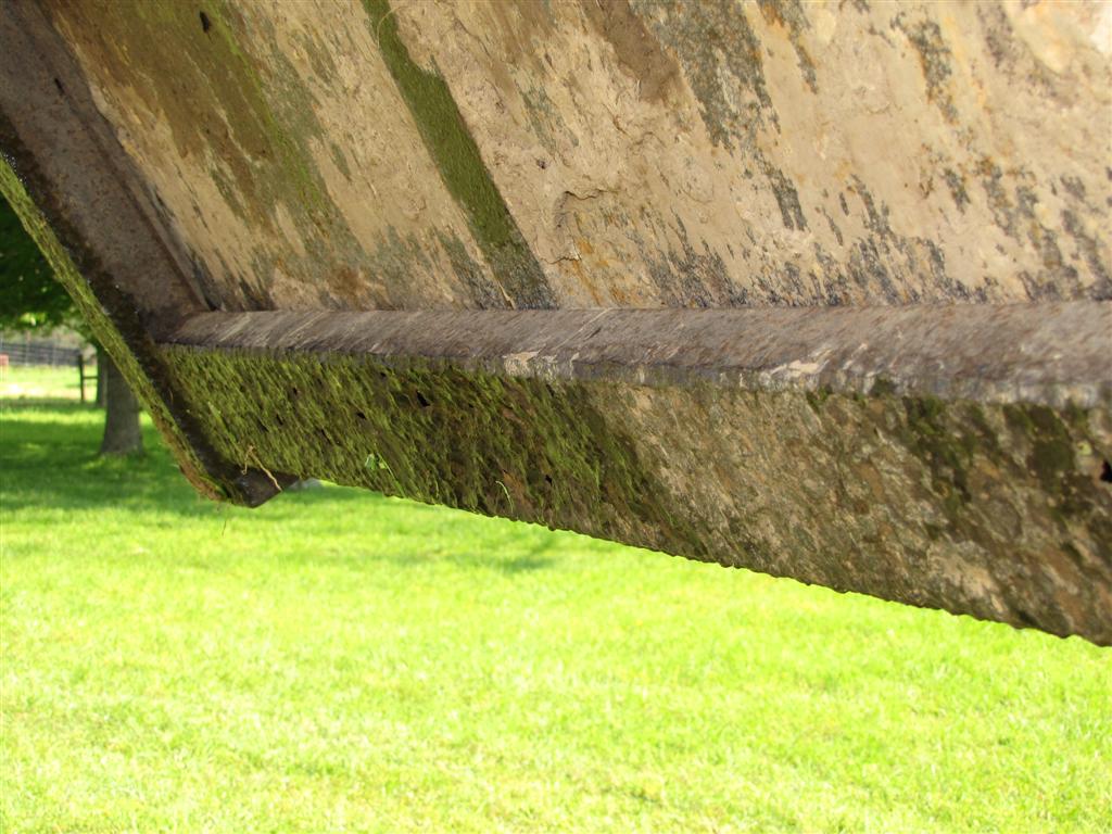

I have a bucket fork that is about 18 years old and has served me well. It slips on and off and is bolted at the rear of bucket. This weekend I discovered that the rear crossmember has rusted pretty bad. It has a few holes and the metal has caved, difficult to see in pictures, in spots.
I need to either weld a plate over or replace the crossmember. Replacement is best but I would have to find a replacement piece as I know I do not have any in stock. This would give me another few years of use.
