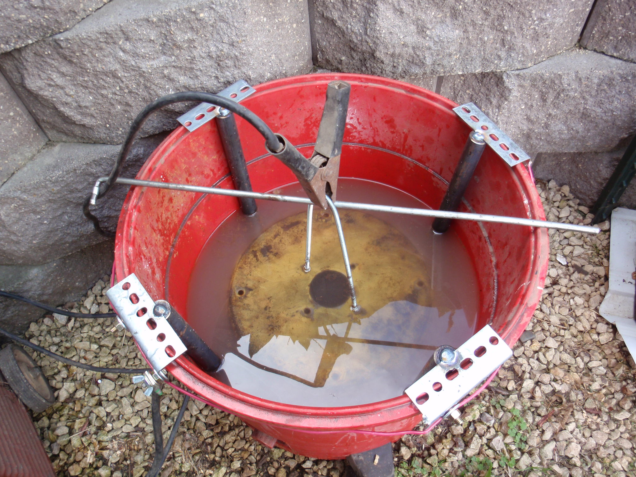

Yea, that will work. You will have to reverse the usual polarity. The "tank" in this case is the bucket, so if I am correct you will have to put the black or negative lead on the bucket, and positive on the hanging rod sacrificial electrodes. I am attaching a photo of my corn planter press roller rim in the process. The part is connected to the negative.
No matter how clean you get it, and a nice paint job you put on it, it will eventually be bare polished metal if you use it for a while. But its a fun project anyway.
