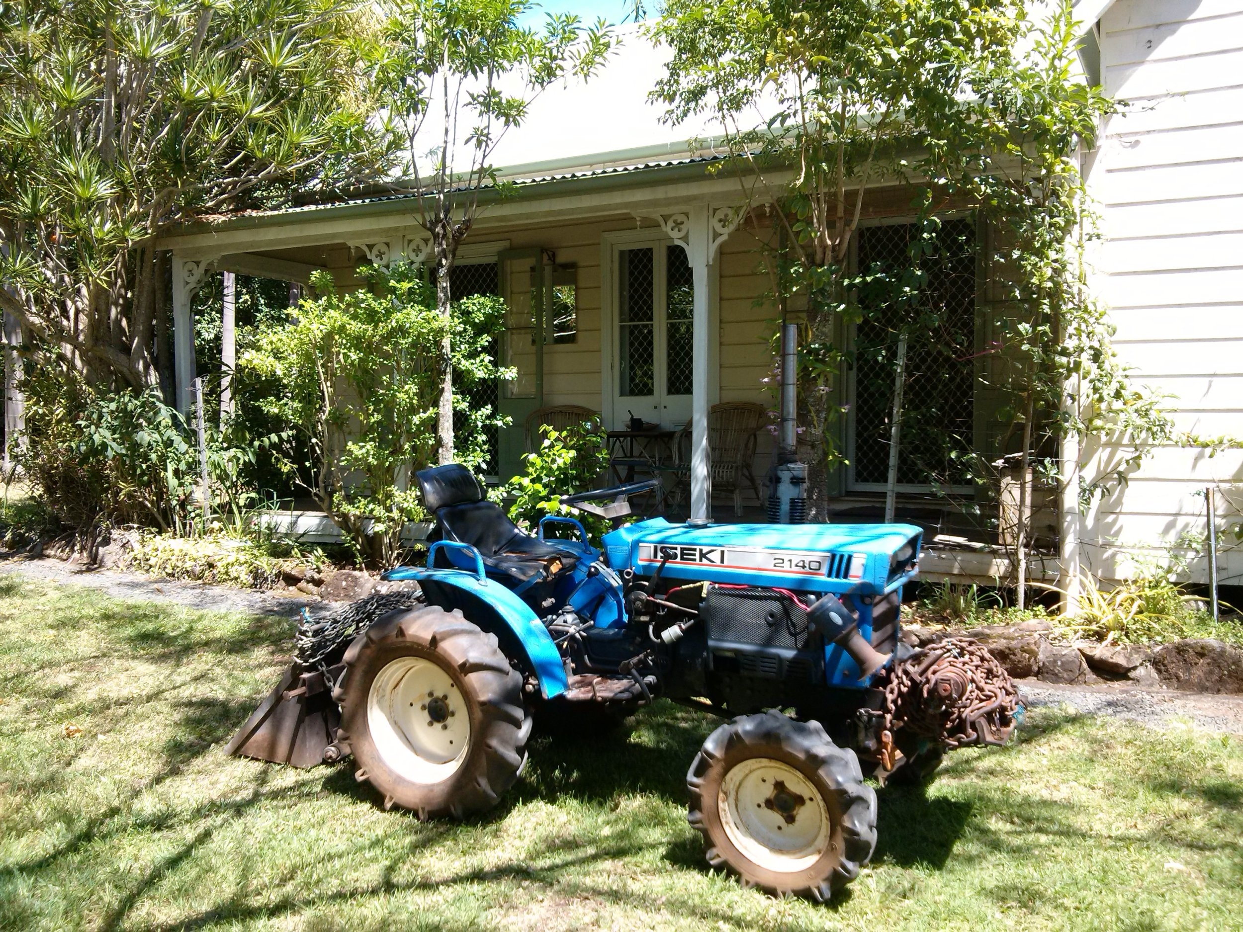

Iseki TX2140
When in 4x4 there is a sqeel that seems to be coming from around the front diff. Loudest when in high range 3rd gear. When I removed the drain front differential drain plug no oil came out. The hole was dry and dusty.
I cannot find where to pour the oil into. Can anyone help me please ?
Any pictures would be greatly appreciated.

what's the make and model of your tractor?

Iseki TX 2140

I think this may help you. It is for another model but may be similar to your tractor.

You have the same I have, except mine is a Bolens. Attaching a manual. Page 12 of the Bolens manual shows the fill and drain plugs. That manual is for the 2 cylinder, but the rest of the tractor is mostly the same.
Another manual for the TX2140 is available if you type this into Google
TX2140 Parts Catalogue 2&4-Wheel drive type Iseki PDF
