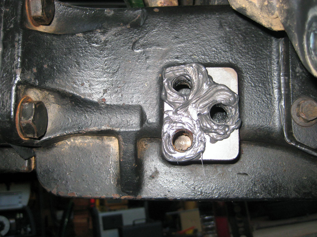

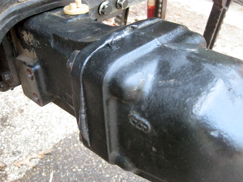

Back to actual assembly. Again, RTV on the spindle housing mounting surface. You can see it getting squeezed out.

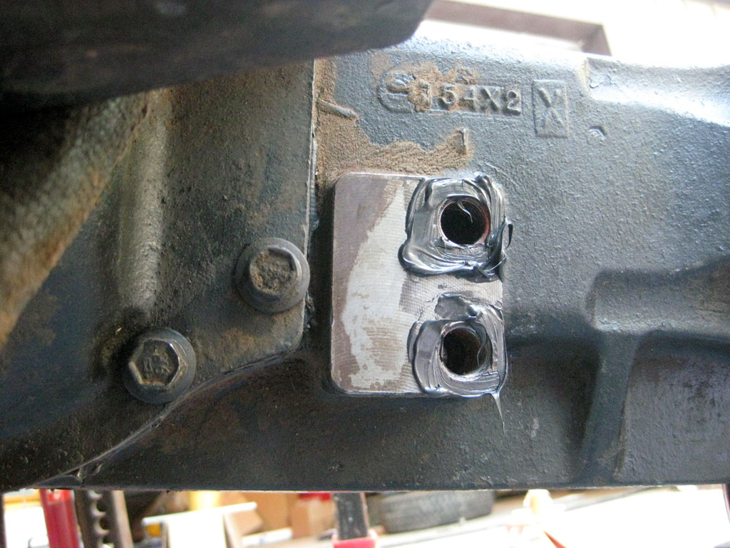

And RTV one more time on the steering cylinder mounting surfaces. These bolt holes go right through the axle housing so they need sealant all the way around.
Normally I would use Loctite on these bolts but I've found that RTV works really well as a blue Loctite (as in, is prevents bolts from loosening due to vibration).

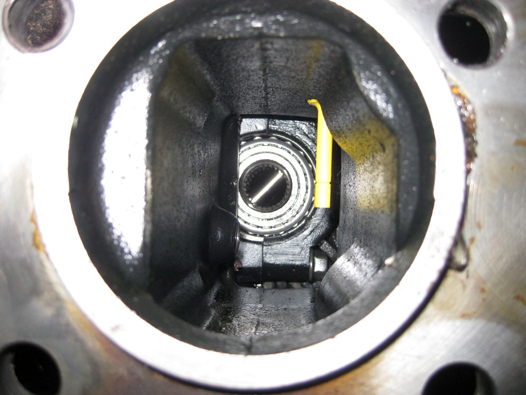

Some random pics. I liked dfkrug's pic of the fill plug inside the axle so much I took my own. I'm still shocked by how much fluid goes inside this axle. Still, as we learned from Sam Marsh... you'd better keep the fluid in there or you will destroy the portal gears.

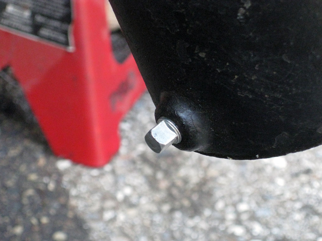

Next a pic of the new square end spindle housing drain plugs. Easier to destroy, but also easier to removed when destroyed.

Nice pivot zerks, ARRABIL!
I would have used a square-headed drain plug like you did, but I had
already bought a replacement. Yours is superior to the OEM socket-
headed plug because even if you hit it with a rock, you can still grab
it to remove it.

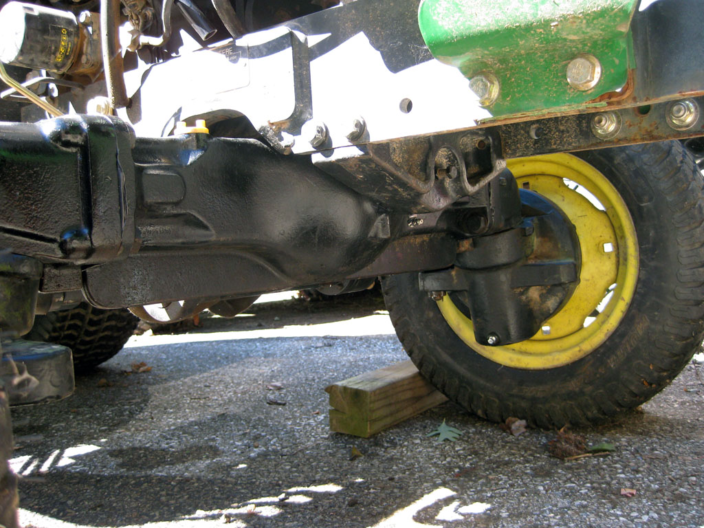

And another picture of the old girl ready for narrow row crop duty. I can't get over how silly she looks.
Reminds me of that TV deodorant commercial where the mountain biker has his front wheel come off, and he chases after it riding solely on the rear wheel. Or you could take it to the drag strip and do wheelie exhibitions.
There is no torque spec for the axle pivot bracket bolts. I should have searched better as there are 22 of these bolts installed on the frame. I'm sure the rest have torque specs. So I stupidly chose 215 ft-lbs based on the stronger bolts holding the spindle housing to the axle housing. Unrelated parts, unrelated bolts, unrelated problem created.
The first one torqued to 215 ft-lbs. The second one was taking an awful long time to get there. As I was thinking, "wow this is taking way too long," the bolt snapped in half.

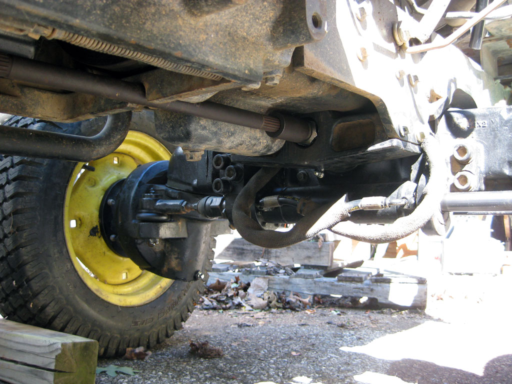

   / Front Axle Pumpkin Vent
#59

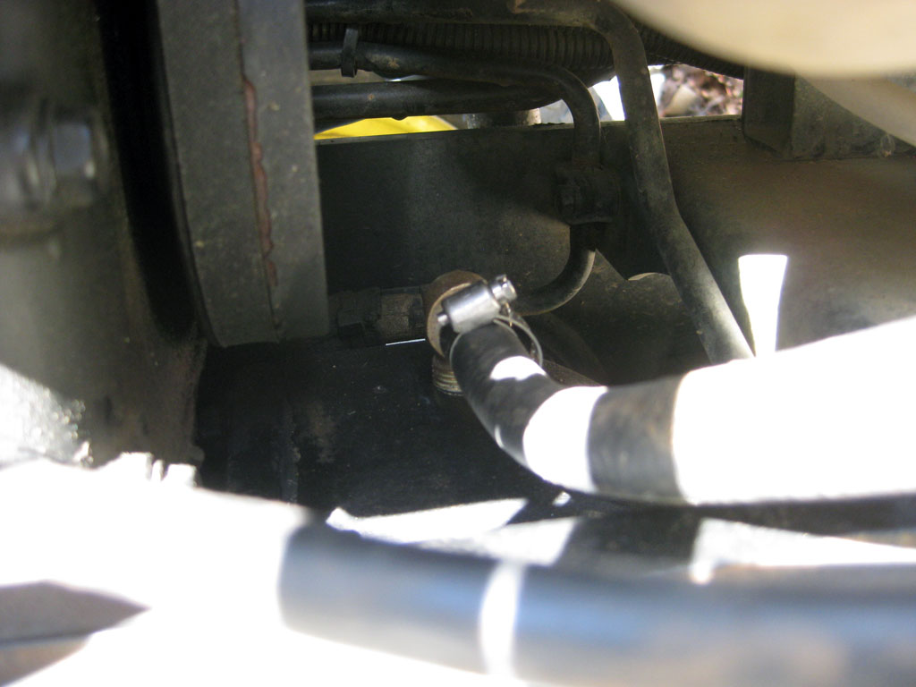

And the final installation pictures....
   / Front Axle Pumpkin Vent #60
Looks good!

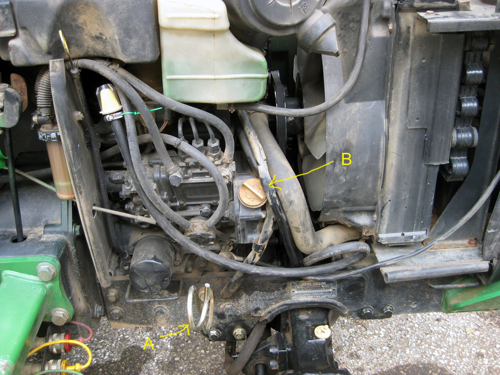

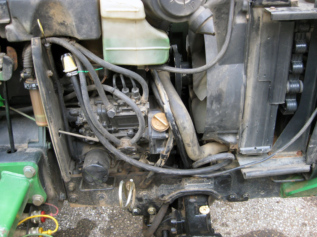

I noticed a couple things in your last photo.
Is that an add-on device to hold the FEL hoses (A in the photo)? I have
not seen one on any 4300, and it would come in handy.
B in the photo looks like your fuel overflow drain tube. I hope it is not
getting pinched between the valve cover and the intake hose....that's
what destroyed my engine.
