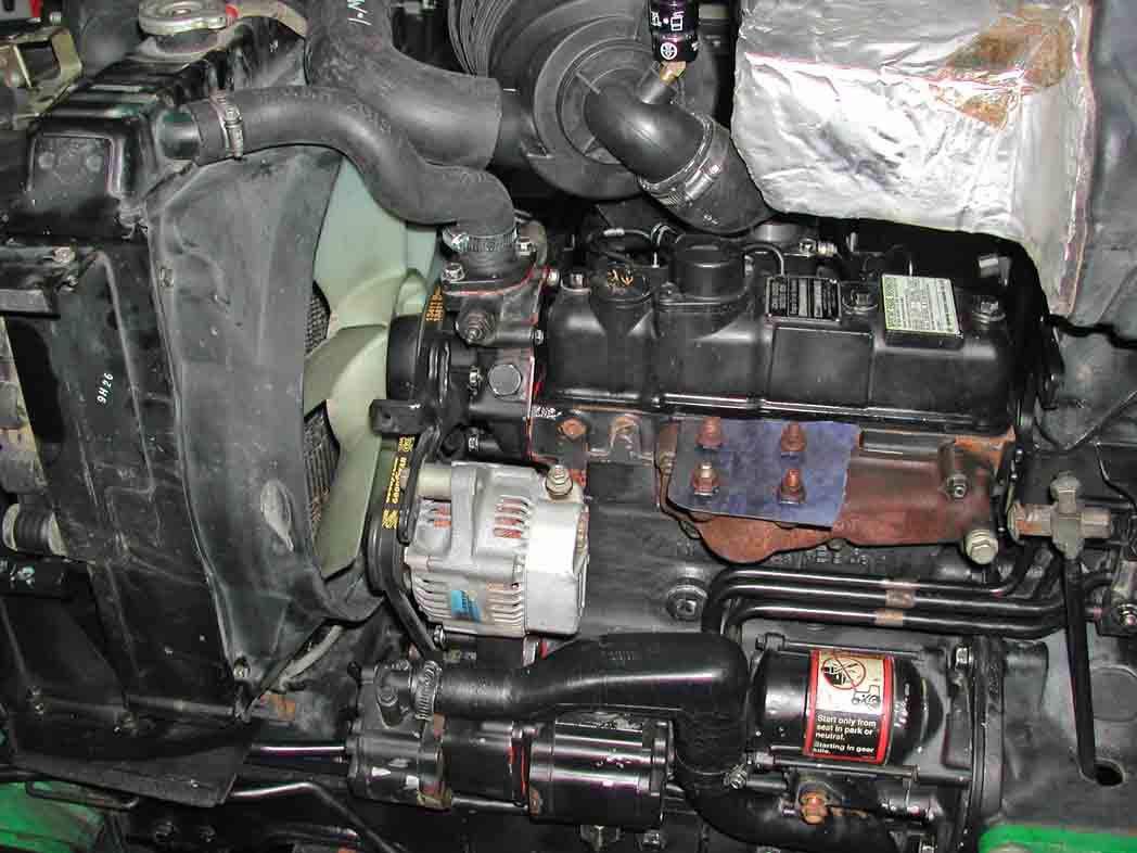

I had no problem removing my exhaust manifold studs and bolts. I
needed to remove them from the head to have the head hot tanked. You
don't need to remove the manifold at all for what you plan, but if you do,
the steel gasket is reusable. Just take the muffler off the manifold.
This photo is before I put the tank back in, but you can get a clear
view. If you cover the muffler hole like in the photo, you can wash
everything before you remove the valve cover.

   / Front Axle Pumpkin Vent #74
Dave. That engine is way too clean to be working on to do a rebuild. How on earth are you supose to get grease all over everything if you clean it like that before starting the work?:D:laughing:

   / Front Axle Pumpkin Vent #77
As you likely know, that's the engine that I put together in my rebuild,
so I am approaching it here from the other direction.
Anyone needing to get in there for inspection or valve adjustment should
remove the muffler first, make a patch for the hole, then wash everything.
Pressure-wash or otherwise, it will help greatly in the inspection, and it
will help to keep the innards uncontaminated with dirt. It is easy to clean
if you do it BEFORE you open everything up.
