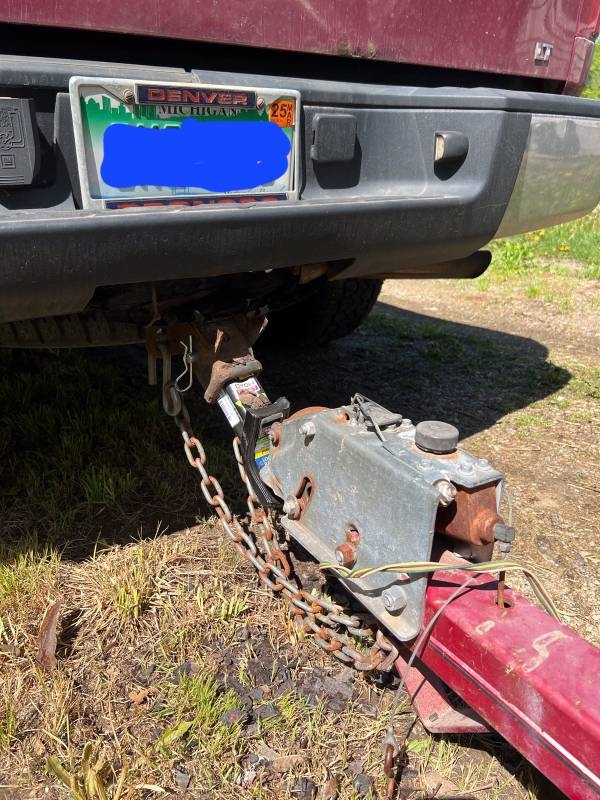

She went to pick up her boat out of storage from a town roughly 25 miles away from her house.
She got home and was back the trailer up into a spot and this happened.
She got very lucky.

Those GM's like to rust, especially in Michigan. She is very lucky.

All vehicles rust. That’s an area that most people wouldn’t think twice about looking at either.
/ Friend had a close call
She was over with her daughter a week ago and rust wasn't to bad on the truck, especially for its age and MI.
She's a widowed mother and just drives it. I'm thinking I'm gonna go over and check the frame out, brakelines, etc
Sure they do, some are more prone to it than others. Anyone with half a brain would check the hitch if they tow often as that is usually the first place to rust. Dont make excuses for poor maintenance and inspection, especially in the rust belt. She got lucky, could have dumped that trailer on the highway and injured or killed you or your family. Not enough people think like that, its amazing the rust buckets I see on the road here every day. Scary actually.

Chains wouldn't have done anything except drag on the ground
/ Friend had a close call #14
Looks like a heavy tongue load based on the size of the surge brake hardware. What does the boat+trailer weigh ? Doesn't look like the surge brake lockout was set, so she tried to back up a heavy trailer with it's brakes locked up. I'd guess any hitch condition would fail.
You can trick this situation by backing VERY slowly as to not compress the hitch, plus a boat ramp is sloped downward, helping you. Ya gotta be smooth to get away with this and conscientious enough to pull the lockout pin when you leave.
You are right and I was wrong...didn't realize how that hitch was attached to the truck. Ran the pic through Photoshop to get a better look:

Ya, those chains would have stayed with the hitch and trailer….down the road somewheres. Scary.
i inspect mine yearly. When i purchased my 1994 dodge ram , the hitch receiver tube wasnt welded to the rest of the hitch….from factory. I noticed it when walking truck at dealer. I would have had to wait around for 2 days for replacement hitch, but seeing as i flew 1200 miles to pick up rig, they offered to pick up cost of repair after i got home. I wasnt towing anything on drive home.

Not sure what the total weight is. Trailer is way to big for the 16' boat. She hardly ever tows and I don't think she had the boat out of storage since her husband died.
She just doesn't understand about hitches and rust. She learned today. Luckily no one got hurt.

I've seen it before and have suggested here in the past that people check or replace them after 7 years or so. Reciever hitches rust and you don't realize until something like this happens. The square tubing type catches sand, salt and all manner of other debris. The round type is welded with no open holes so it seems they would be better... except they condensate and there is no place for the water to go. I've drilled holes and watched the water run out... these tend to rust from the inside so you don't even know that there's a problem until something gives.
/ Friend had a close call #20
Based on the photo that looks like a pretty weak design to begin with and may not been meant for that kind of load?

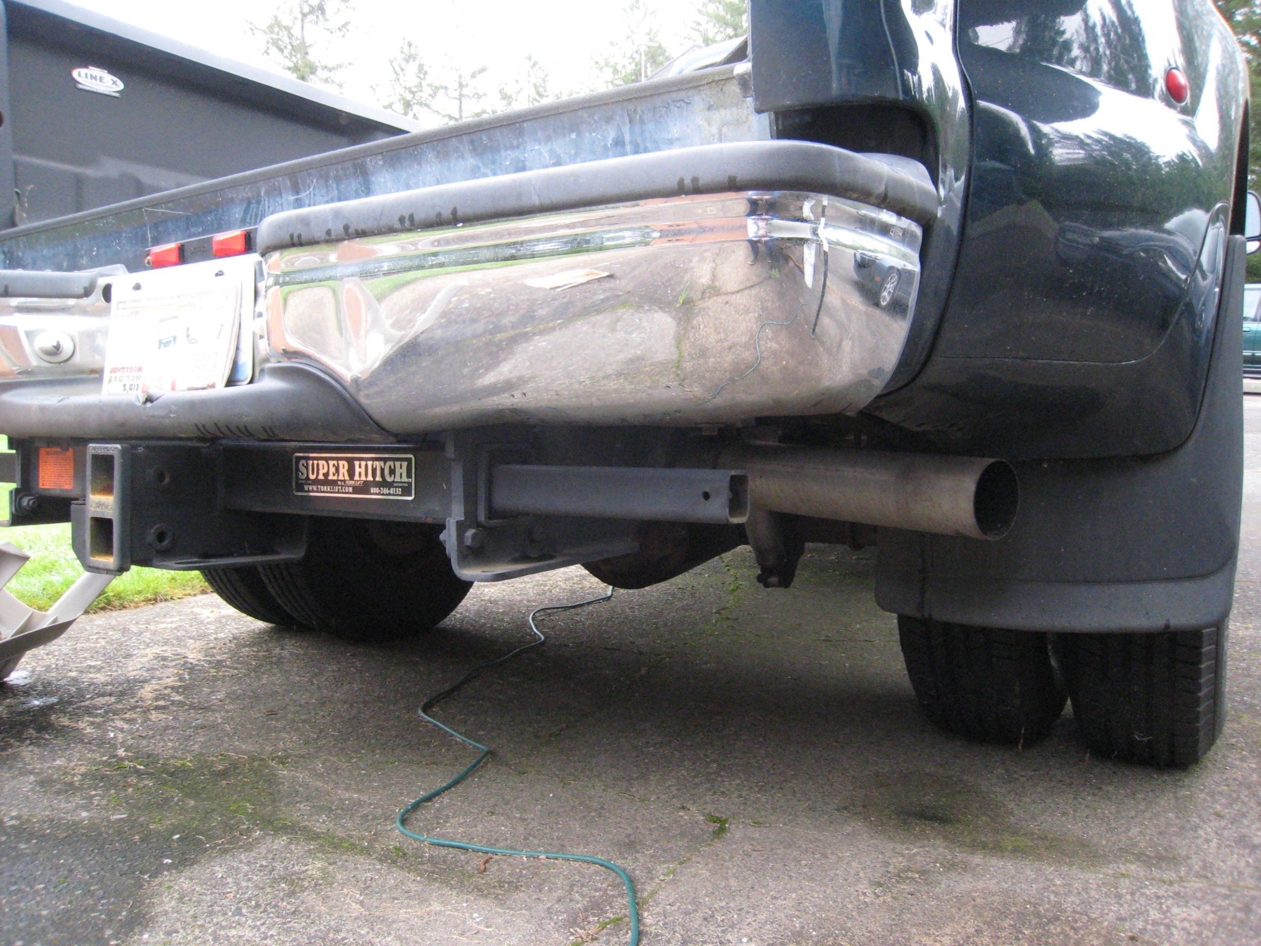

I removed the frame mounted way undersized hitch the previous owner had installed and installed one of these on my 99 F350 few years ago.
Fair bit of work since these older trucks do not have the proper holes drilled at the factory.
