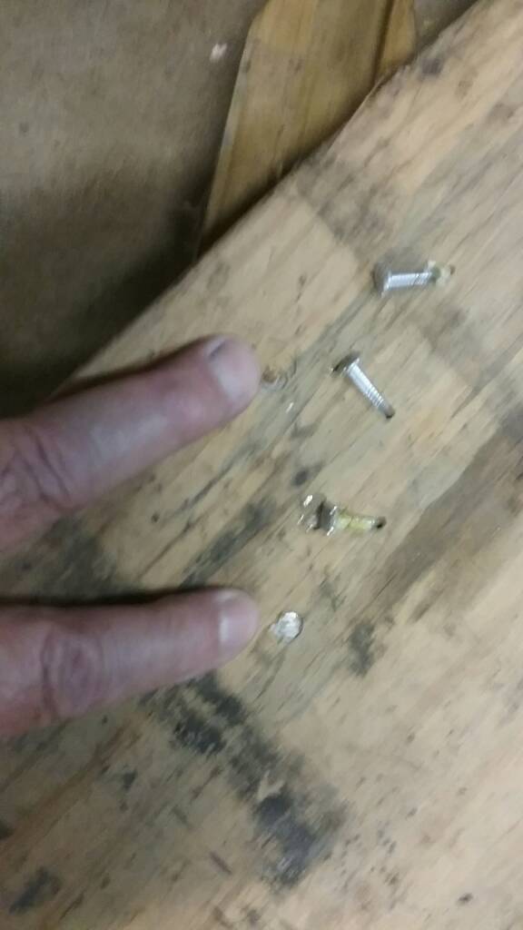

I'm wanting to buy a framing nailer. I'm not a contractor so not looking to spend $300++ for a really good one. I'm helping a contractor at home here building a barn, he has a Porter Cable one and it's great.

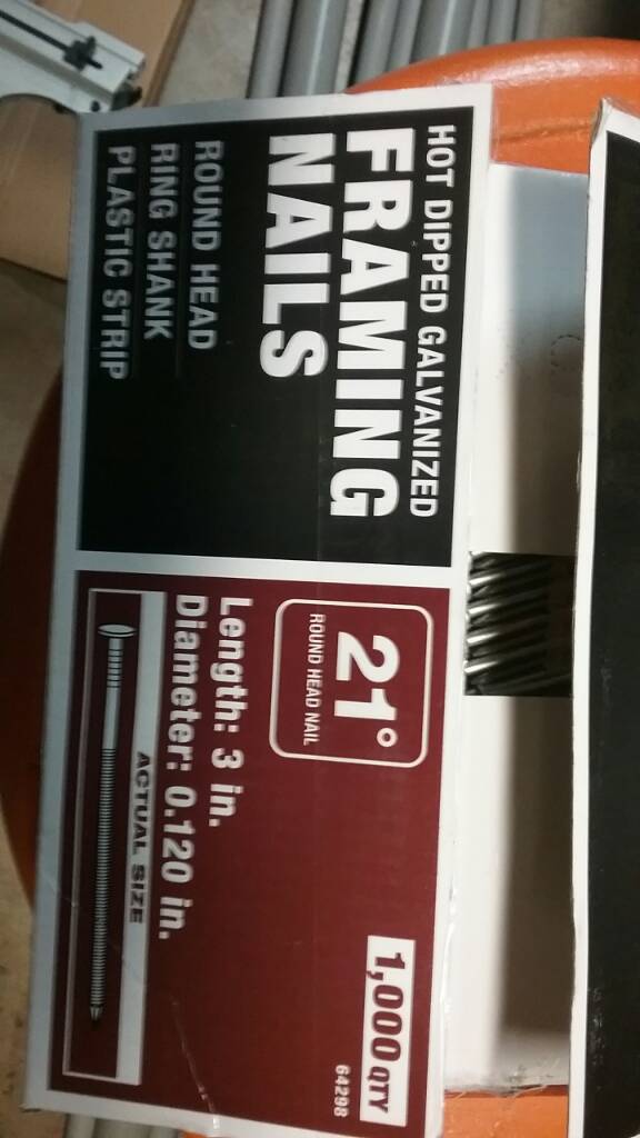

Yesterday I was in Harbor Freight and I bought this Central Pneumatic one (I know...cheap)...but it was cheap, on clearance for $46, so I bought it and box of galvanized nails.
Problem is, nails bend as shown about 1" out. The HF "salesman" handed me a box of 21 deg., this nailer is 28*.
A friend gave me a big box of Paslode 30deg. nails, which work fine in this gun (I'm pointing to two I put in @ 120psi.).
After I called Home Depot, Lowes, etc., I'm confused and need advice.
1) that 21,28,30 deg. angle...is one "better"? I was told 30* is best as holds better.
2) ok to use these 30* nails in this 28* gun?
3) I was told nails are propriety to gun? Another said no. Another said plastic, wire tied and paper bound nails won't interchange?
4) should I keep this $46 one, or get a better one...it works great with Paslode nails.
5) keep gun, return 21* nails, get 28deg ones from HD or Lowes?

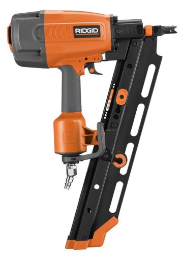

I dont use my frameing nailer too make a living , and I know Hitachi and Senco make top of the line ones. However I have owned the Rigid (HD) 21 degrees one for years and its never skipped a beat . Its been great !

Plastic, wire tied, and paper nails are NOT interchangeable. You need to get the right nails for the gun. The box on the nailer, or instruction manual should tell you what angle * you need. According to your pic, you need 28*. Take the 21* back, and get 28*. Just be sure to get the right binding for the nails.
