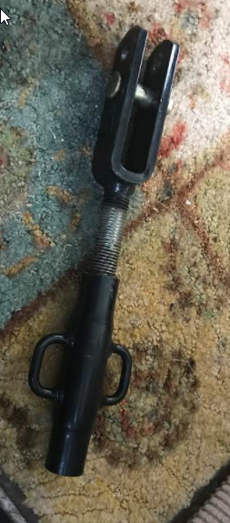

Greetings everyone,
My first post and of course, it comes with a question.
I just bought a used tractor with 80 hours on the clock.
(Mehindra 2638 with FEL and backhoe)
After adding 4 hours on it, I found this on the ground and hoping someone will know what it is.
It's about 10" long. Opposite end has internal threads and hoping it is something for the 3 pont hitch.

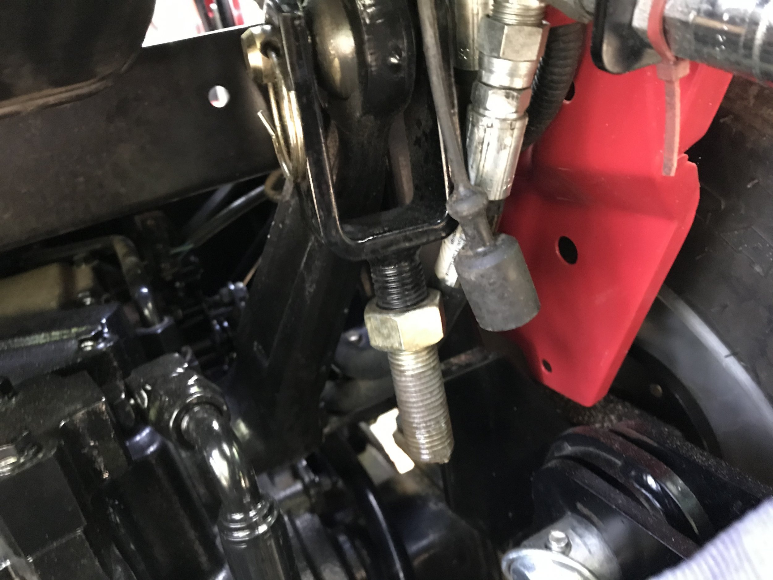

Root Cause
When you have the backhoe on these are just hanging down and vibration makes them unscrew, have had it happen. Make sure you tighten locking nut against this part so it stays put or remove them with the backhoe on

Root Cause
The other end is probably still on the tractor. Vibration probably unscrewed this portion from what remains on the tractor

Yeah, from 3pl as others say...
Look at ways to stop it unscrewing, it should not, and, your 3pl arm will be flapping around and may be able to cut into tyre or get jammed, so if you do not use it, you prob need to strap the arms or adjust and fix so they cannot wander into the tyre, or, keep an implement of some kind on there, my tractors always have something on them :)

I believe the part that threads internally to that has a nut that should be tightened against the part youi found. Check the opposite side. I call them Sway Bars if it is not the Centre Link. Tighten it too.

It is not part of the sway bar by industry labels. It is part of the side link from upper lift arm to lower lift arm. It is the lower 2/3’s of the adjustable link. Apparently he had installed a backhoe and removed the lower lift arms and sway bars, but left the side links hanging.
