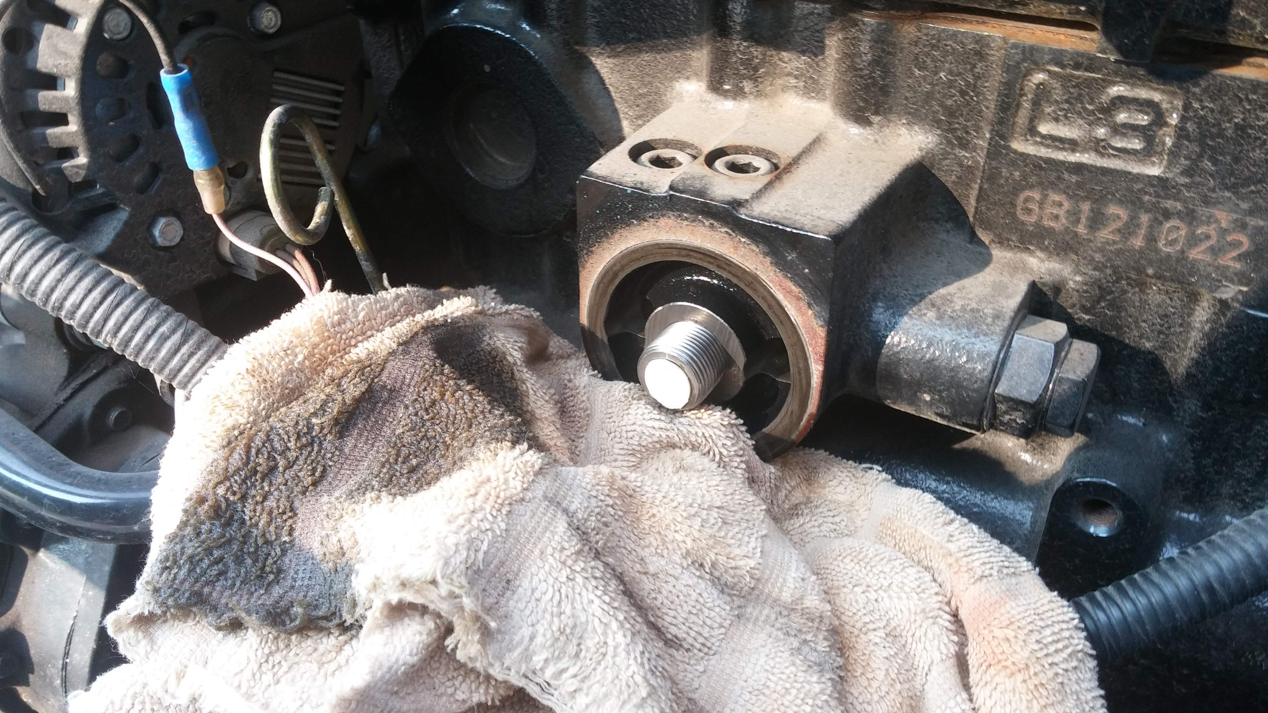

Anyone know what this white item is? Its in the exact position in picture as when I took the filter off. At first I thought it was part of the old filter that had broken off. When inspected, the filter was intact.

It looks like a piece of paper blocking the hole the oil goes through.

thank you for the reply...no..its a piece of plastic...shaped like a cone..what you see in the picture is the back side of it...or flat side....

Looks like the paper seal from a quart bottle of oil. Why would you put it there? Seems to me it would block the oil flow.

i didnt put it there...it was there when i took the old filter off...and this is the first 50hr service filter change to boot

I would be sending that picture to LS. That filter had to be working in bypass all the time and the oil never got filtered. I would start all over with the 50 hr service and ask them to pay for the 1st one. If you haven't dropped the oil maybe just put a new filter on and run for 6 to 8 hrs then do the full 50hr service.

Yes, being cone shaped I'd say it was a shipping plug on it that should have been removed before a filter was installed.

It looks like some kind of factory plug to keep debris out during engine assembly. If so, it's a poor idea. They should use a cap plug that also covers the external thread so it must be removed before the filter will go on.

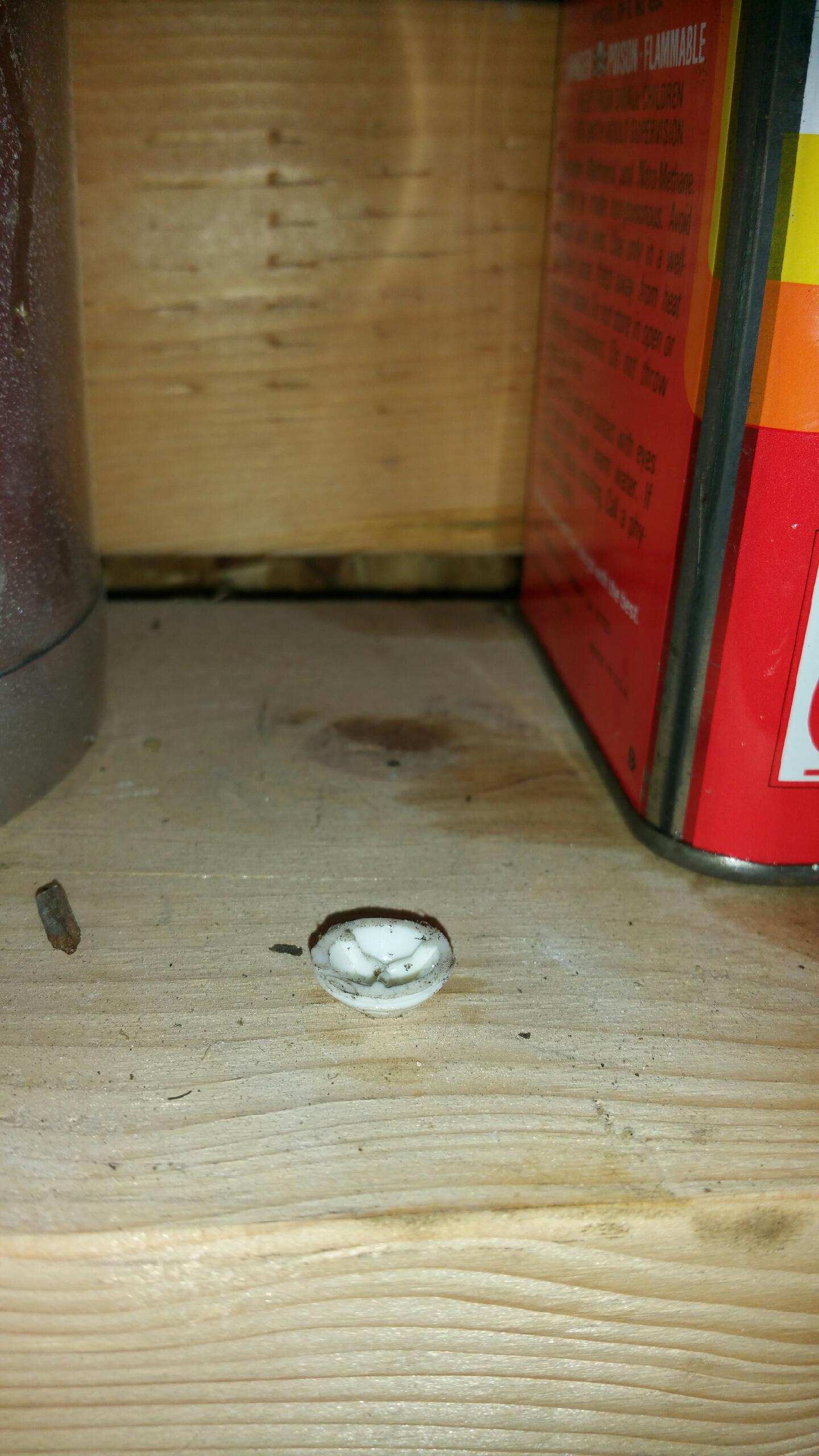

I'm curious what that plug looks like once you pull it out ?

my worry would be possible scoring ( due to metal particles in un filtered oil) of the new rod and main bearings. there's only around .002 inch clearance and the bearing material is softer than the crankshaft so that (large) metal particles just embed or score the bearings versus damaging the crankshaft.
On the other hand many engines operate with some bypass all the time. Especially during cold start ups with thick oil.
Most filters with built in bypass and block mounted bypass generally need less than 10 psi difference ( filter in-out) to start bypass anyway and many cars built in the 1950s only partially filtered engine oil.
Still If it were me- and I was offered a new replacement tractor there is no doubt that it would be accepted.
whoever mounted that filter over a pre assembly plug, had no idea of how oil filtration works and needs some basic training... Wonder How many other new engine blocks he applied the same assembly procedure to??

Pics added to OP

Some oil filters have an anti-drainback valve in them to prevent all the engine's oil from draining back into the pan when shut off, which could cause a brief oil-starvation issue on the next start. The ones I have seen had a spring and little stopper that would block flow (the spring is weak enough to be overcome by oil pump flow when the engine is running). And actually, once I replaced one of those special filters with an aftermarket filter that was missing the anti-drainback valve, and sure as rain the engine had a bearing "rap" on every start until we remedied the problem. That's when I learned about this (at age 12 or so).
I have no idea if that little white piece is part of one of these valves, or if LS even uses them in their filters. Have you looked in the filter to see if it could have broke off of a mating mechanism inside?
