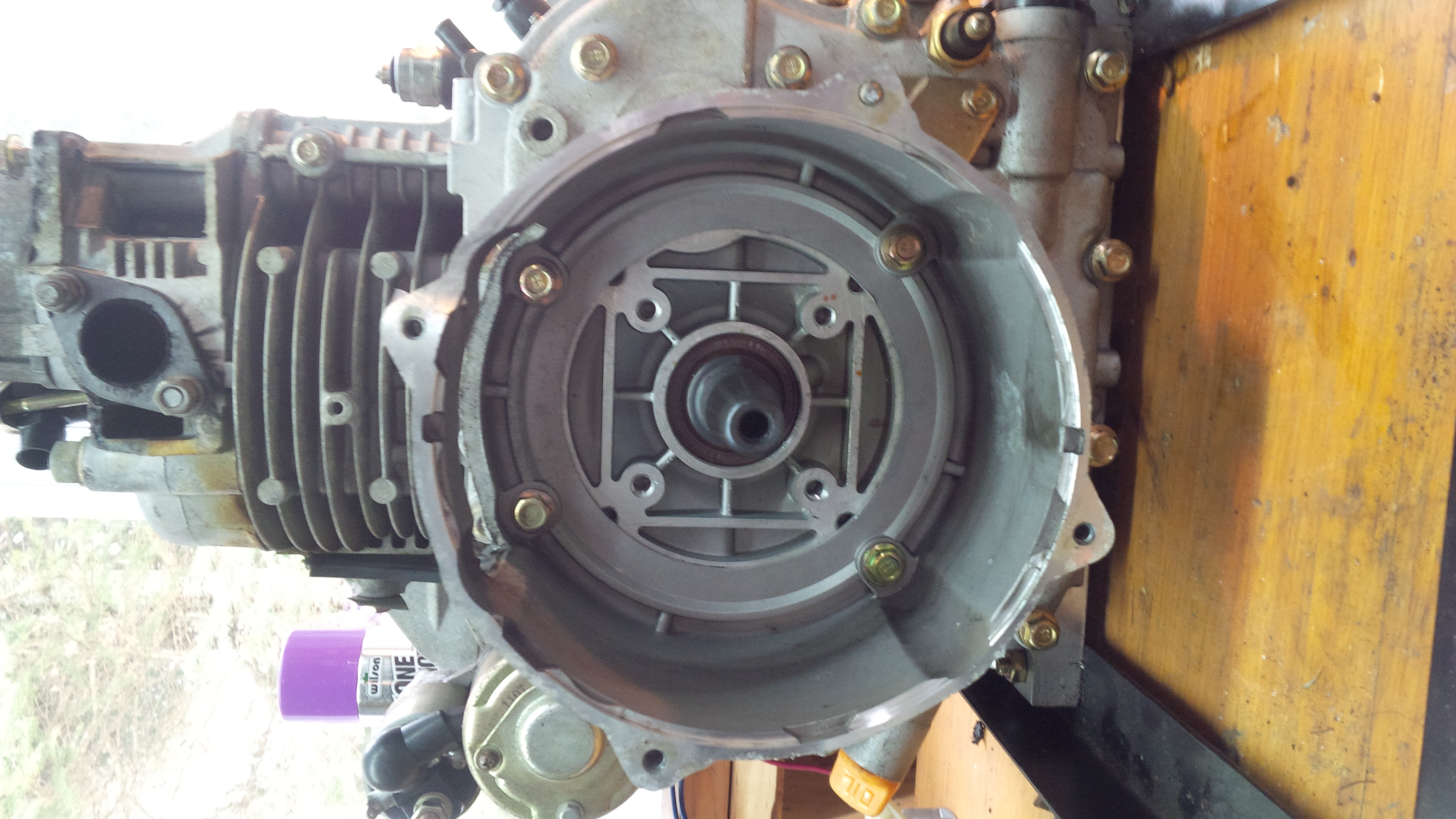

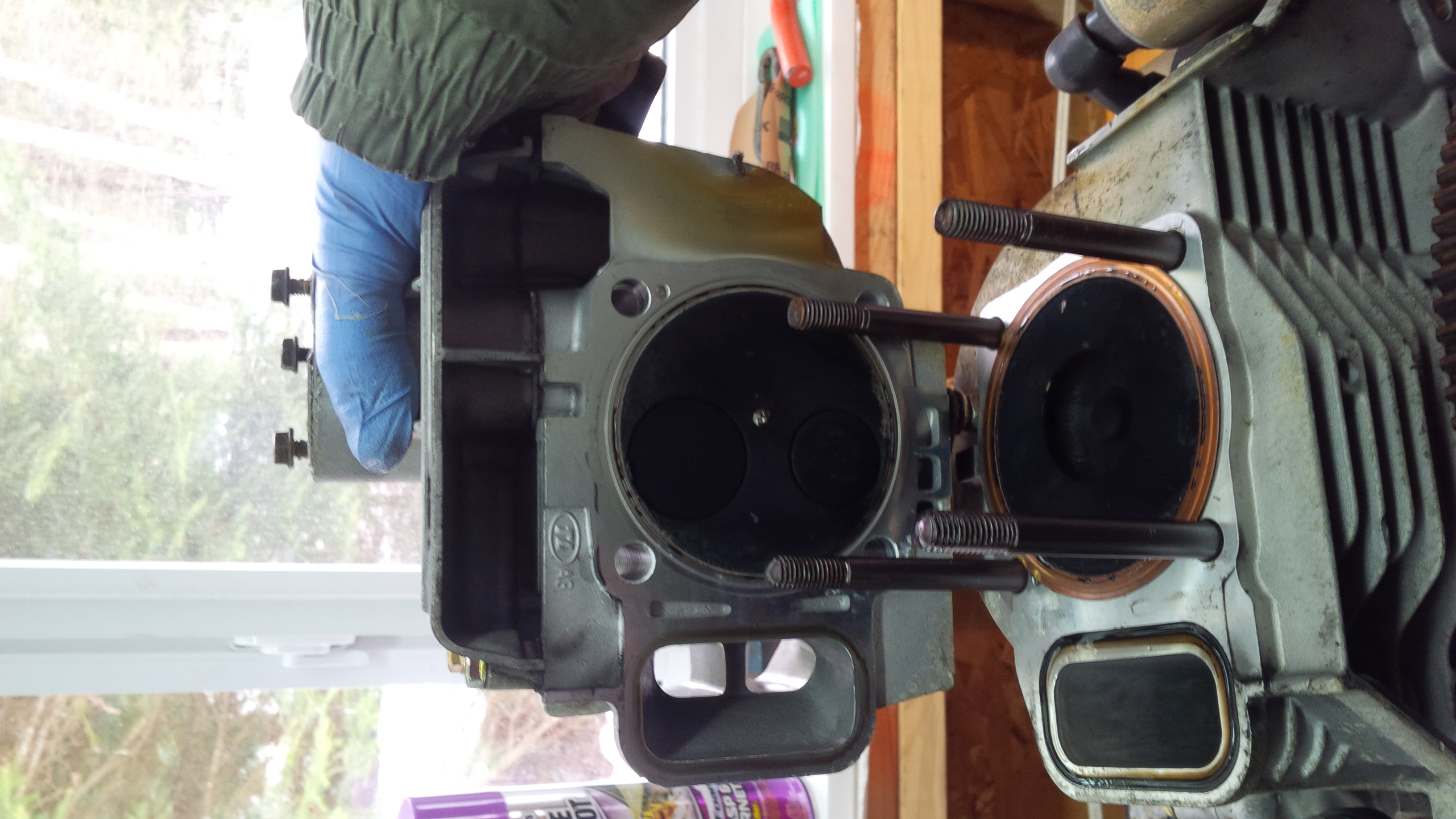

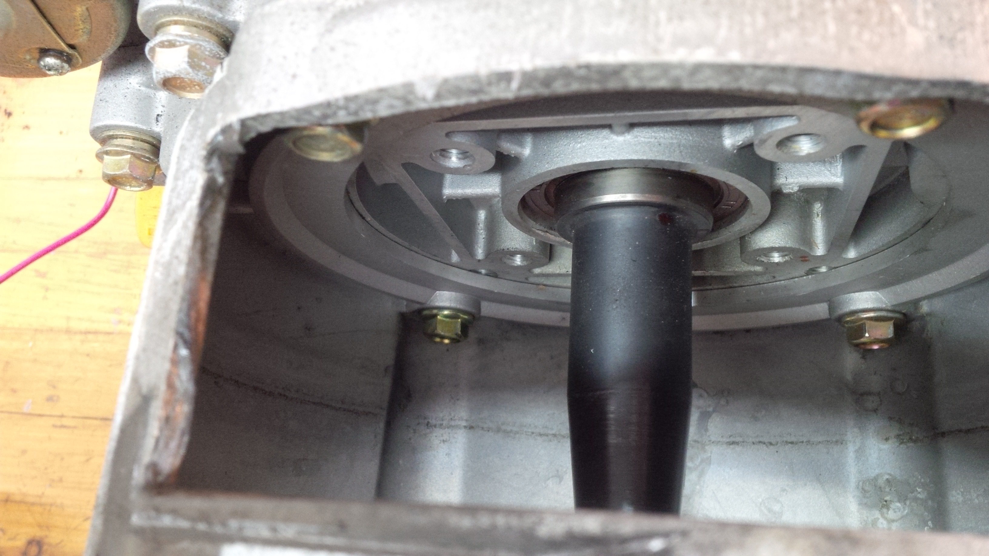

I got it all apart.
The armature (rotor) came out quite easily, I couldn't find a rod that would fit right, so I whacked it with a rubber mallet a few times and it popped off without much of a fight, soaking in pb blaster for a few days helped too I'm sure.
I then pulled the valve cover off, cylinder head, everything looks clean, no visible damage of any sort, very little carbon buildup, no scoring on cylinder walls, no play in anything.
I didn't open up the crankcase, I'm not sure I should since I don't see anything wrong on the top end, but I'd like to hear some opinions from the experts.
Here are a few pics of what everything looks like.
seems the rest of my pictures are having a hard time uploading, I'll try again a in a bit

If I had it torn down this far I’d open it up.
Pull the piston & check the rod bearing then there are no questions.
Carbon buildup in the ring lands can cause issues better to check now then to go back later.

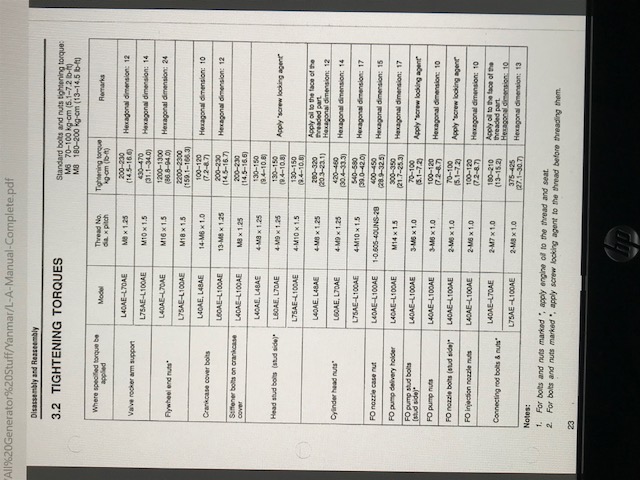

Hi All -
Has anyone got torque specs for these engines? Connecting rod, crankcase cover, head bolts, etc?
Thank you!
   / Forum for air cooled diesel engines and clones
#350
This should help.
