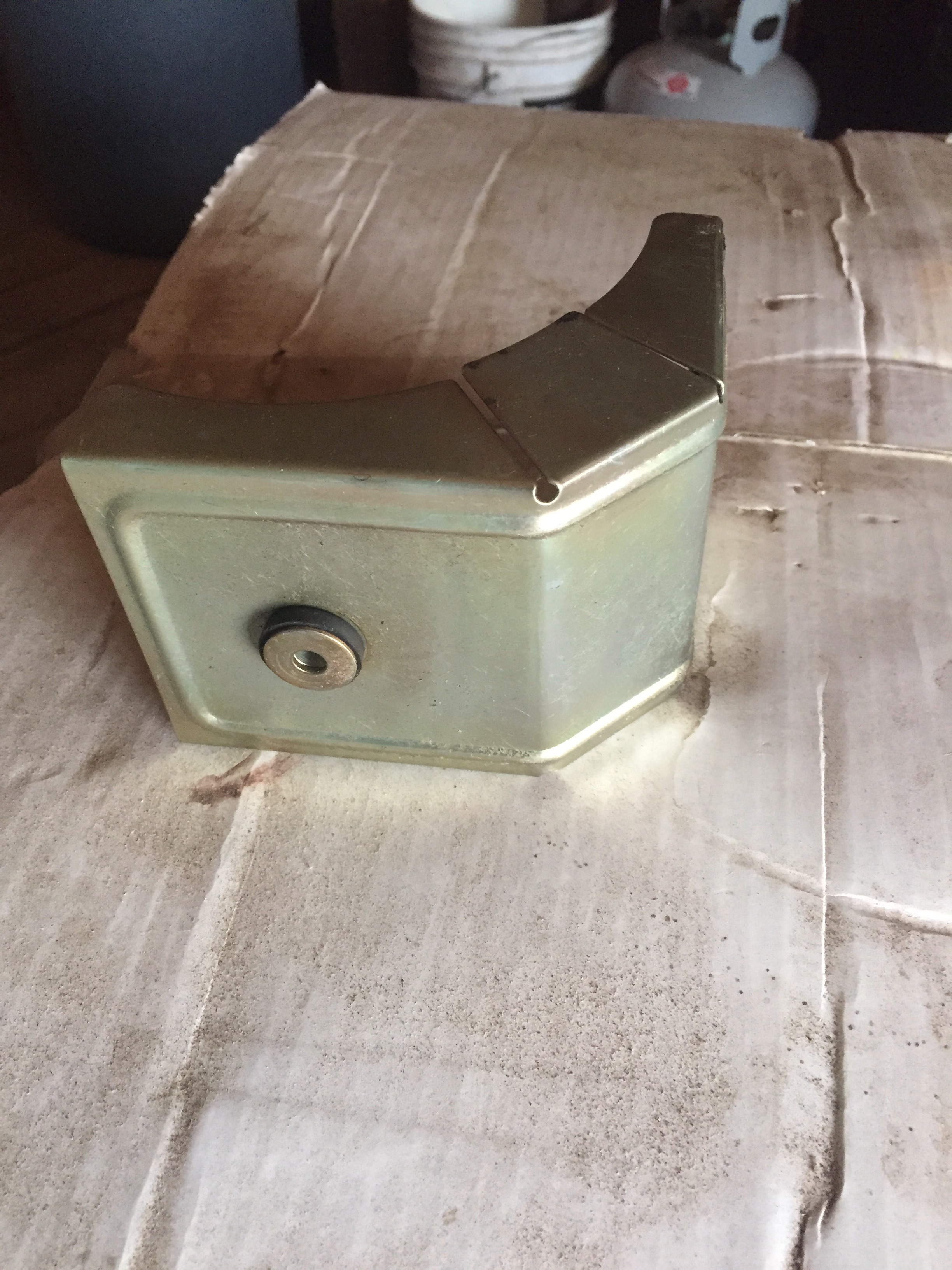

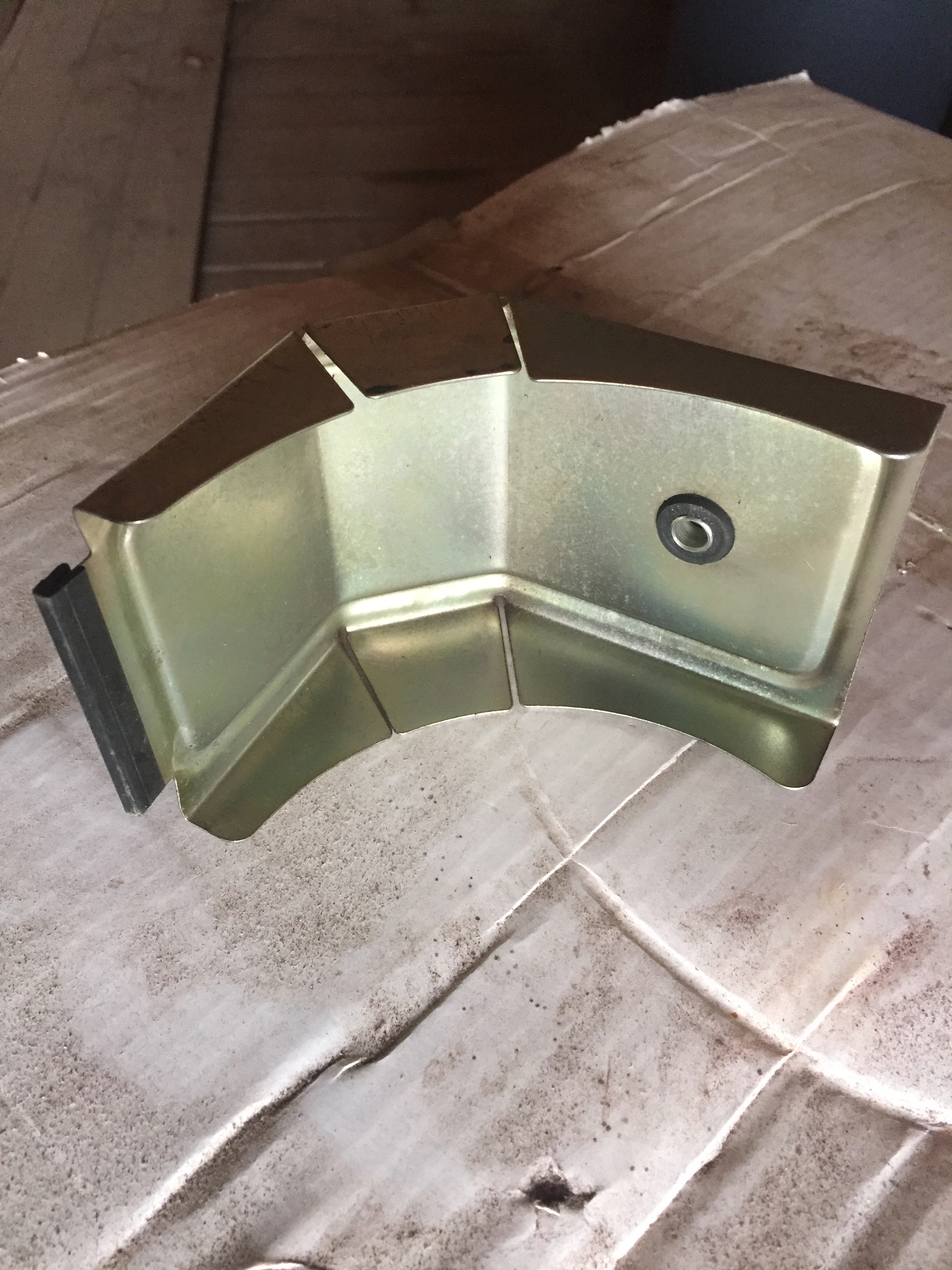

For those who have one of the "quiet", i.e. full cabinet models - reassembling the engine was the quick part - putting all of that cabinet back together is what took the most time, lol. Got it all back together, only had one part leftover! I checked parts diagrams and all the pictures I took during disassembly, but couldn't identify where the heck this bracket goes?
View attachment 545441View attachment 545442
That attaches to the engine cylinder near the exhaust outlet.

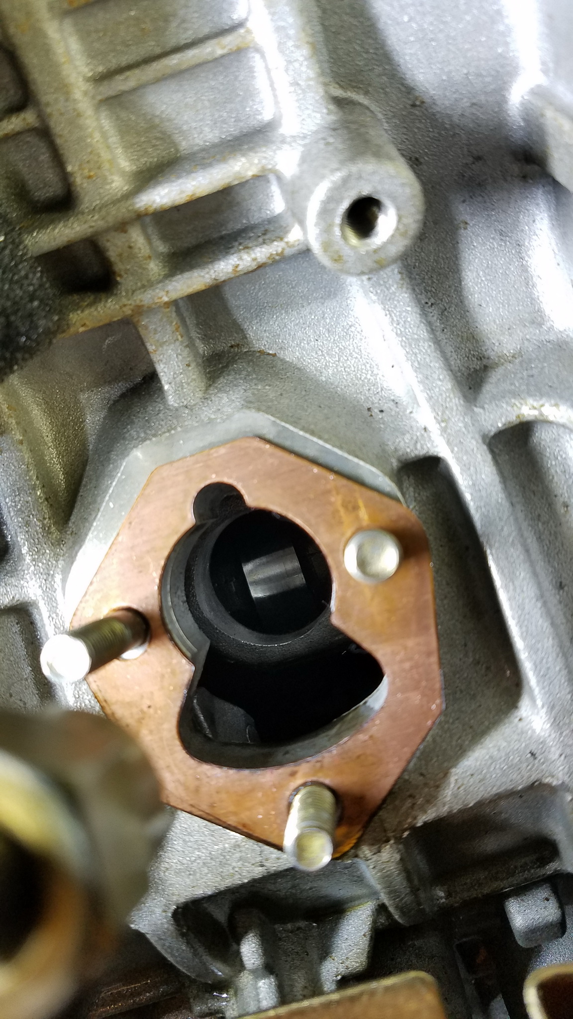

I have a strange scenario on 1 of my two 186F generators. The newer one (Buffalo Tools 7K quiet model) has a total of ~60 hours on it. During a recent outage, after running just fine for about 20 hours, it started running rough, sounding a bit "off", like it was stuttering, then it would smooth out again. Then all of a sudden AC output died, but the engine was still running the same. I assumed the AVR had died, and when I looked at it, the tie-wraps had failed (nice quality install :) and it was bouncing around on the bottom of the housing. I ordered a new AVR, assuming this would take care of it. Also, at the time, it seemed there was a major exhaust leak that should be tended to, so I removed the muffler cover and found the bolts between the flex-pipe/cat and the first muffler had fallen out, and the gasket had disintegrated. As a result, exhaust had been blowing out of the loose connection, making a mess of the cabinet. I also noted that the inside of the cat was blown-out, and that whatever was originally in there was gone now, presumably into the muffler... I cleaned everything up, installed new gaskets and re-assembled the mufflers, installed the new AVR, and fired it up.
Still no power, so something other than the AVR, but now I have an engine problem also. It fires immediately, as normal, but will not come up to speed. Spits and coughs and blows an incredible amount of smoke. It will smooth out somewhat if I hold the governor back to a lower engine speed, but will not run up to operating speed.
I pulled the injector, and the spray pattern looks as expected when tested. Have not pulled the fuel pump. I pulled the mufflers back off, and removed the air cleaner in the event some inlet/exhaust obstruction was causing the problem. It again fired-up immediately, but belched smoke and back-fired out the open exhaust. Other than being a LOT louder, it behaved the same as before.
Something clearly went suddenly in the engine, but I have no idea what to look at. It sounds like a timing problem, but why all of a sudden? I have not pulled the oil filter to see if there is any suspicious metal bits there - will look at that tomorrow. Do cam bearing failures happen in this way - all of a sudden, or do they deteriorate over time? What else could cause a fuel timing/delivery problem like this? If it had major internal engine problems, I wouldn't think it would continue to fire off like it does.
Running with the open exhaust, you can see flames every time it stutters, leaving me to believe it's a timing problem. Any ideas?

It's my understanding that the injection timing is adjusted by the thickness of the gaskets under the injection pump, so that's not something that should change spontaneously. The timing gears are pretty rugged, so I don't expect it would jump time like an engine with a worn out timing chain might. A burnt/bent valve might produce some of your symptoms, but not the surging behavior you describe. So, in my - admittedly limited - experience with these engines, that sounds more like a fuel delivery problem that a timing issue. I would check your fuel filter and ensure that you're getting adequate flow to the injector pump.

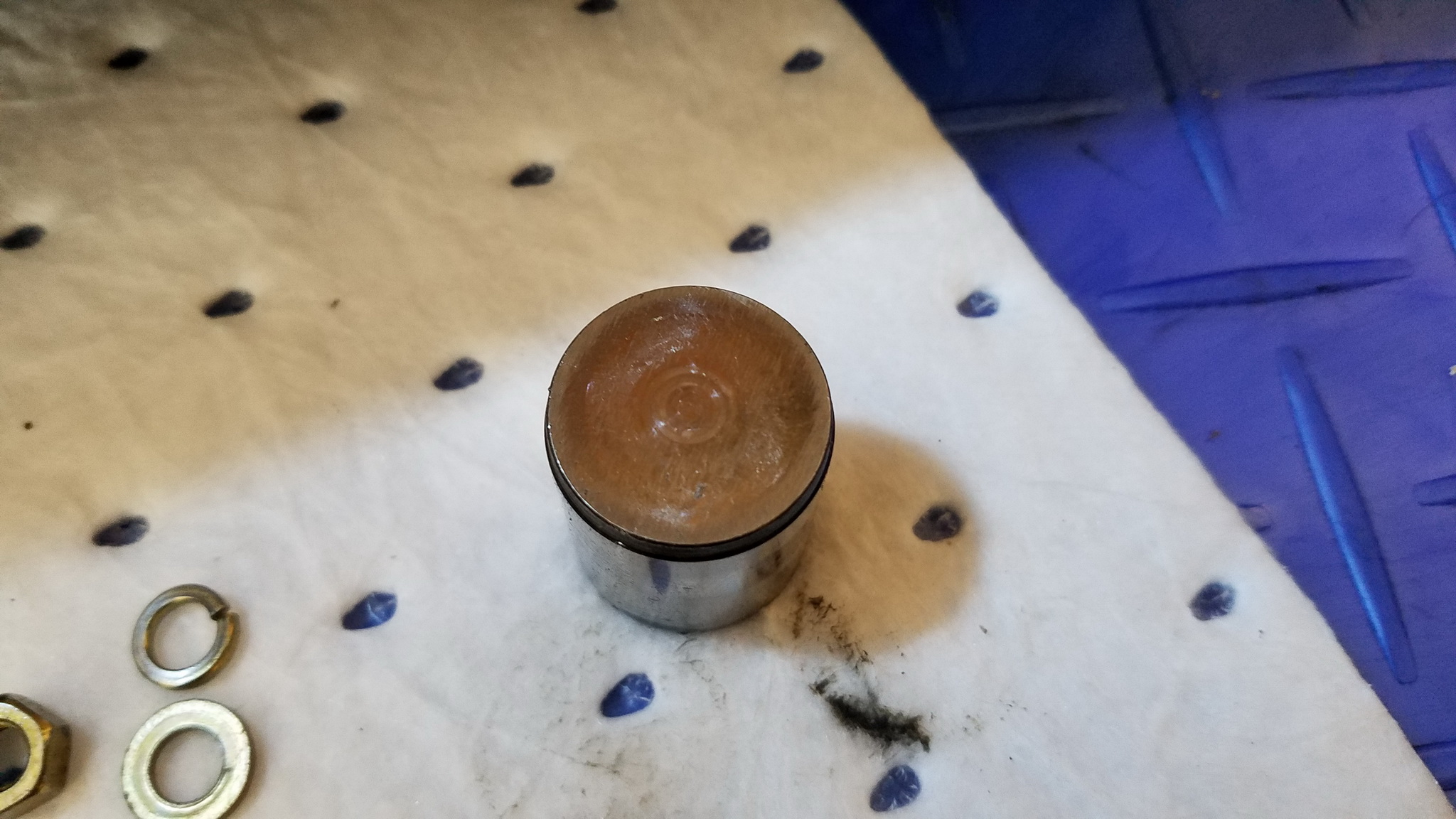

Remove the injection pump then remove the cam follower (lifter) the face that rides on the cam should have no significant marks on it.
Check the oil filter screen it should be clean. If there are small magnetic particles on it the small cam bearing may have failed.

Pulled the injection pump, and the cam and follower look good - some minor wear on the follower, but nothing of concern. Cam looks perfect. See pics. I re-assembled it and fired it up with open exhaust and intake. It fired right up, and exhibited the same issues. Youtube video of it starting: Gen start - YouTube and running: Gen run - YouTube
Any ideas? If it had a carburetor, I'd turn in the main jet about 1/2 turn...
