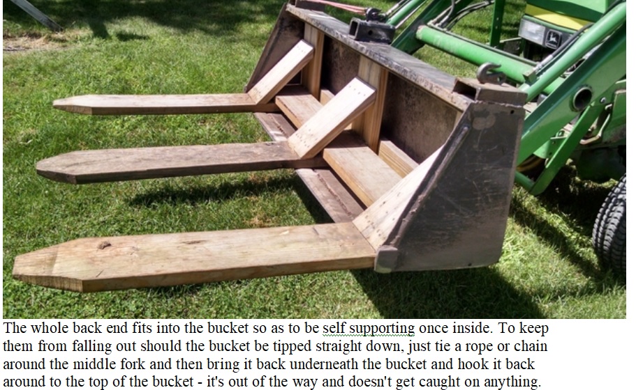

I have a set that I built. My bucket is pin on. I built mine where the bottom goes past the rear of my bucket, and where I can attach a chain from each fork to hooks on my bucket or to the bottom portion of the forks. I later built a cross brace between the forks.
The clamp bolts move easily metal on metal with force applied especially trying to get under larger limbs—thus the cross brace. I also try to put a piece of old tire sidewall under the bolts when clamping.

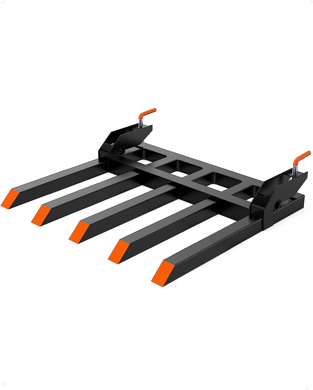

I recently bought a set of debris forks. They are fantastic.
They are bolt on with HEAVY DUTY bolts.
They do not need stabilizer because the whole attachment is welded together.
They will plunge into a S*** pile of brush and pick up a lot without handloading.
They did not get loose or unstable!
Very pleased with product and performance

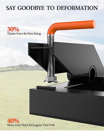

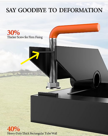

Do you really have these forks? I looked at an advertisement of theirs and it looks like someone photoshopped them into different pictures. The "rugged heavier bolt" appears to have about 1 thread engagement into a 12 ga piece of metal. See below:

Do you really have these forks? I looked at an advertisement of theirs and it looks like someone photoshopped them into different pictures. The "rugged heavier bolt" appears to have about 1 thread engagement into a 12 ga piece of metal. See below:View attachment 809199
Yes I do have the forks I showed. I recently shopped and then purchased. Maybe they have improved, I do not know. I do know that what I bought is very solid. I work equipment hard and put these to the test

Those are definitely nicer than the standard clamp-on forks.

Maybe take a pic of the mounting bracket. Maybe yours is more robust than what they show on the Amazon website?

I looked through a lot of forks and read the complaints. Most could have been solved with what I bought - and they were. I don't blame folks for being skeptical, there is a lot of junk out there for that price range.
It looks very much like your picture. It appears to be well engineered.
That box section you are looking at is stronger than what you are thinking.
The bolt is much bigger than the others I looked at too.
/ Forks, Bolt-On, Do they work ? #34
The bracket itself looks strong enough, it's just that it doesn't look like many treads can engage on that lockdown bolt. The debris forks themselves look pretty handy.
