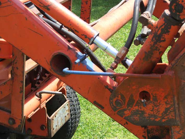

This is my simple bucket level indicator. Its just piece of rod welded to the bucket bracket, plus another small piece welded to the loader arm. When the two pieces line up the bucket is level when its on the ground. (The pic is a bit misleading. The pieces line up perfectly with only about a 1" space between them when the bucket is level.)

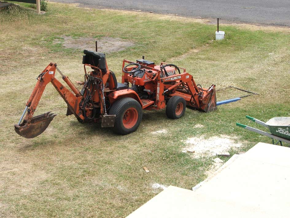

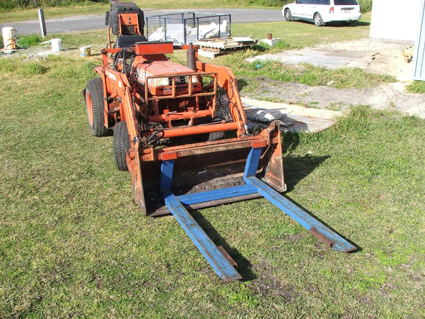

Another thing you might consider is to weld a square piece of tube to the side of the forks at the tip. Then you can slip another piece of tube into that piece to extend the length. That might make it easier for you to actually see the end when you are trying to get under a pallet.
(In the pic you can see I've actually got a lightweight frame attached to the end of the forks. This was so I could carry 4 metre flooring sheets 'longways')
