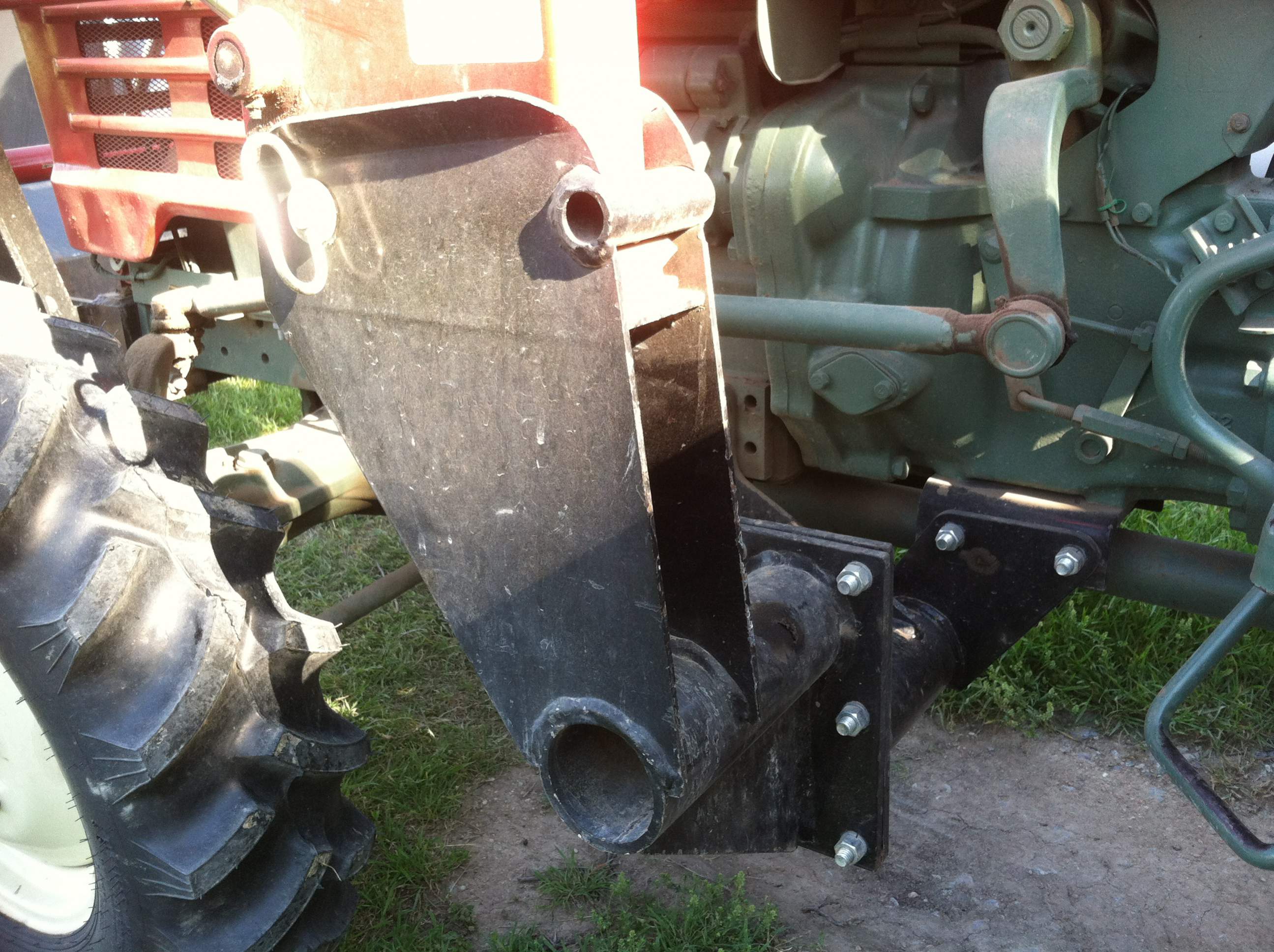

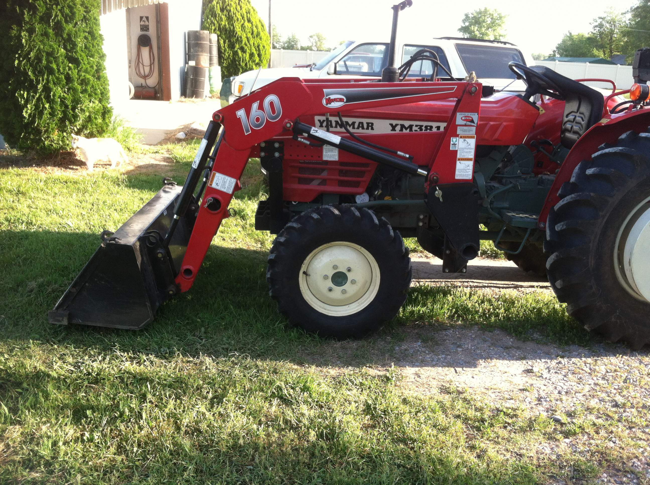

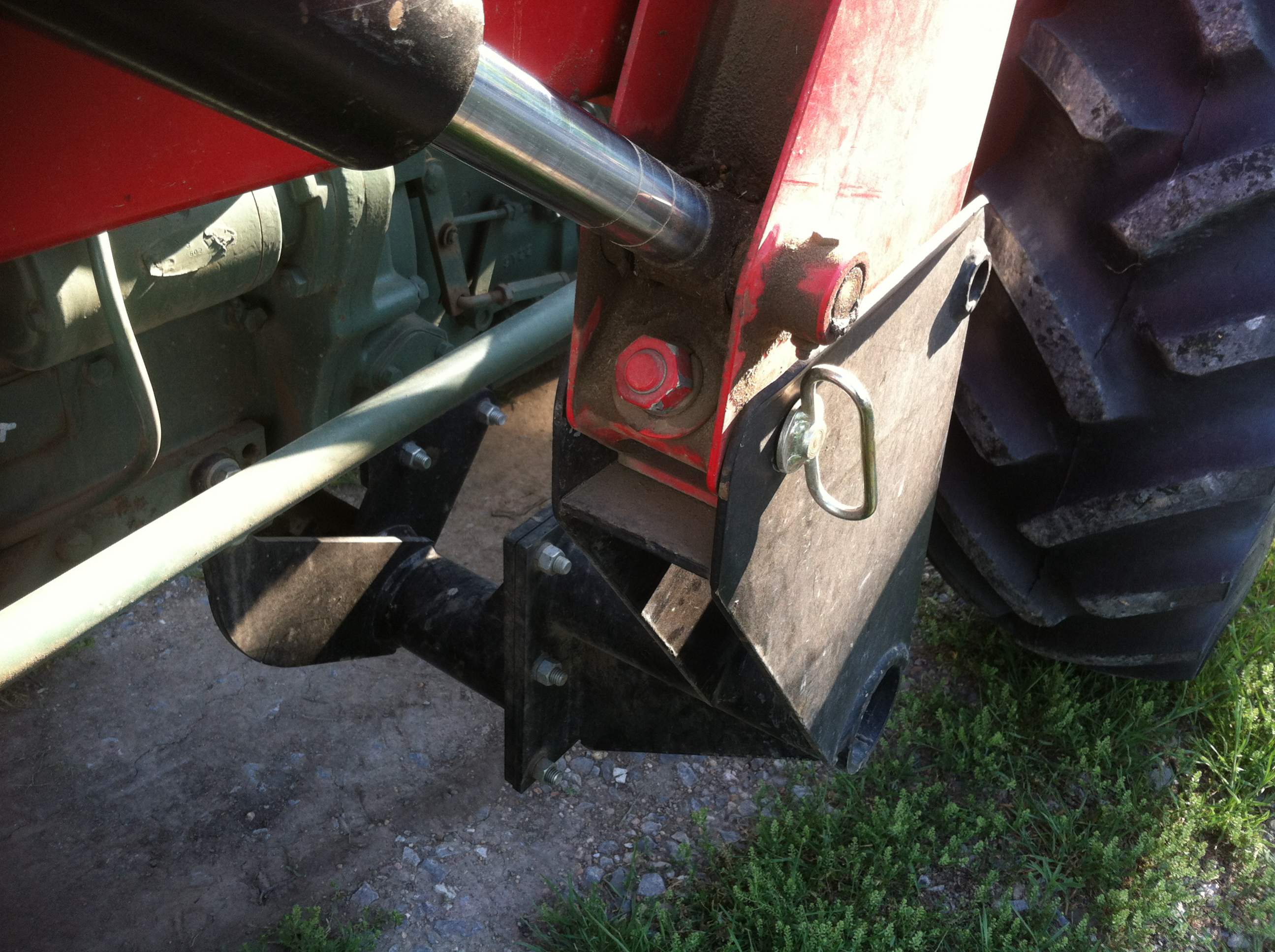

What's next you ask? Well, I have no idea how these loaders connect to this tractor, so if anyone can please post their 336 or similar FEL mounts I'd really appreciate it!
I have a bunch of photos of a 170 or something, but I'd much rather see how a frame attaches to this specific tractor series. I'd rather not break my frame after all of this effort :thumbsup:

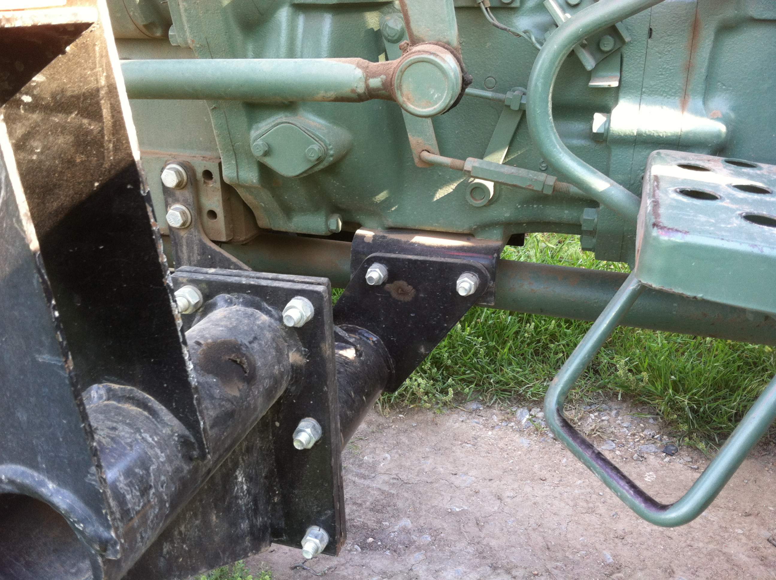

Well here is what I have for you in hi-res sorry TBN hth. :)
Just me thinking out loud here but the basic bracket is not that much steel.
I can only imagine it not being super expensive from Koyker but seem to remember the quick attach option being $100?
If that is these pieces that would be a bargain just saying...

After seeing the loader, you might consider leaving the lower arms as-is and finding a way to attach to the rear of the tractor. I believe they were attached to the under side of the rear axle on the ford they came off of. If the arms are close in length you might be able to fabricate the front brackets to hold the arms in place easier than cutting it up to fit the new style brackets.
Did you do some measuring to see where the unit ends up on the tractor ?DO a search for some pics of this loader on the early fords to see how the arms attach,its a strong loader and the arms to the rear axle are farily easy to attach,maybe just a plate under the axle ...

It looks like what I would do is set the loader and mount frame assembled together at about 16-20" say off the ground on boards or jack stands, hang it whatever, and drive the tractor into it and then start the design process from there.
The bucket can be replaced with about any 5' bucket I bet. fwtw my bucket I have off mine for other work has a mount bracket that is 45.5" on the outside of the loader arm and has a 2 7/8" opening and uses 1" pins.
I can see the rear end mount they had rigged up and that may or may not work if it does fit and is level with the rest hey its added strength id use it. :thumbsup:

From my own experience of building a loader an a FX24
From my own experience from building a loader for my FX24D, it is critical to keep the bucket as close to the front of the tractor as possible. Shorten the bucket arms and adjust the angle at the attachment points to the lift arms. Keeping the center of gravity close and the weight as close to the front axles will prolong their lives.
Don't forget to build it so it is easy to remove. Look at the newer FELs to see how they do it. Easier to mount/dismount the more flexible will be its use.

my loader mounts look much like those of CarDocs,I have not forgotten just been working too much and have not had chance to get some pics...................
More to follow..
