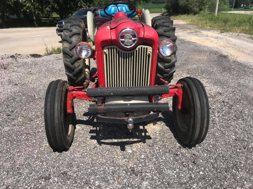

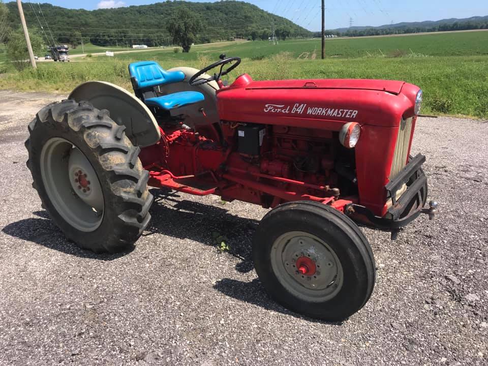

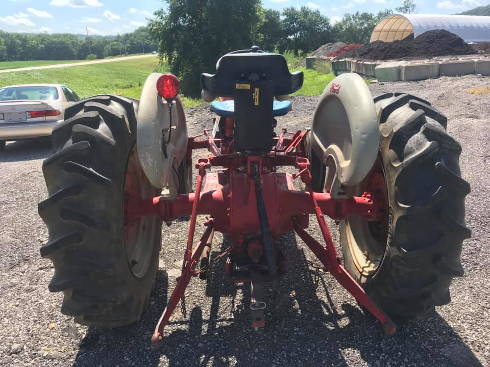

Here are a few more pictures. If I decide to move on the 641 then I plan on going out and confirming that a new battery fixes that slow start. If I do then I'll take more close ups of the fix of the front.
As to your question about my mechanical background. Zero! To this point in life I've been pretty good at teaching myself stuff by being resourceful (ie spend a lot of time on Youtube). However I've got zero experience working on these types of machines... was able to fix an issue with a cotter pin on my modern garden tractor! Standard maintenance... that's about it. That's why I've been hesitant to move on any of these old machines - every one I've gone out and seen has needed at least something fixed that I could see (meaning there's more that I don't see). If I could pay a premium to buy something in perfect condition then I would... but I think I'm fooling myself to think that it would mean I'd have no issues with a tractor this old.

I can't think of a better way to teach yourself mechanics than an old tractor. Reasonable prices for parts, simple construction, and you are rewarded with a better machine at the end.
You do want to avoid a couple of unfixable problems. Because the front axle damage might be one of those things, you should consider taking a mechanic along who does welding himself. You want him to look at the front axle repair. It may involve scraping off some paint. He needs to confirm for you that the repair to the front axle does not include any structural welding to the front axle support or to any of the cast iron parts. Damage to cast iron parts in front of that model is typical if someone tried to fit a front end loader onto the tractor. If so, consider either looking elsewhere or planning on a LOT of work to make it a dependable tractor.... and offer half the money at most.
Just about anything else you can deal with on any old tractor. Repairs to working systems are easy and inexpensive and kind of fun. But you cannot deal with broken and repaired cast iron parts. If it broke the front axle support it may have also broken the bell-housing casting. Look there as well.
You should also hook up some implement weighting at least 4 or 500 lbs to the 3pt hitch and lift it into the air. The 3pt control should raise and lower it smoothly and it should stay up by itself....or at the very worse, not fall more than a few inches in 5 minutes. If it doesn't pass that test, knock $1000 off the price and plan on teaching yourself about tractor hydraulics. That's the type of work you can do.
You mentioned that it turns over slowly. That's OK as long as it ultimately does start, runs, and idles well. If it turns over slowly that may well be an old battery or bad connections. So you should take your good battery along. But it could also simply be that their battery is good and the tractor's charging system is not adequately charging it, or that the starter is dragging due to old brushes and bushings. If those are the problems, your mechanic friend will know at once by looking at the ammeter. If it isn't charging, knock off about $400 and simply replace generator, starter, voltage regulator, battery, and the battery connectors. That's simple and fairly typical old tractor maintenance work. Once you understand those parts better you won't have to replace them, you can rebuild most of those in one evening for $100 and pocket the change. (or buy more tools!)

The front axle mount on a 641 is steel, not cast. I have welded a few of them, and I have had zero problems after years of service. If the rad was taken out by the axle, something had to of let loose in a catastrophic fashion such that it shouldn't be difficult to find evidence of a repair. I'd pay close attention to how the main pivot pin goes into the front support. The front support may have an over-sized / worn out hole that caused the pin to come out.
At the listed price, this kind of stuff should be fixed and fixed properly. If they were asking 1500, then that would be a different story.
   / Ford Jubilee vs 641 - First Tractor! #17
Are you sure the front axle was worked on? When they said they had to work on the front end and replace the radiator, they might mean the bumper guard was crushed into the grill and radiator. They obviously rebuilt the bumper and replaced the grill in front of the radiator. A slow crank is normal for the old 6 volt systems, and they really need bright and tight connections. All of them. That was the best advice I got when I bought my 850 many years ago. After cleaning all connections, using a wire brush to shine them up and then reinstalling nice and snug, I got better starting performance.

Just got clarification from the seller - her husband ("has been a tech for 40 years") and son did the fix. When asked if the front axle was repaired or if it was just the bumper & grill, their response was "it was the pivot pin that's on the front axle and the mount that the pin goes into".
They also shared the contact information for the local mechanic they've been using to do the rest of the work on the tractor over the past year. I plan on giving him a call to pick his brain, and hopefully adding him to my speed dial!
So it sounds like I need to confirm two things before pulling the trigger on the 641:
1) Take a good battery out there and see if it fixes the slow start. If it doesn't, then there's likely a charging issue (look at ammeter), and knock off ~$400 of the asking price to afford replacing generator, starter, etc.
2) Look closely at the fix to the front end / front axle. Get an idea of what was replaced or fixed using welding (sounds like there's some debate of what's acceptable). I'll post some pictures later on with what I see.

It's sounding better and better. I'm particularly glad to hear Strum456 say that the front axle support is steel; not cast iron. The other thing you want to do is check the 3pt lift. You will be using it a lot, and if it lifts and lowers nicely and stays up with a few hundred pounds of mower on it then that also lets you know that the hydraulics are OK. It would be appropriate to check that the PTO turns the mower. If someone hasn't added some sort of OVER-RUNNING or slip clutch to the PTO driveshaft, you need to add that part. It is now standard on all tractors but was not back in the 50s.
A gasoline engine that cranks over lazy doesn't bother me as long as it runs & idles basically OK. Electrical problems are easy to put right on these older tractors.Tuning is simple.
