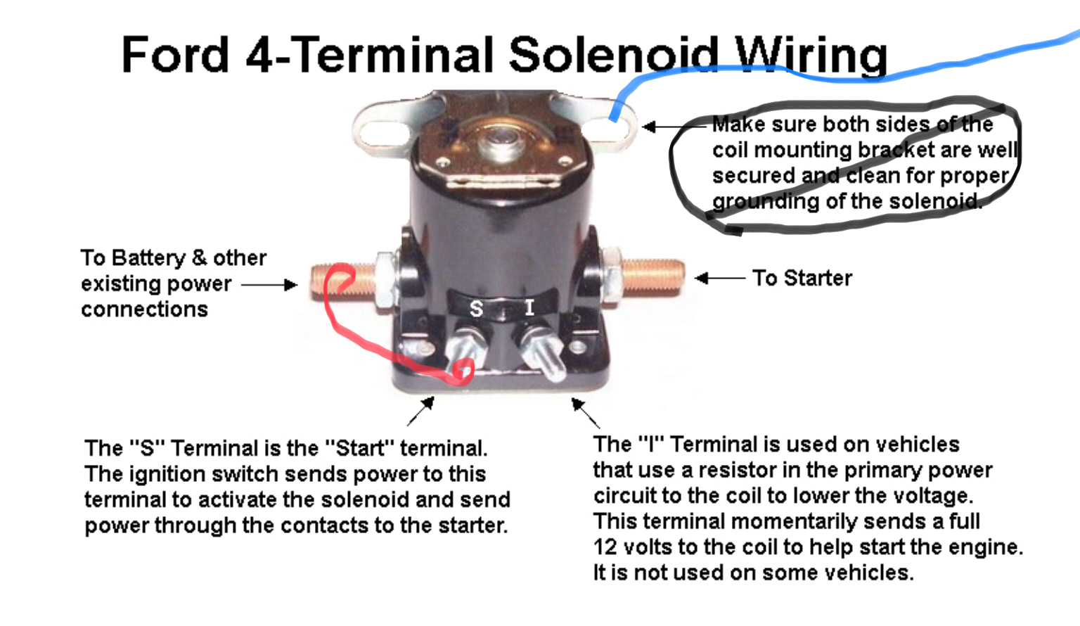

They sell push button starter switches at the auto parts stores. I've had a dozen of those tractors. Never had one wired factory correct. Never wanted one wired factory correct. The push button by the gear shift is a neutral safety, so it's a good thing if it works. Sounds like your RUN wire is in with the START circuit somewhere. Wire from START on key switch should run to solenoid. That should be the only small wire on the solenoid besides the two battery supply wires from battery and to starter. There is an S and I studs on the Ford type solenoids. Sounds like someone got on the I post to hot the points when in START, but when it's on RUN, it back feeds and keeps solenoid engaged. Run a wire from START to the distributor, and run another from RUN to distributor. I put a ballast resistor on the RUN wire. That way it starts on full 12 V but runs on a reduced voltage. I do it because it starts good and the points last longer.

You are right the automotive solenoids have the small post grounded so you apply voltage to it to engage the solenoid. The N tractors solenoid, the small post has voltage applied to it internally from the battery cable and you supply the ground with the push button on the transmission.

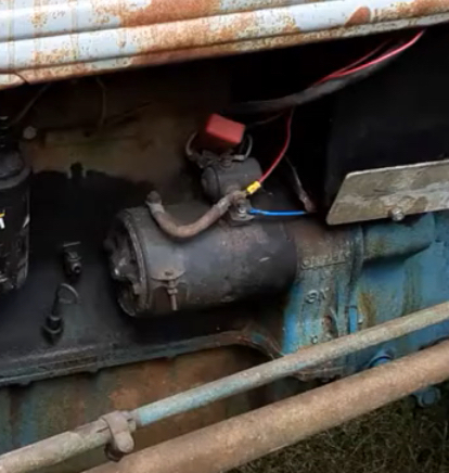

I did read somewhere where automotive solenoids operate differently than tractor solenoids .... I don't remember exactly how they were different
The issue is with most Ford car and truck solenoids are activated by application of 12 volts because the case is already grounded via mounting it to something that is itself grounded.
That said, I have still used them and activate them via the grounding 8n push button. The key is you can’t mount it to anything conductive. This one is mounted to a non conductive spacer.
Now, the wire where One would normally send 12 volts to to crank is connected directly to 12 volts (red) and the isolated case is wired to the push button (blue). I also like to connect the “I” connection to the coil, by passing the resistor.
It’s actually a built in trouble shooter. If it fires (runs) while the button is pushed and dies when you let go, you have an ignition switch or resistor problem and not an issue with points/distributor.
