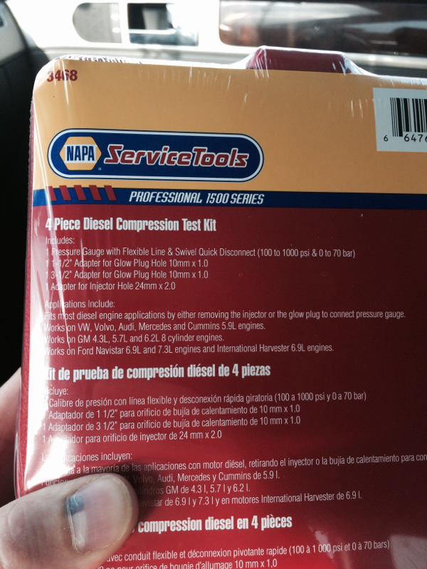

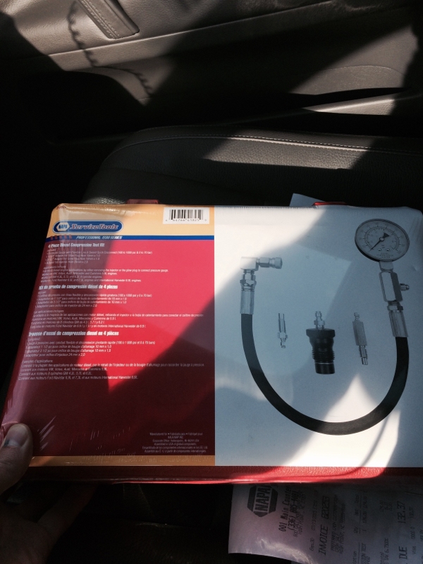

Will this work to check compression? If so how do I use it? I'm assuming remove 1 injector at a time with the fuel turned off and turn her over is part of the equation???

it's the right type of gauge ( diesel vs gas ).
whether it fits your injector hole or not, I can't say. RickB will probably know, maybee Ultradog. They work on more diesels than I do / have more experience with the later tractors.

Yeah that's my worry. Maybe there is a adapter that can be used if not. If anyone knows please let me know. Thank you
