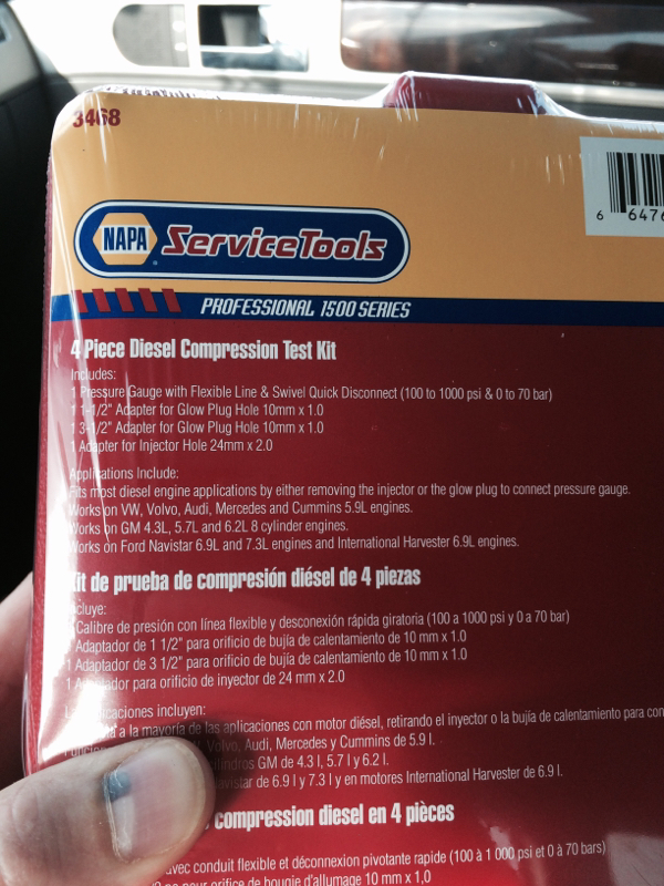

111549.jpg The Napa kit will get you the basics, but you'll need the adapter in the middle pictured in the following kit.95279.jpg Toolsource #: 95279 Manufacturers #: 34800 Also known as:
SGT-34800. Can't find similar in Napa, but both are online at Toolsource.

Awesome. Thank you very much.
   / Ford 4610 engine slight miss?
#13
I have it on order now and look forward to giving it a try. Really think I have a burnt valve or other issue as power seems down recently. The strange part is that in cold weather it still cranks almost instantly.
