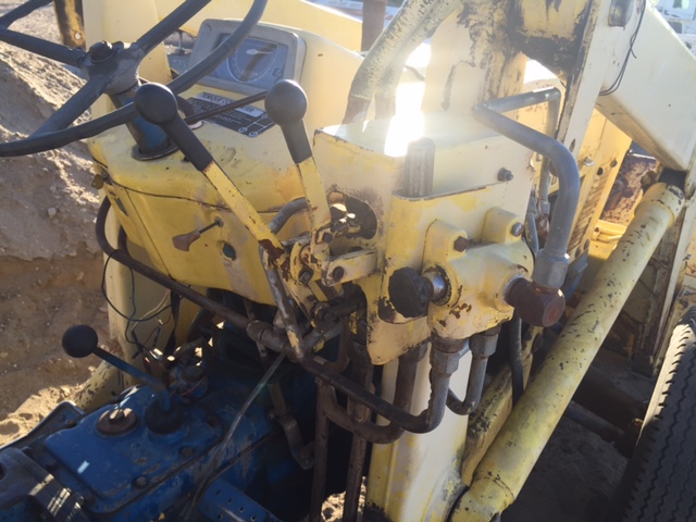

Hello.... Looking for some help and guidance. I recently picked up a Ford 4500 TLB and it was working fine. No issues but now it makes a lot of noise raising and lowering front bucket. Now the front tilt moves by itself. If you set the bucket level and raise the bucket, the tilt will automatically move down like to dump. There is a valve next to the front control levelers, I would say a hydraulic bypass. The knob can be either pulled out or pushed in. I have no idea what it is for. I checked the functions with button pushed and pulled, no difference.
I checked the hydraulic fluid which was two gallons low and I topped it off but no change in the front bucket operation. The backhoe controls and function appear to work fine, no issues that I can tell.
Does the hydraulic pump appear to be failing? Could it be a filter problem? Could the front tilt valve be failing?
Thank you in advance for any help...
Hec

Any pictures of this "button"?
Almost sounds like the loader valve may have a self leveling feature. In that when raising the loader, the bucket "dumps" to maintain a level position relative to where it was when started. Think like pallet forks. If you clamped pallet forks on, and had them flat on the ground, then raised all the way, normally by the time you get to full height, the pallet forks would be pointing about straight up. A self leveling valve would keep the forks level to the ground.
No idea if thats what the button is for....just speculating.
/ Ford 4500 TLB
/ Ford 4500 TLB #9
Hard to tell just what it is, dads 4500 looks nothing like that.
Where do the three lines go/come from? Maybe that will help figure out just what that knob is supposed to do
/ Ford 4500 TLB #11
Certainly looks like a 4500 TLB. I was refering to the valve and plumbing that his looks nothing like yours, and doesnt have that black knob.
Any idea where those three lines go/come from?
/ Ford 4500 TLB
#14
the bypass valve goes to the raise and lower bucket cylinders. it has nothing to do with bucket tilt...
/ Ford 4500 TLB #15
So I assume that is the two lines coming off the bottom of that "bypass"? they look like they are tee'd in with something else. Where is the line coming from / going to out the top.
Without a better pictures, or you sketching a diagram where all those lines are going, I am at a loss. Maybe someone else is gonna be familiar?
/ Ford 4500 TLB
#18
the supply comes from the reservoir hydraulic tank, both hoses attach to lift bucket cylinders. Another thing that I noticed is that it is hard to turn. It does not turn easy at all..
Thanks again for ALL the help!!! Much appreciation...
/ Ford 4500 TLB #19
I currently have 2 4500TLB's and sold and worked with 3 others and none of them had any kind of valve like that on them. I am curious to learn what the purpose of it is. I will stay tuned to see what it is.
/ Ford 4500 TLB #20
that's a diverter valve it is a manual 3-way 2 position selector valve. This valve will allow one pump source to supply two circuits. Pulling the spool out diverts oil to port nearest handle, pushing the spool in diverts oil to the port away from the handle. My 345C has one as the backhoe was added later, so the diverter was added to the lift circuit of the loader to power the bachhoe. It could have been used to power many things.
