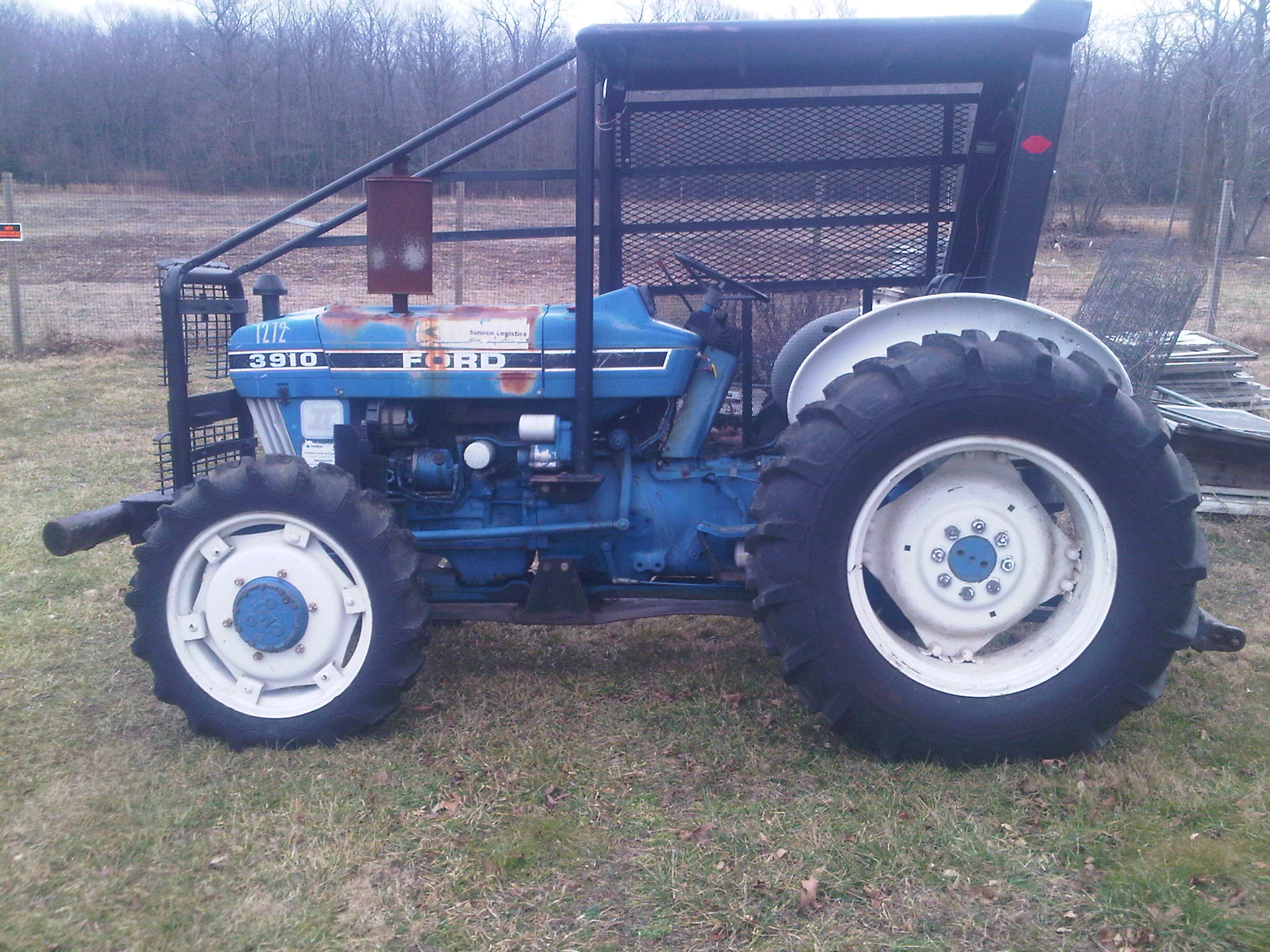

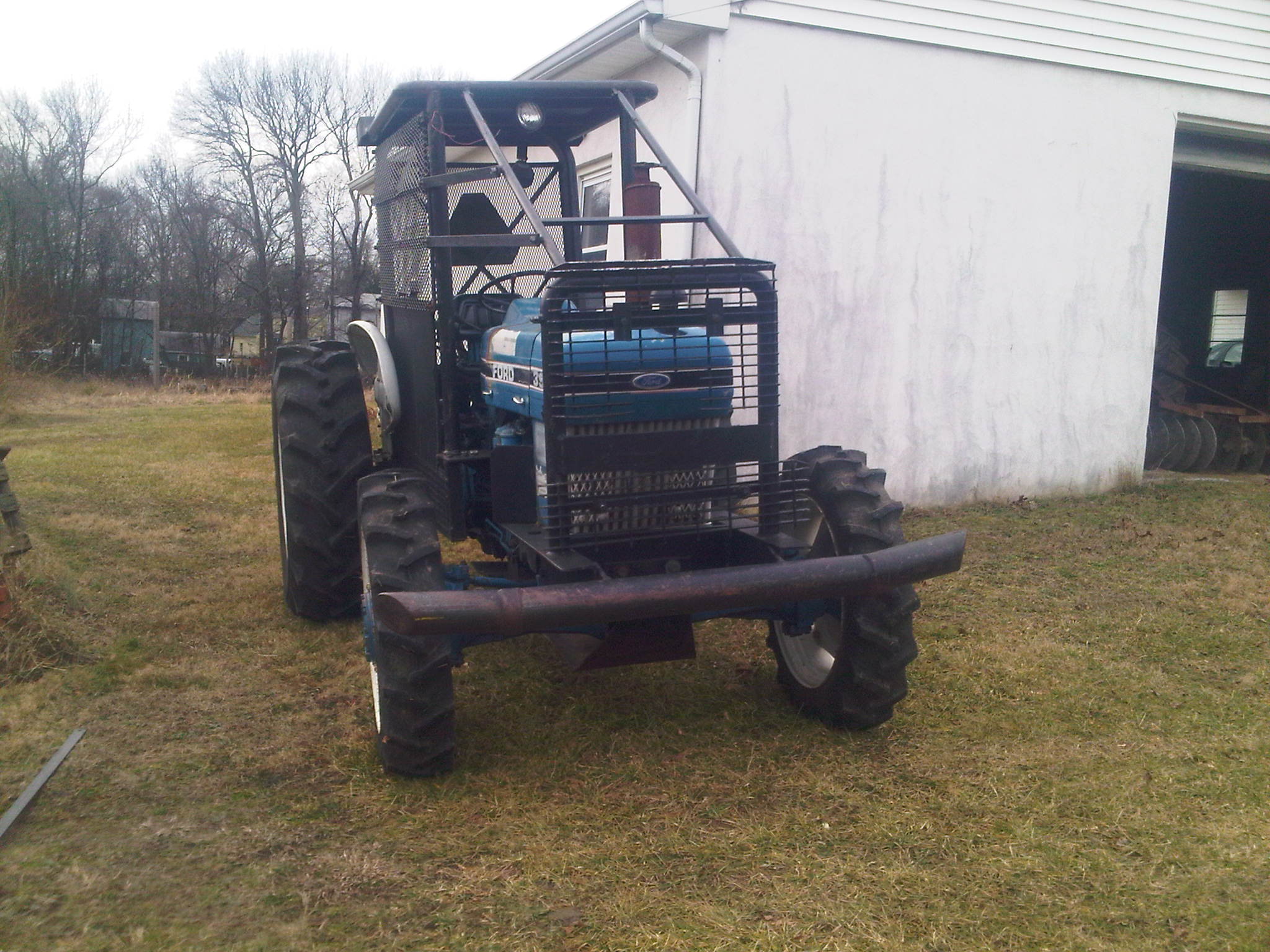

I have a FWD Ford 3910 that had a full protection system built. I have removed it all and would be happy to sell it to someone that could use it. The front bumper can be mounted by itself and is great to protect the tractor. The tractor was used by the Sun Oil Pipeline group to brush hog right-of-ways and the cage was for brush protection.
View attachment 408418View attachment 408419View attachment 408420
Robert, you are the man I've been looking for!!!! I saw your pics in reviews but couldn't figure out how to get ahold of you.
I need a favor. Big favor. I need to know what size rear tires/wheels you are running??? I'm assuming 14.9x28?? I appreciate any response you can give me. My tractor has had the rears swapped out to 38". It pushes the front more than it should with that tall of tire combination.

Richard, The tires on the back are 14.9x28 and the front tires are 9.5x24. You can see the size on the tire if you zoom into the attached picture:
There is also data on the standard tires that were available on the 3910's when they were new, you can look it up at TractorData.com Ford 3910 tractor information
Here are the tires listed on the site, my sizes are highlighted in red:
